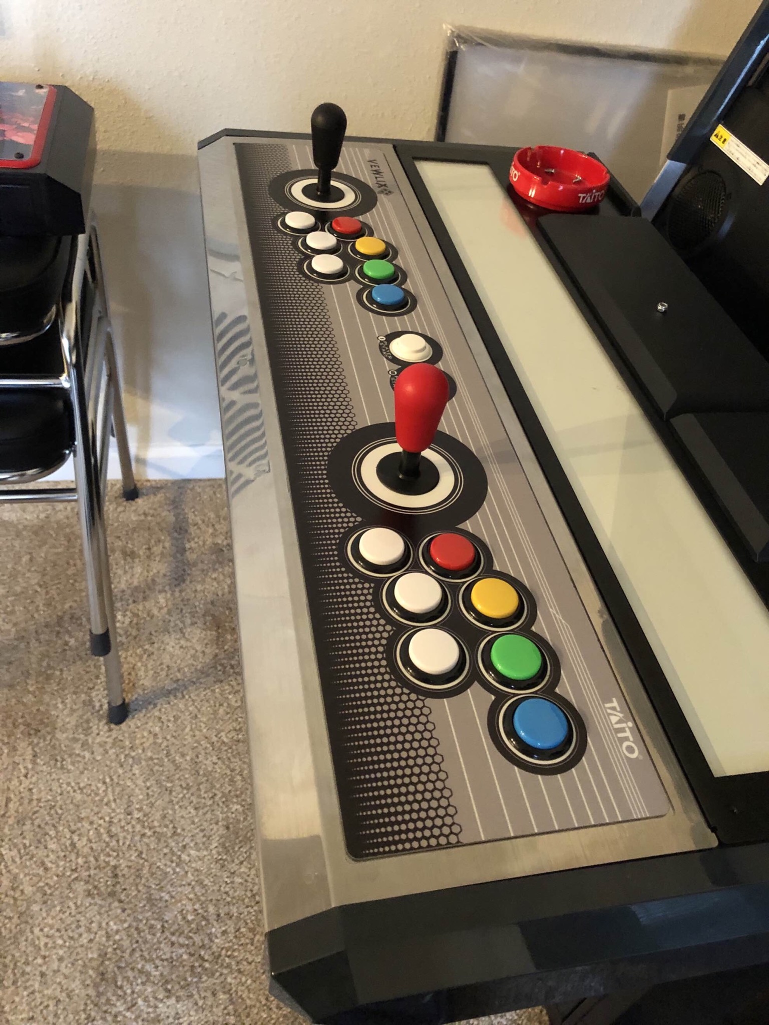

Yeah - that would be no re-mapping at all?Question so i cant play like my set up?
Button D the blue one is a mirror of button 4
so for me is red(A)- Button 1, Yellow(B) - button 2, Green(C) - Button 3 and Blue (D) - button 4

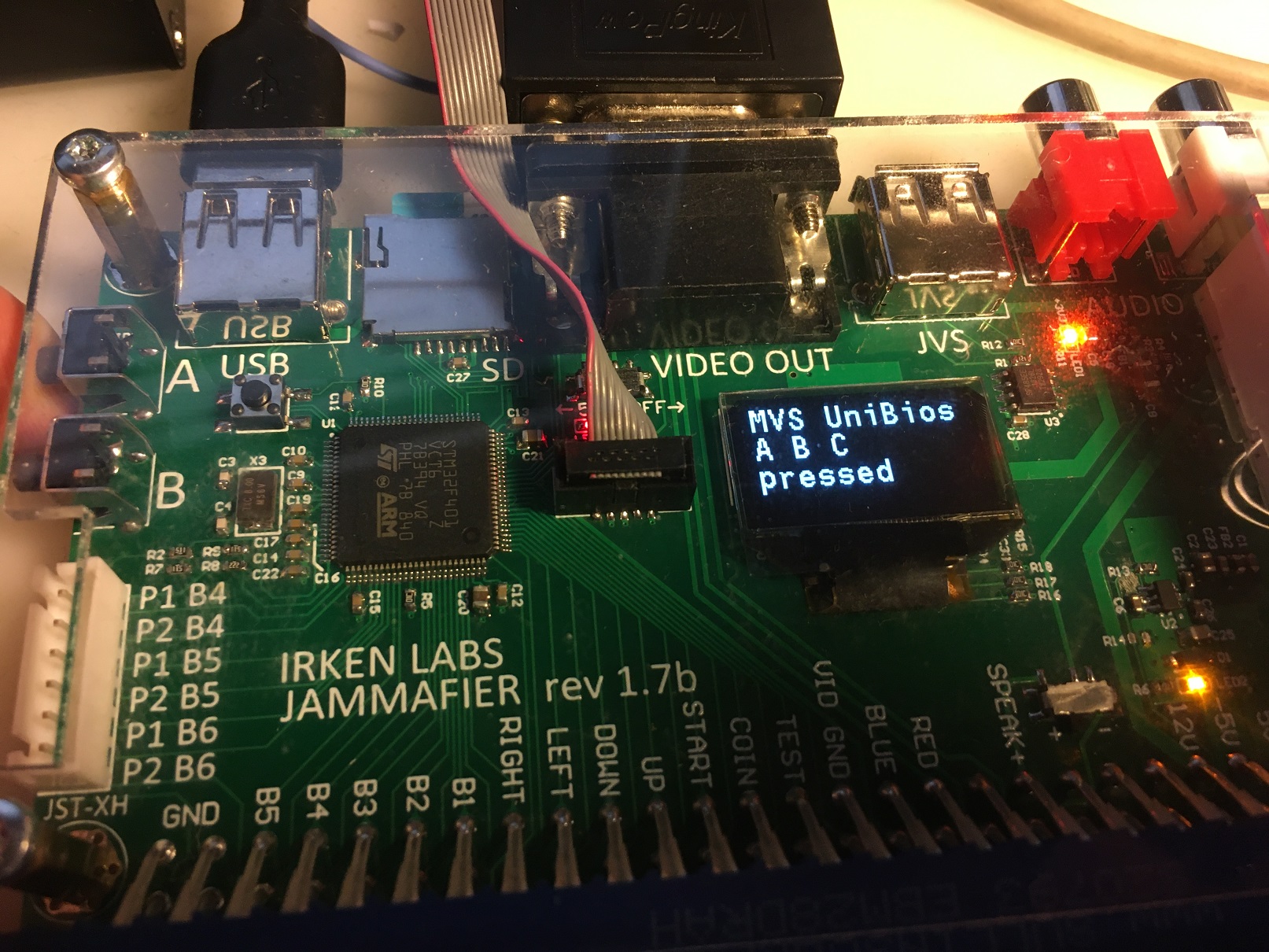

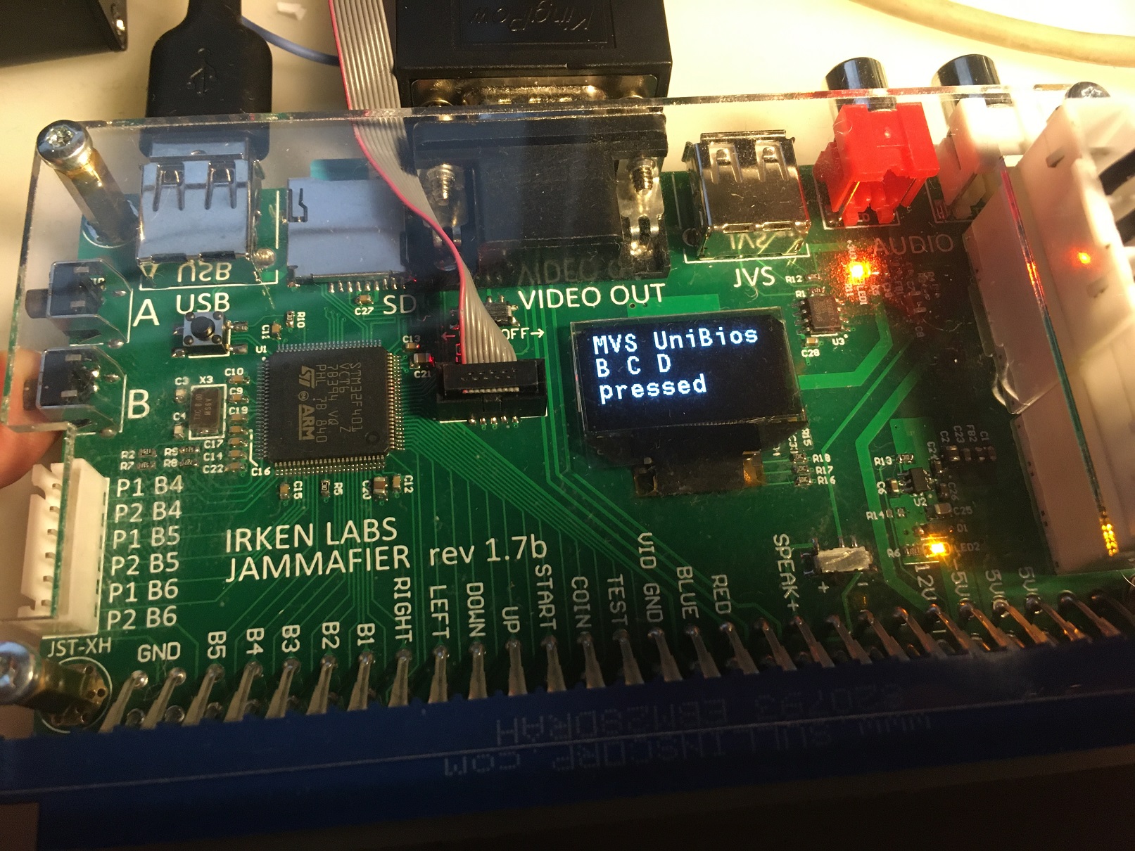

In the course of trouble-shooting my MV1A I installed the excellent universal bios - http://unibios.free.fr/. Turned out my problem was that dip switch 1 was set
Anyho - to access the bios menu you need to hold ABC or BCD for hw test at boot - so I implemented this. If you hold A or B button on powerup this happens:
