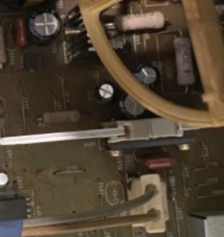

incase anyone needs to know this is basically the block of caps your looking at for vertical. Around the vertical IC.
There is also a red mylar cap in front of the output Ic may be out of spec (odd for a mylar but I have seen it)

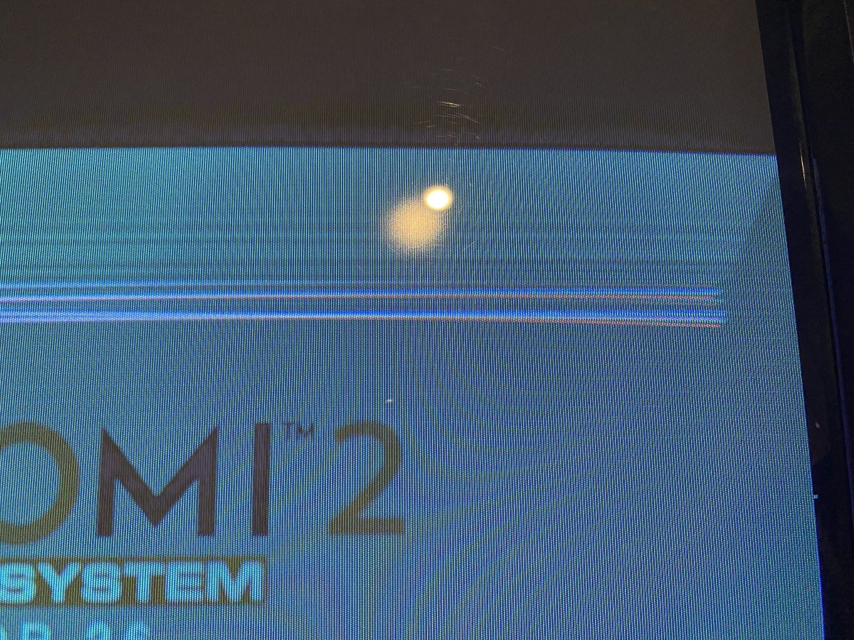

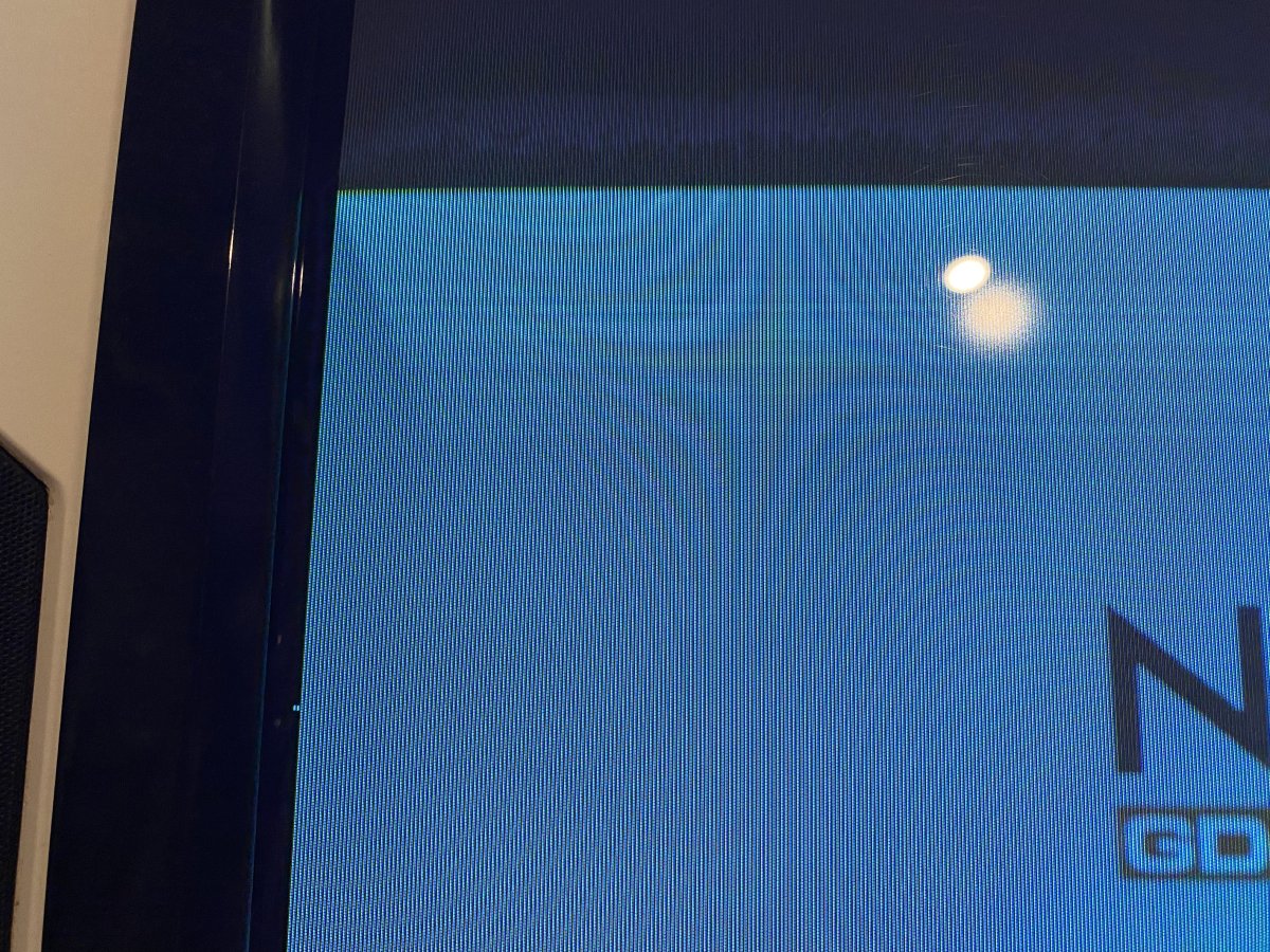

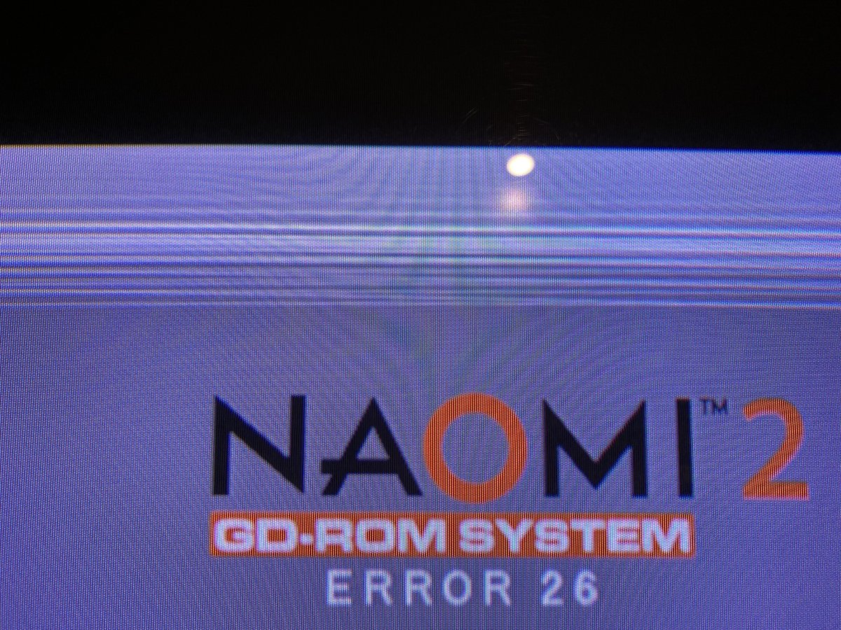

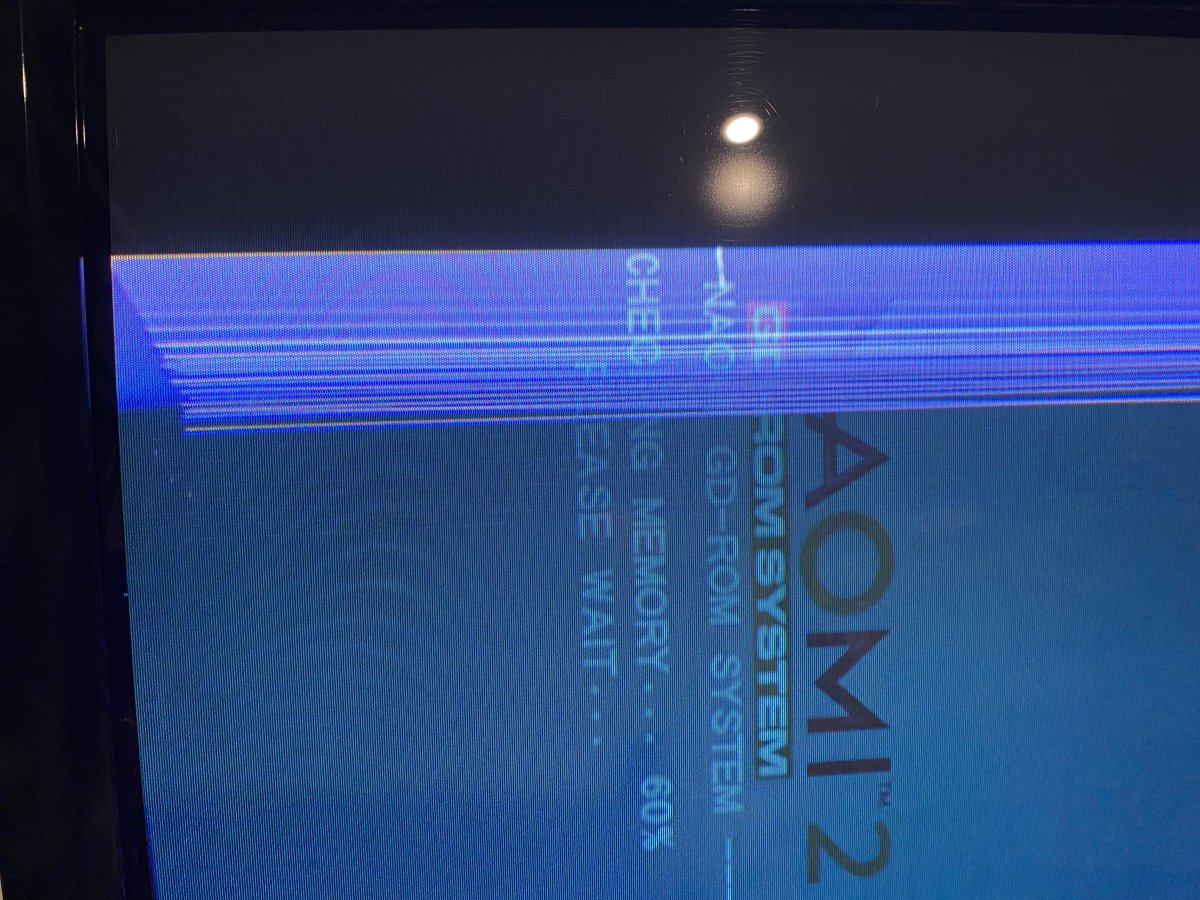

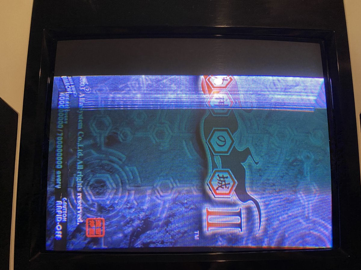

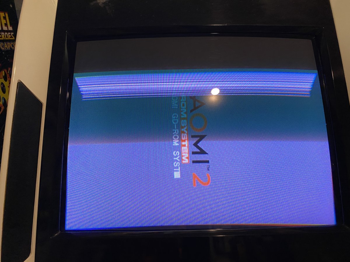

Unfortunately, after a couple months, my monitor is starting to curl. It only happens after about 10 minutes of playing. It only happens on 31khz. I’ve yet to test the 15khz mode. But if I reset it, it will be fine until it’s on for another 10 minutes.
I will reach out to John again at PNL, but was wondering if this is a cap that I can fix? Apparently, John replaced EVERY cap on the chassis.

With what you've spent and will continue to spend sending this off to John, I'd recommend getting a working chasiss at this point. Don't wanna risk that chassis failing and taking out the tube. Then you'll have a nice paper weight Blast unless you have a spare tube, access to a spare tube off a game or a D9200 handy.
I agree send it back for an inspection again. This is having to do with vertical drive circuits in some capacity. Usually its a capacitor that causes curl but could be a passive could be the actual IC.
I wouldnt worry about the tube being taken out from this. This doesnt look like a HV issue. The reason the tubes die on these is if the flyback is failing and shorts theres a CHANCE that the shutdown circuit doesnt catch the short and shut down fast enough. The HV ramps up too high and it arcs internally into the gun of the tube. Killing the tube and the heat usually cracks the neck.
Rare occurance but it deals with failing flybacks and HV not geo deflection circuits.
However I also would not really continue to run it like that for longer than needed to test stuff because it could be stressing other parts out in the drive deflection or drive.
I went back to John and he pulled the flyback and chassis from my monitor. He's gonna work on it for a few weeks. I'll keep you posted.

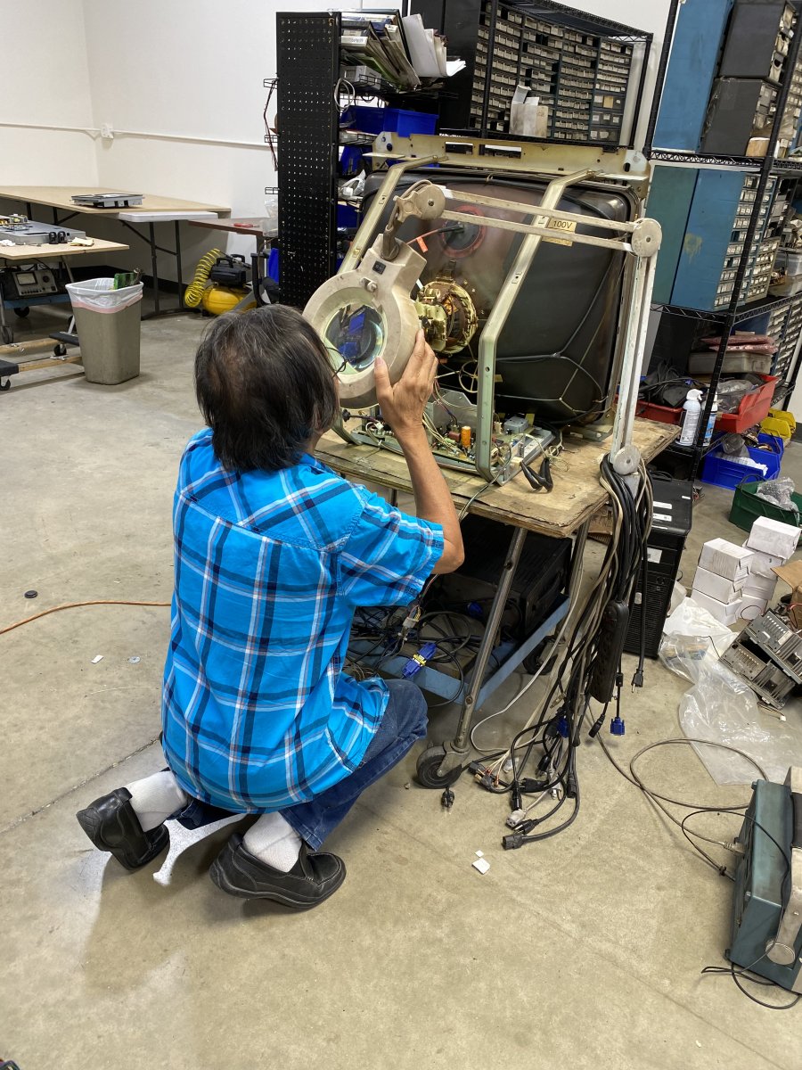

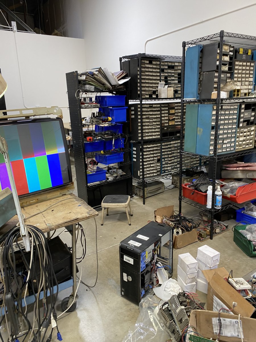

John was able to do a bunch of extensive testing as it kept randomly vertical folding due to temperature. He was able to fix the chassis and do overnight tests to make sure the folding stopped. He also did some preemptive repair work on the flyback. All with no extra charges!
He did so much work and spent a lot of time, I offered to do some web marketing for him in return.
Due to his place being burned down, he had to move to a new location. However, he didn’t know how to update his information online (google, yelp, pnlvideo.com).
It took some time to get his accounts verified, but now his site and online address are now updated!
He’s now repairing monitors for fun as he’s pretty much retired. Try to visit in person if you have the chance before he leaves the business for good.

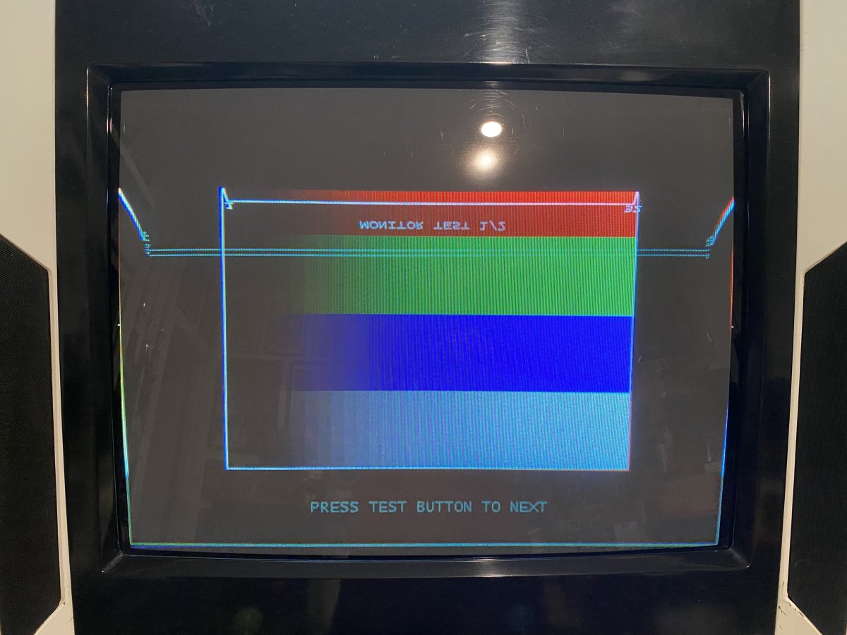

Just got this back again from John at PNL. Ran a 24 hour test and it’s pretty stable now. No vertical folding!

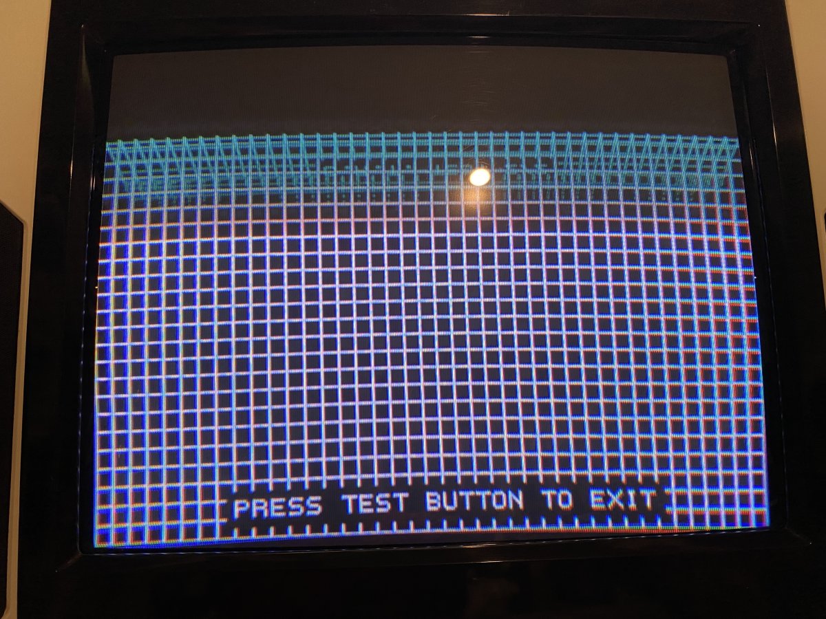

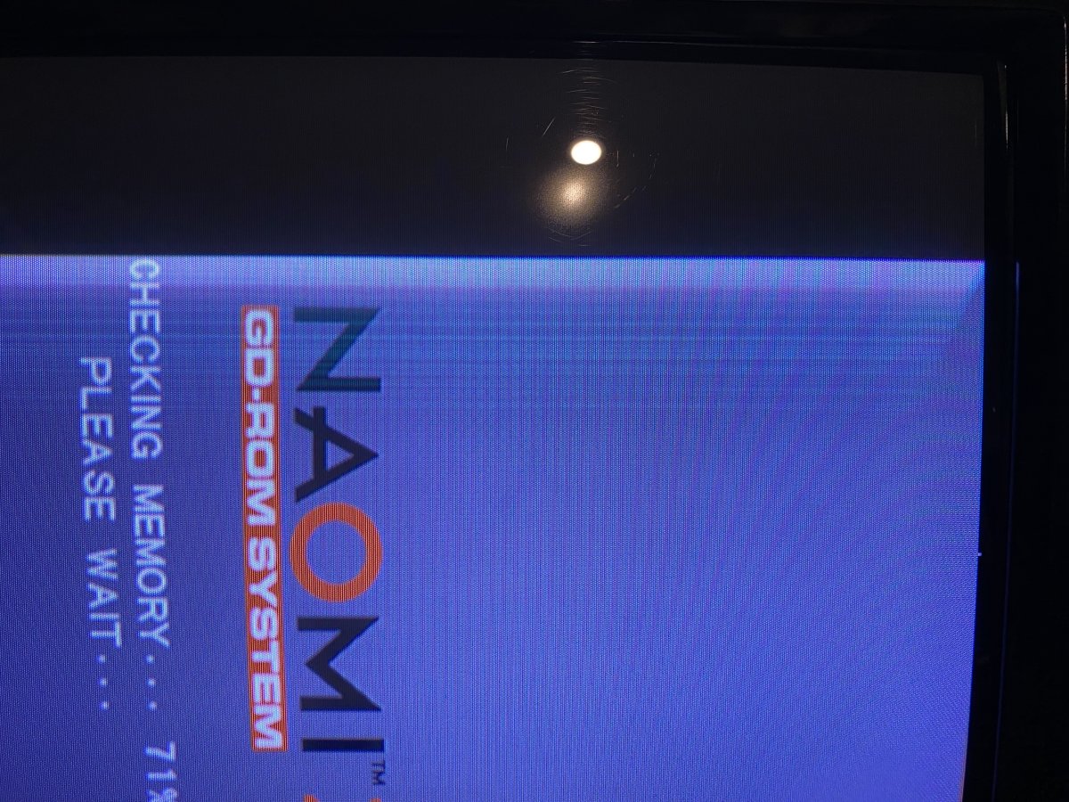

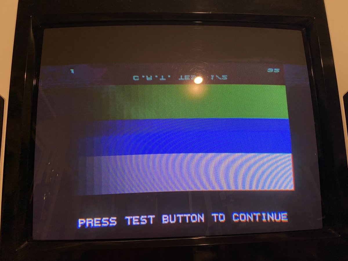

So when I got it back in October, it was running fine for a couple days. Unfortunately, it folded again after running the machine for about 2 hours:
It would fix itself after a restart but come back eventually and exponentially. Next time it came back was an hour, followed by 15 min, then as soon as it turned on.
At first he thought there wasn’t anything wrong since it played fine when he received it. However, when he ran it for about 4 hours, it started to fold.
We originally thought it was temperature based as it was a bit colder now and it took some time for the issue to show up. He reviewed IC LA 7846 with the oscilloscope on the chassis and that was the issue. He replaced it and ran the monitor for 8 hours straight with no folding.
Hopefully, this will last for many years to come. Now, onto the other monitor…
