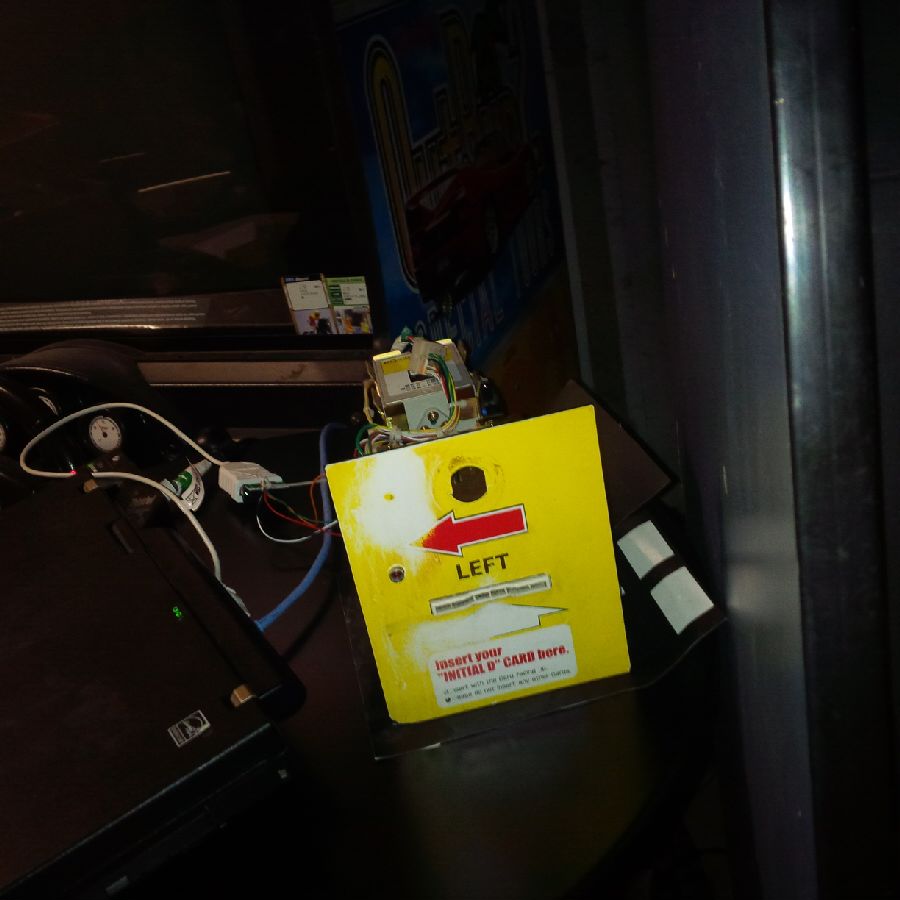

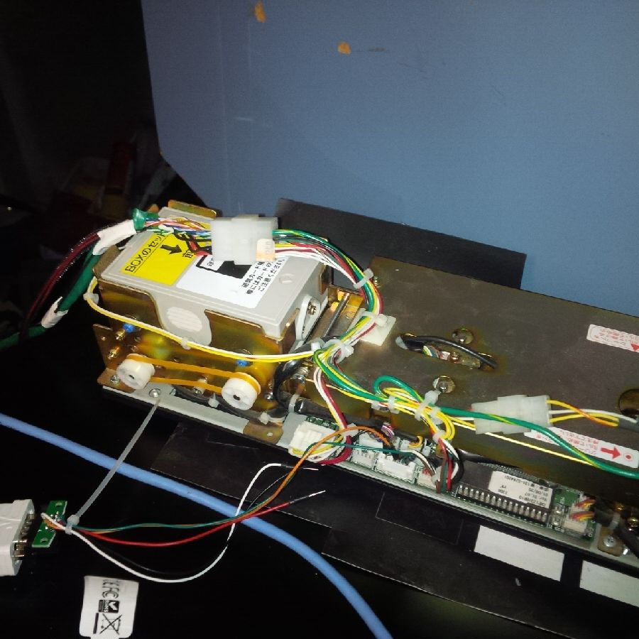

For those of us that like visuals, do you have a quick and dirty image of your wired setup? NAOMI2 (CN2) <-> ID3 Card Reader (CN8).
I'll see if I can get something together.

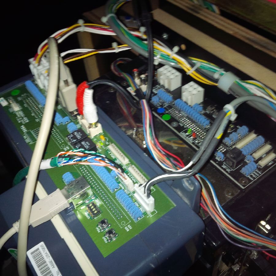

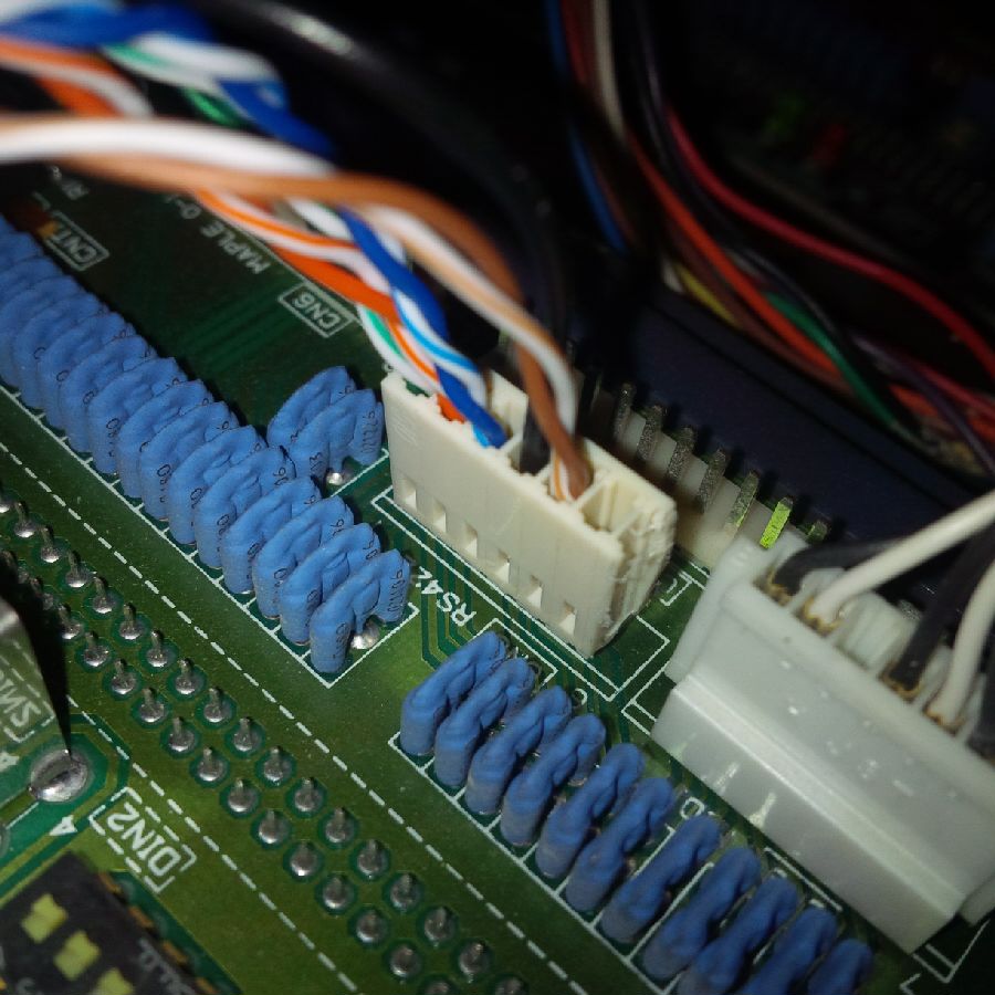

It's NAOMI2 (CN8 - Labeled as RS422) to ID3 Card Reader (CN2 - Not sure if labeled, but it's the 8-pin connector with 5 wires in it)

I received my 2nd adapter and have both ports wired up to sniff each side of the communication.
So far my biggest impediment to progress seems to be getting some software set up that will allow reading in from 2 ports simultaneously. I don't want to put any money into purchasing the full version of 232Analyzer (or pirate it), so I'm looking into alternatives.
