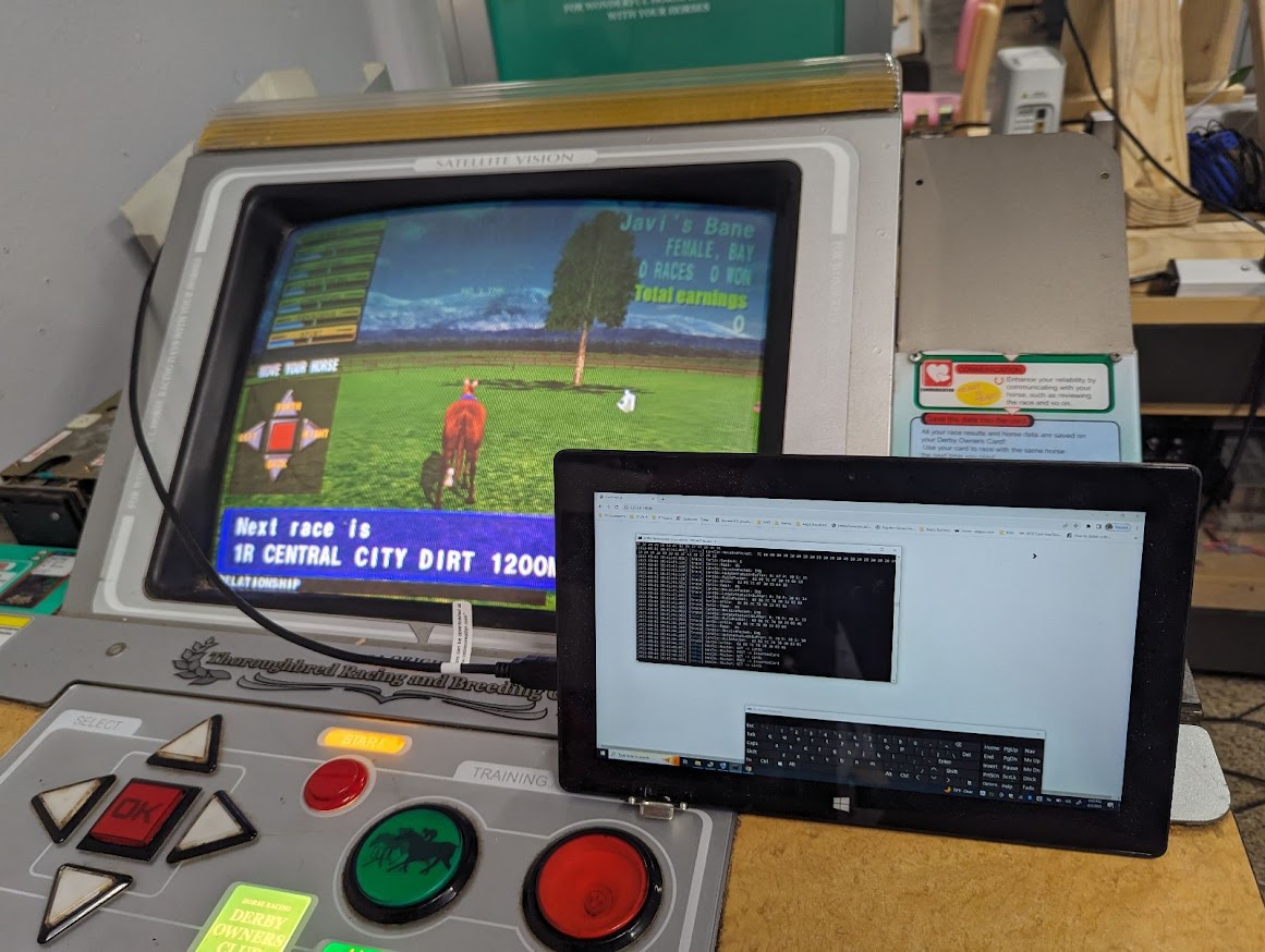

I got it running last night & my PIN's arrived today from digikey, so I can confirm the WiFiPi - YACardEmu ran flawlessly for 3-4 hours. I set it up on ports 8080/8081 & used a different port for each side.
I needed to bump up the partition size for the 3rd party libraries which took a while (big!) but otherwise it's relatively plug-and-play w/your documentation.

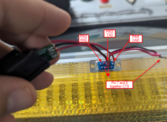

Computer -> USB to RS232 ->RS422 ->Naomi
I bought this: https://www.amazon.com/dp/B075YGKFC1?ref=ppx_yo2ov_dt_b_product_details&th=1
USB RS232 Pin out
Notes you only need 3 wires | CTS/RTS Bridged | You will have to modify a cable|
Pin 2 RXD
Pin 3 TXD
Pin 5 GND
**Pin 7 CTS Wire this together with pin 8
Pin 8 RTS Wire this together with pin 7
It should look like this:
Plug it into the RS232 Board Male DB9 Port.

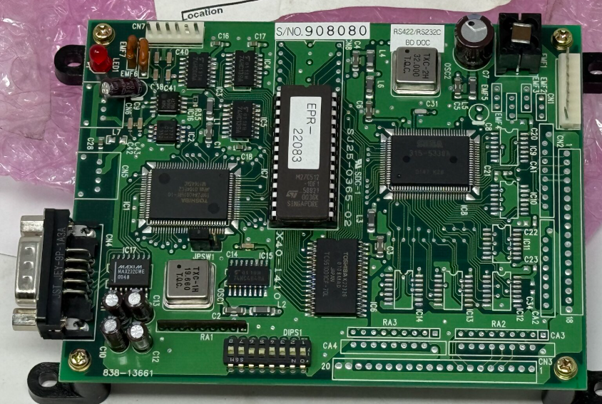

You will need the Sega Serial Conversion PCB #838-13661. I'll just call this 'Serial PCB'. This may change in the future as the protocol has been reverse engineered and so may be added to the emulator in the future.
This info MAY work for Virtual-On Force and other games that use this PCB.
Here's a picture of it.

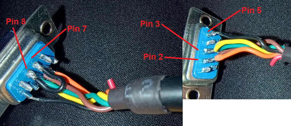

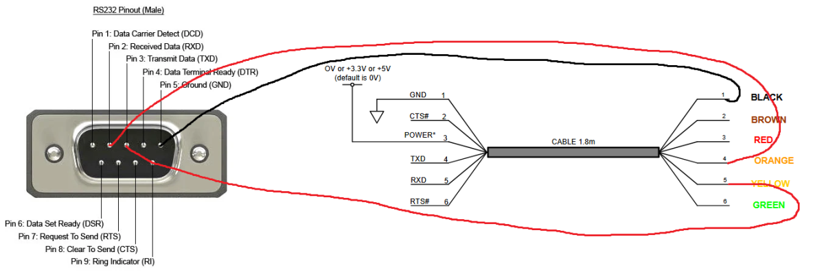

1. Connecting to CN4 with a USB.
1a.
You will need a USB - RS232 cable, preferably one with an FTDI chip or similar. You can get pre-stripped ready-to-solder cables; I got this one. Parts # is USB-RS232-WE-1800-BT_0.0 <-- MAKE SURE you get the one with '0.0' on the end otherwise you will be sending 3.3v/5v down the red wire (usually a ground). Use the datasheet that comes with your cable (or just make sure you know the pinouts).
1b.
Get yourself a female 9-pin serial. I brought this as it was cheaper than a single serial port from RS/Digikey and came with a bunch of extras and some plastic shells to make it look neat.
1c.
Wire it up; takes 5 minutes with a soldering iron. If you don't have one I suppose you can use heat-shrink to keep the wires in place against the contacts. DON'T do what I did and wire transmit into transmit and receive into receive. It won't work and you'll have a massive headache trying to figure out why it won't work. This wiring diagram image ONLY applies to the cable I linked above; so again make sure you know your USB pinouts or use the datasheet for your cable to correctly apply the information here to your specific setup.
Pin 2 on Serial (Receive) - Transmit on USB
Pin 3 on Serial (Transmit) - Receive on USB
Pin 5 on Serial (Ground) - Ground on USB
Pin 7 (Request to send) & Pin 8 (Clear to send) will need to be connected with a jumper. Do this on the serial port itself, not on the USB side.

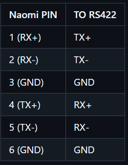

2. Connecting CN7 on the Serial PCB to CN8 on the Naomi.
2a.
You will need two JST-NH 6-pin connectors and pins. I used 28 AWG wire and it works fine. The SegaRetro.org US manual for DOC is wrong. Please trust me on this.
These are the pinouts, by Bobby Dilley.
Text guide:
Pin 1 on Naomi - Pin 1 on Serial PCB
Pin 2 on Naomi - Pin 2 on Serial PCB
Pin 3 on Naomi - Pin 3 on Serial PCB
Pin 4 on Naomi - Pin 6 on Serial PCB (US Manual messed up here, as it has Pin 4 to Pin 4 which grounds the TX+.)
Pin 5 on Naomi - Pin 5 on Serial PCB
Pin 6 on Naomi - Pin 4 on Serial PCB (US Manual messed up here, as it has Pin 6 to Pin 6 which grounds the RXD+.)
