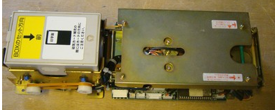

Since I will be the first to admit that this is well above my pay grade, maybe a picture or two will help communicate what I was hoping to achieve. I’ll give that a go… Maybe then someone can guide me in the right direction.
Software: 232Analyzer - full version - it should handle two way communication (or so it says) logging, as well as at some point allow me to simulate the signal of the equipment from the PC going either way.
Hardware: Naomi 1
Hardware: Sega RS422/RS232C BD DOC part number 838-13661
Hardware: Sanwa CRP-1231BR-10
Some cable that allows plugging into multiple ports
In my horribly inadequate brain, I was hoping to just connect that cable in between the connections, and the software would just magically show the communication back and forth. I thought I read somewhere in this thread that the RS422/RS232C board was just a transparent interface board.

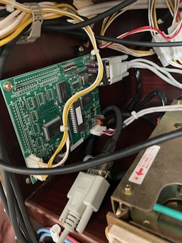

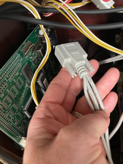

I started by just adding that fancy cable and connecting it directly into the RS422/RS232 board like so.
Whatever it was reading and logging was coming from the card reader to the RS422/RS232C board. <- I believed that to be half the equation?
I have an open end of the cable currently, that I was hoping to create the cable that connected directly the Naomi (other half of the equation) to read the communication from the Naomi to the card reader. That was my wanting to connect from CN7 to this open serial spot on this cable.
For the sake of this, I was hoping to just add the cable (which has a final end that goes directly into the serial port on my PC) into the connection chain and the PC would log the communication back and forth.
So that was my (incorrect or oversimplified) theory on how just extend the connections by adding that multiport cable in order to track the communication both ways.
Though now that I have typed this all out, I kind of see why it doesn't really make sense...
I will make sure that the settings on the software are correct, and then try to figure out how to go back the other way...

If the cardreader is rs232 you should be able to remove the cable directly connected to the cardreader and insert the tap there.
If there is an official wiring diagram that would help :)
Yeah, I thought that was the one I was tapping into, but maybe not…😅
Let me see if I can map it out better. Whatever I did (lengthening the wire or otherwise) the game doesn’t throw a card reader connection error yet, so something is being said in there somewhere. 😂
I’ve got to try to mirror what winteriscoming did before and stop trying to do my own thing I think

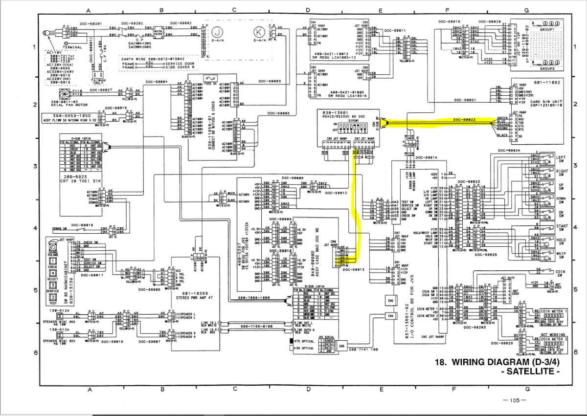

So this how it is normally wired up

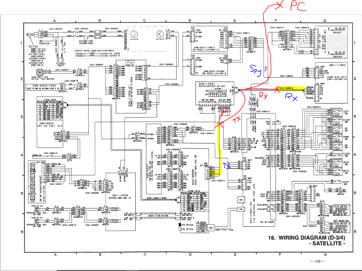

I was trying to tap into what I assumed was the transmission coming from CN8 on the Naomi to the RS422/RS232 Board (TX) and what I assumed was the receiving signal from the Card R/W Unit (RX). I think I incorrectly assumed that they were uni-directional signals. So I was trying to tap into both sides and then feed both of them back into my PC and through the software to log the handoffs.
But what I may be understanding now from the comments is that the TX and the RX happen bi-directionally between the 422/232 board and the card reader? So really my only focus is what is highlighted below?

As on outside observer, it looked like you were trying to monitor the RS422 side for TX and the RS232 side for RX. With RS422 being a differential signals and RS232 being a single ended signal - I am thinking this would present some challenges to capturing the communication.
Yup, that’s exactly what I was trying to do, and as I was mapping it out I was like, yeah no wonder that won’t work.
