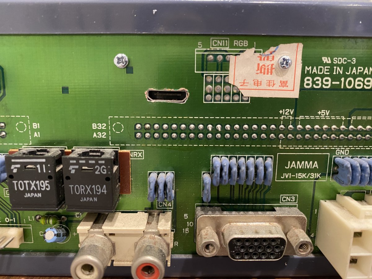

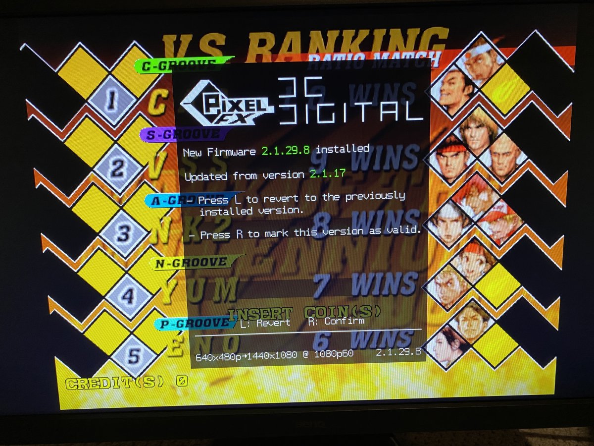

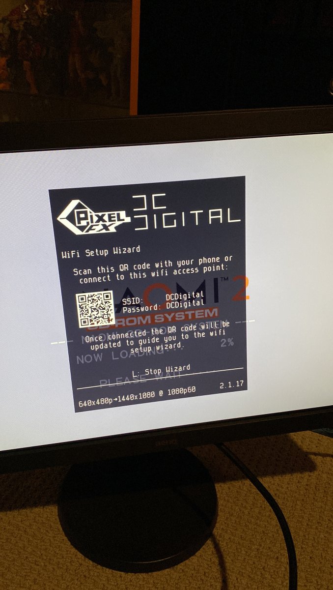

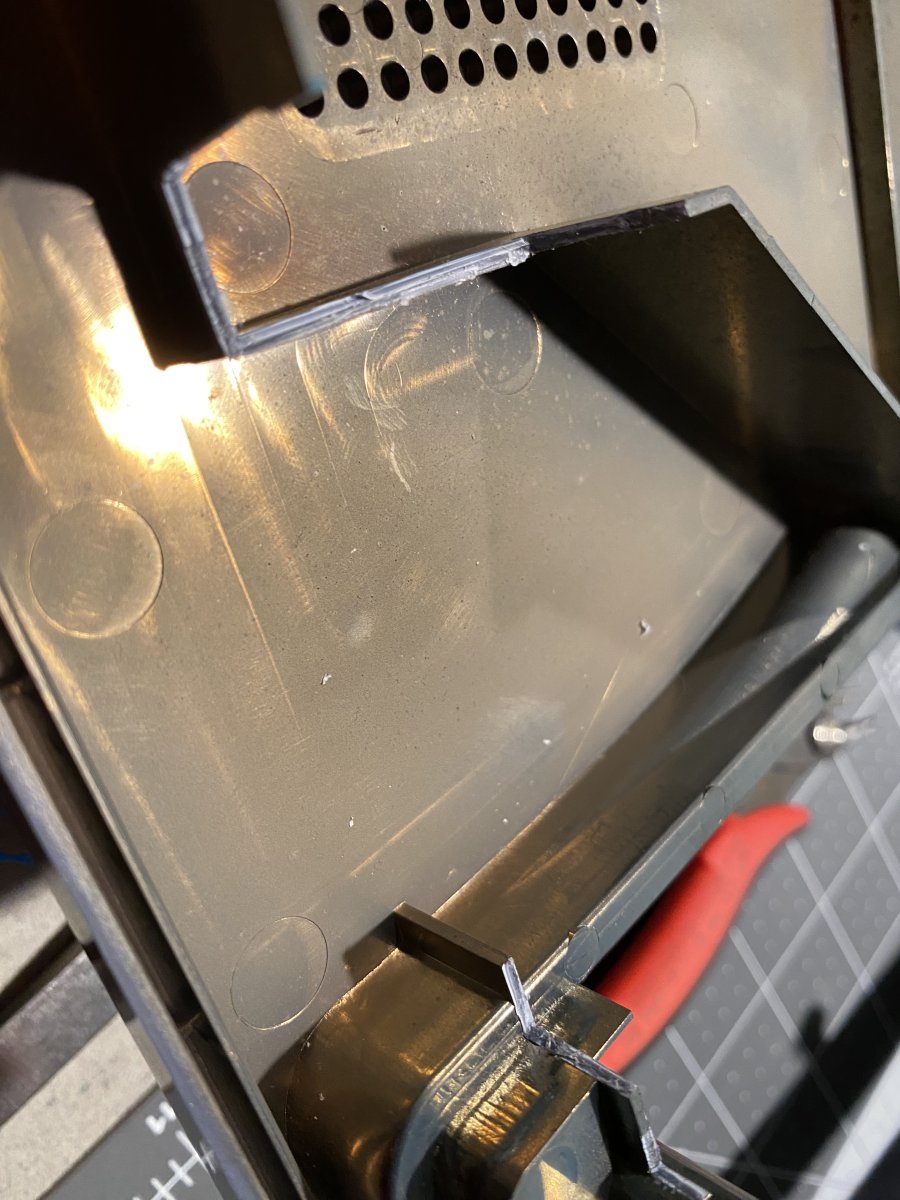

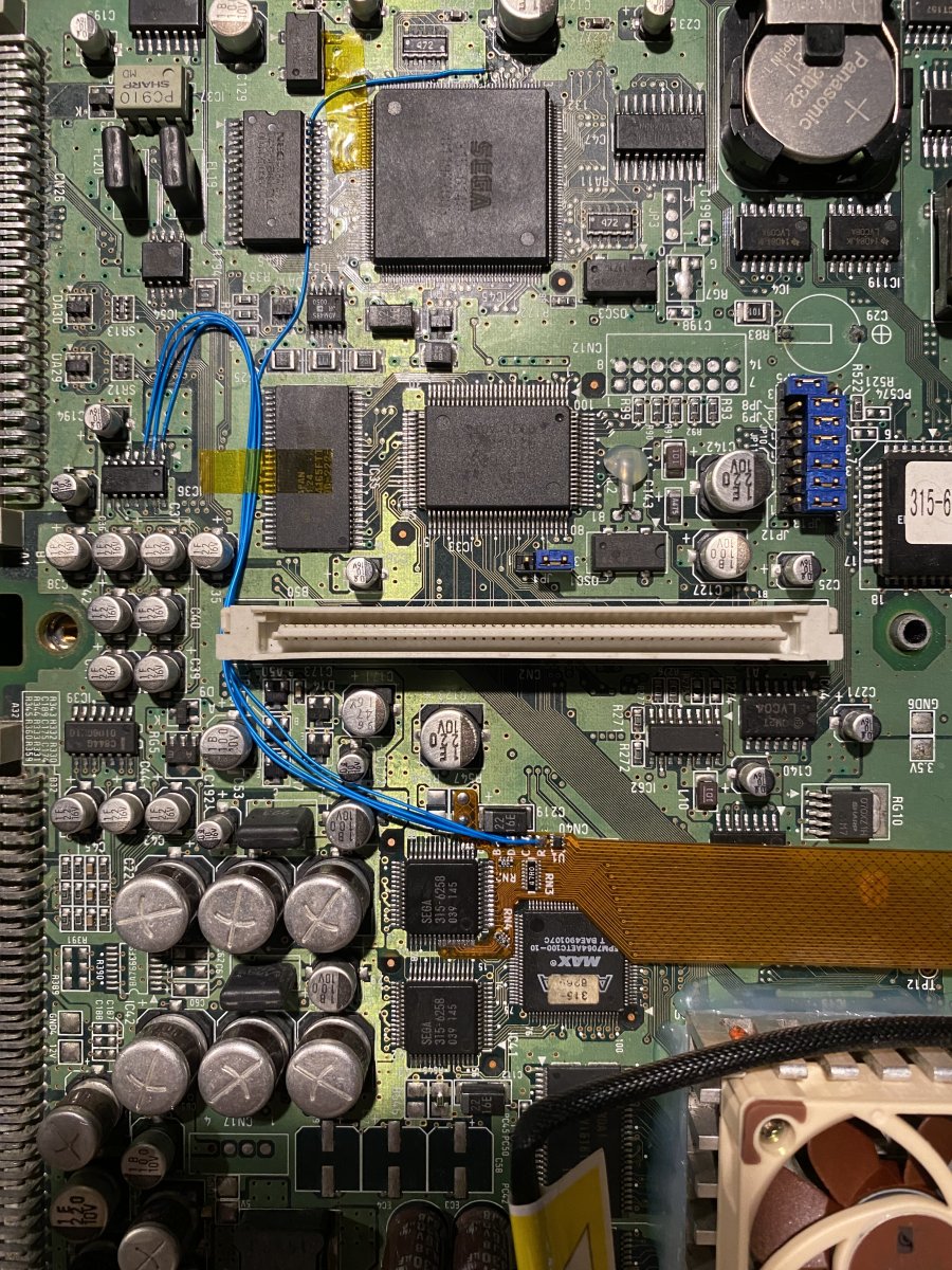

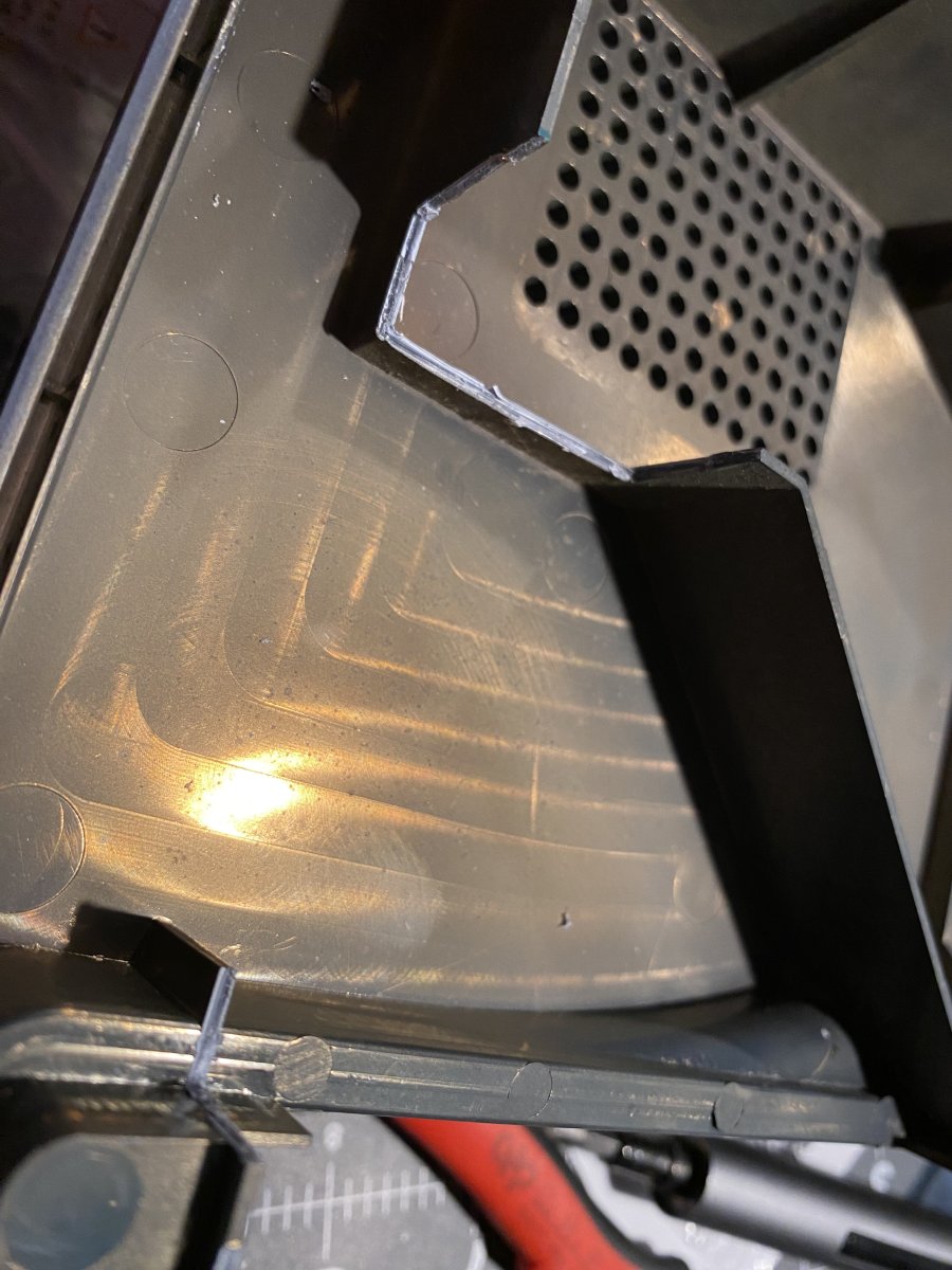

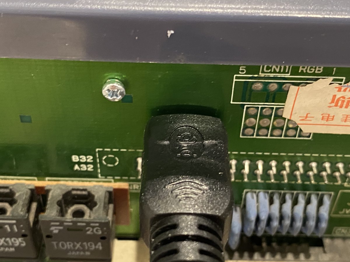

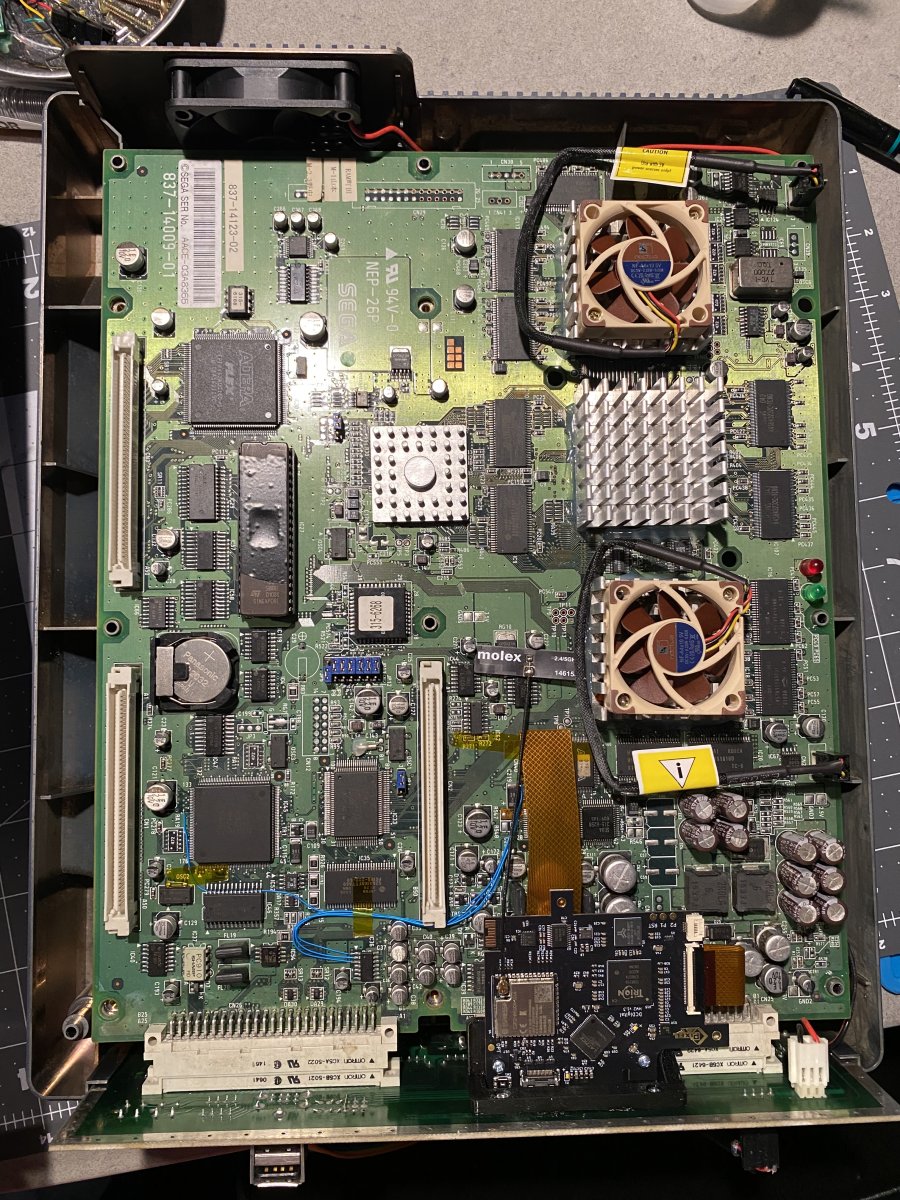

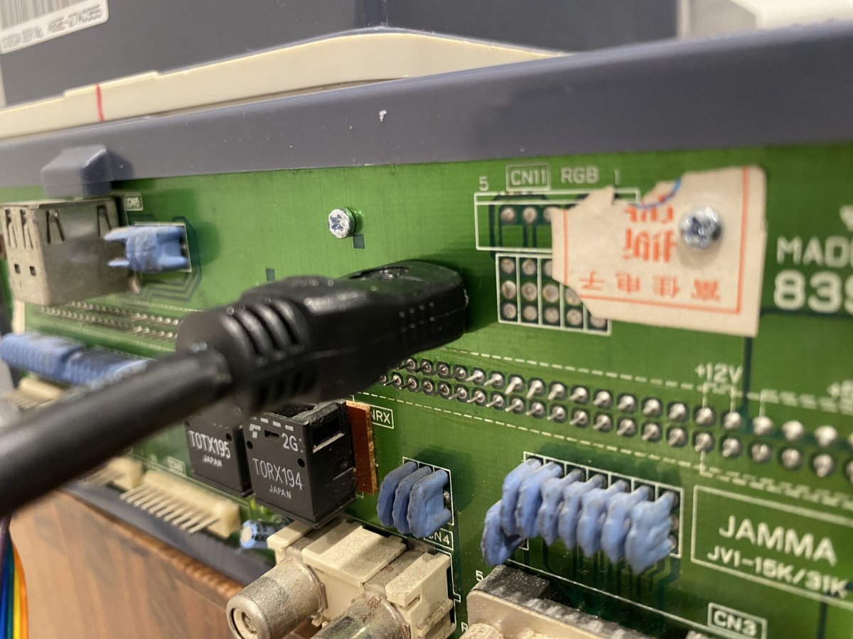

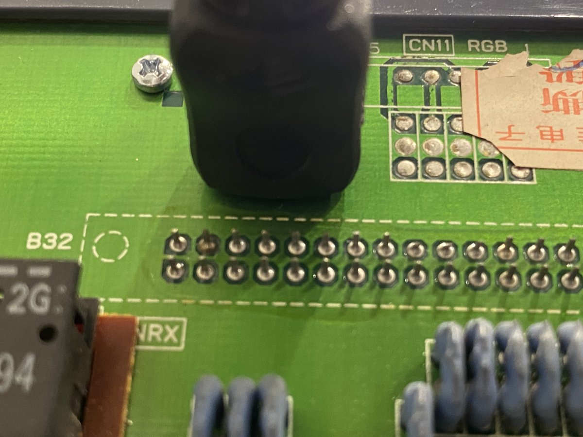

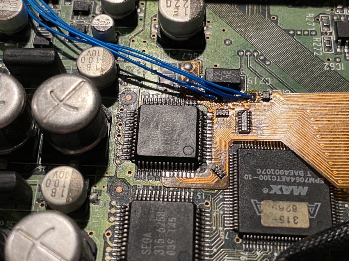

Hopefully, most of you can try installing it yourself as it’s a great way to practice your soldering and modification skills.
It’s a fairly straightforward and simple install. Not hard but very tedious.
If you have any questions, let me know here.
EDIT: don’t use the mini hdmi adapter as it will damage the plug applying more pressure than it should. Use a dedicated mini hdmi to hdmi cable instead.
