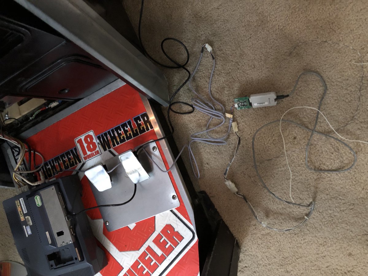

I finally got Route 66 booted in my 18 Wheeler cab. I've got the mitsu Maple adapter, so I will check out the Microphone functionality soon and let you know if ti works. I just got the Dreamcast Microphone today in the mail.

No dice out of either port. The CB-MIC RECOGNITION screen had no sense of input from the Mic.
I wonder if they send PWM values down the mic port. I'll have to track down a picture of the original microphone...

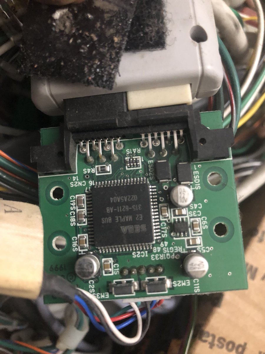

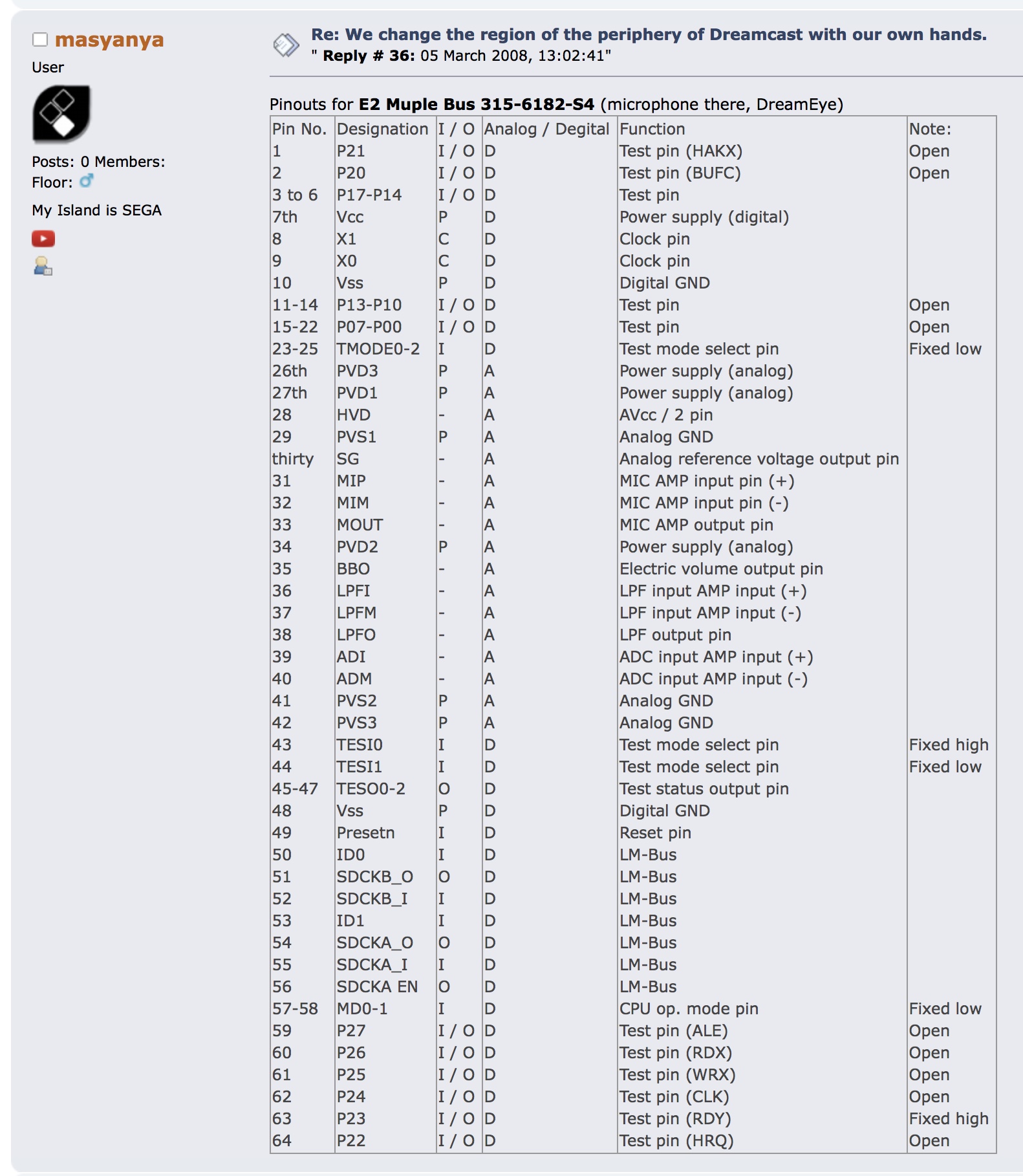

I'm sure this is already *known*, but inside the mic adapter you find an S4 Maple Bus 315-6183 chip
http://www.emu-land.net/forum/index.php/topic,14300.msg213618.html

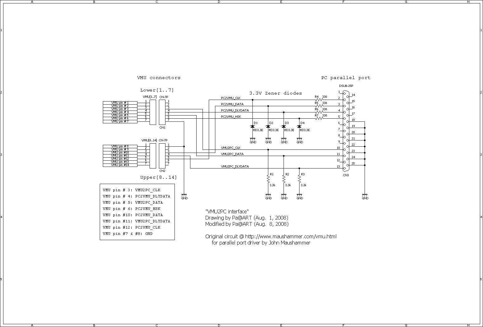

Pinouts attached below:
The actual VMU port pinouts are here:
https://web.archive.org/web/20070604174216/http://www.maushammer.com/vmu.html
LPT Pin In/Out LPT Signal Name VMU Pin VMU Name #define
2 I/O Data Bit 0 12 PC2VMU clock OUT_CLK
3 I/O Data Bit 1 10 PC2VMU data OUT_DATA
4 I/O Data Bit 2 4 PC2VMU delayed data OUT_DLYDATA
5 I/O Data Bit 3 6 PC2VMU handshake OUT_HSK
10 I -ACK *** 3 VMU2PC clock IN_CLK
11 I BUSY *** 5 VMU2PC data IN_DATA
13 I SLCT *** 11 VMU2PC delayed data IN_DLYDATA
18-25 --- Ground 7,8 Ground
1-14 Make sure these are connected to each other
so that the VMU's drivers are enabled.
This detail is for a parallel port connection of course, but will hopefully get me going.

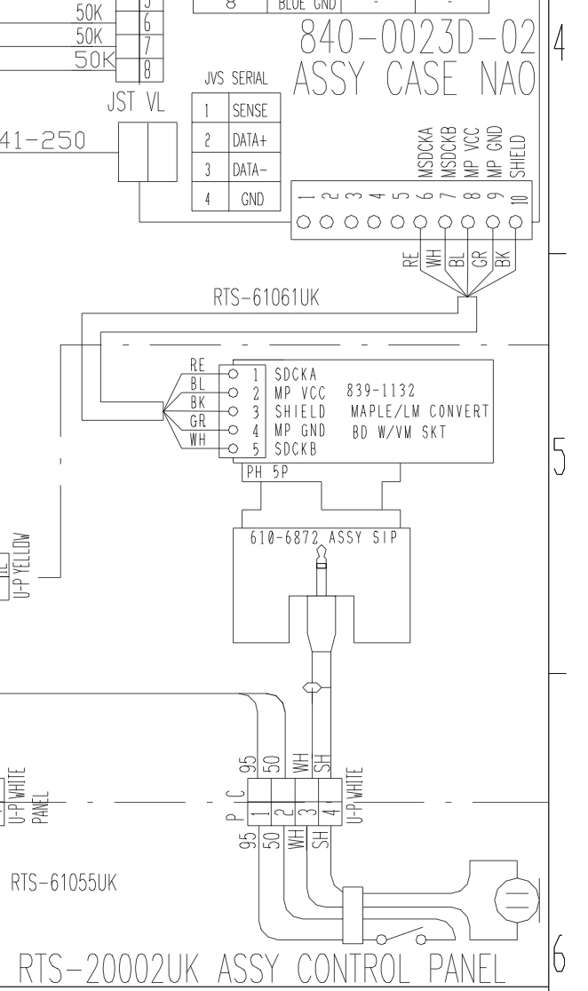

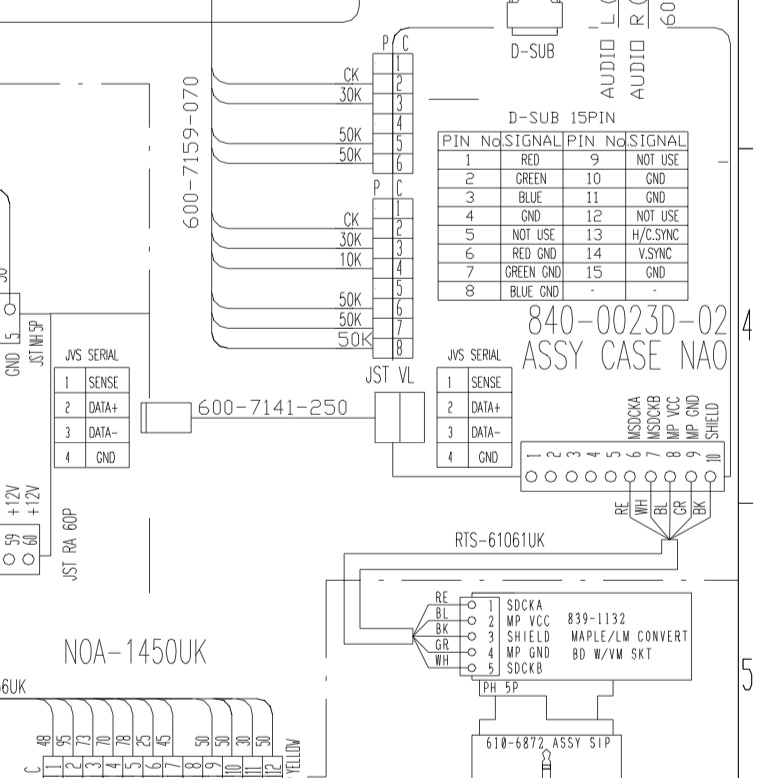

Here is the schematic from the Route 66 Naomi Upright, it shows how the Maple stuff is wired in.

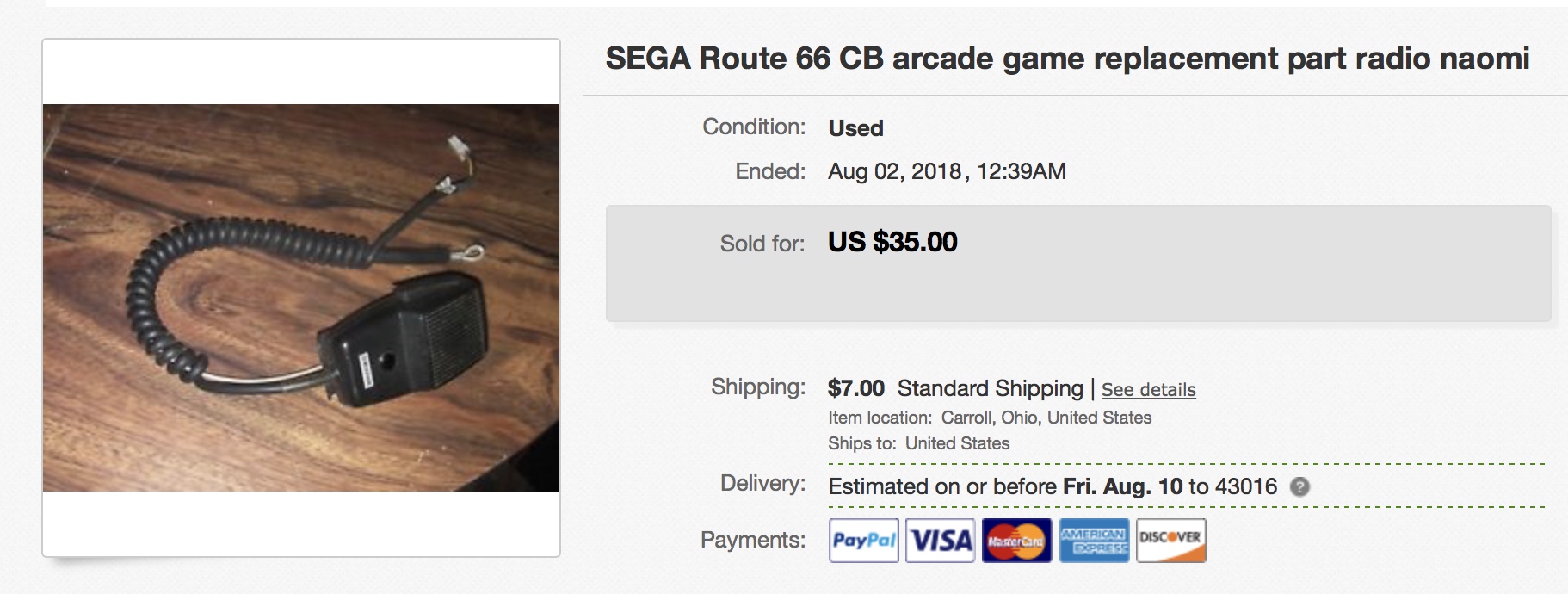

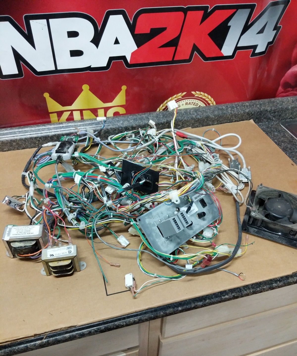

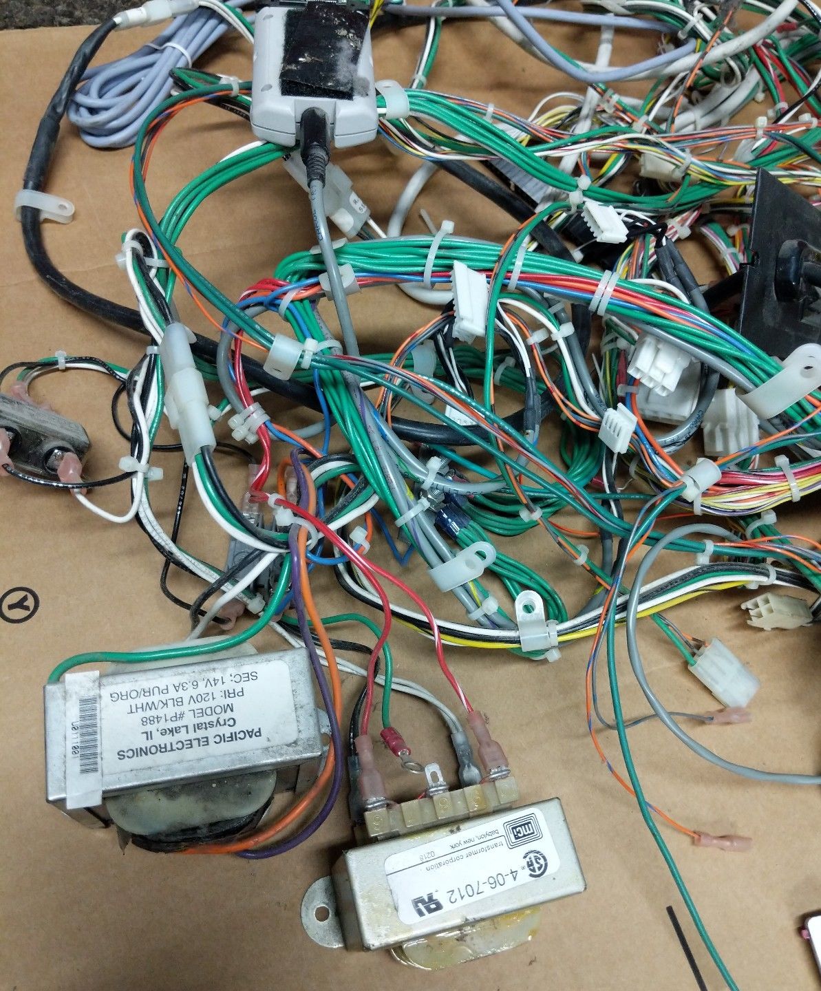

I figured I would take one for the team and just buy that Route 66 harness so I could get a closer look at the maple adapter... I got lucky a few days later the Route 66 microphone I'd been searching for magically surfaced in the wild (on eBay also).
Here are the close up pics of the microphone adapter / harness bits. It is indeed using an off the shelf DreamCast adapter FWIW.

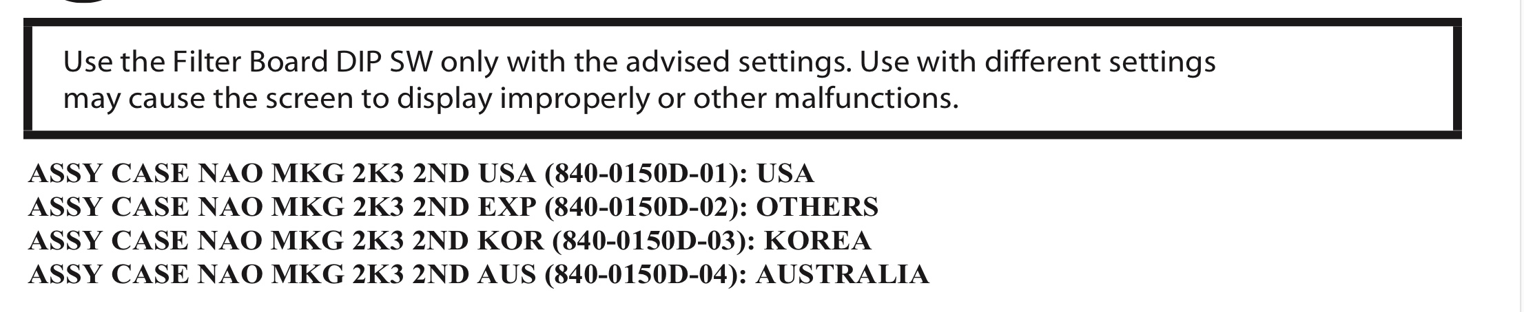

Having looked at a few Naomi1 manuals, I suspect the "840-0023D-02" is just a Naomi2 with a specific region setting. I have an "840-0091D-10" now. (I've since confirmed that my current board is an "OTHERS" region Initial D Naomi per this manual http://store.playitamusements.com/Manuals/Initial D 3.pdf)
Likewise I never noticed that CN7 maple bus has 11 pins, where as CN6 only has 10. I am guessing this connector plugs into CN6 since the diagram shows a 10 pin connector.
Update:

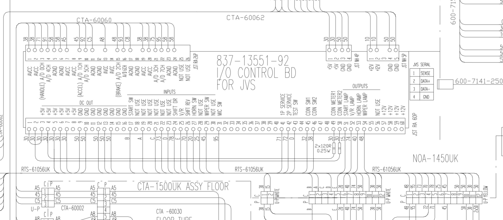

I just went a head and YOLO'd it up, I removed the Microphone Enable and ground from the JAMMA edge (guess this was from a DLX cab vs a Naomi Upright?) and pulled the cable out of the bundle.
I'll try to connect it to my New Net City control panel pinouts so it can make its way to the JVS IO board.
I'm guessing the AMP connectors use a familiar pinout even though this is a "driving" cab. Pin 50 should go to GND, and pin 95 to "MIC SW". Once I get it connected and the Mic shows up, I'll check back in.
Update:
Now I'm curios.... were you able to get the 839-1132 board connected to the Naomi CN6?
