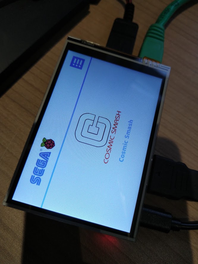

As for the front end I was thinking I can just run a web browser in kiosk mode connecting to the internal web server and display the web front end on the screen which will be quick and easy to get running, see what that looks like and go from there

Had a very nice surprise today, went out for lunch and when I came home there was a mysterious Amazon package waiting, I thought 'I haven't ordered anything ...' - well turns out I have a very generous benefactor who has gifted me a 3.5 inch touchscreen to get started on development :)
Thanks Scott! not sure what your handle is on here but it's really appreciated dude, thank you!
So it would be rude not to get cracking on this and after a few botched attempts I got it working - turns out you need to ignore the instructions that come with it! The screen refresh rate is a little bit slow, hope that's just a configuration thing, I'm sure you can increase the SPI bandwidth in the config.txt file somehow ... but the response from the web server and in the browser is just fine. I'm missing scroll bars but I was thinking of changing the layout to a carousel for games/systems/options for the touchscreen, a swipe left/right/up/down interface, been playing with swiper a bit which has plenty of options.
Edit: played with various settings to overclock the display and got it running much better, still not the 50fps quoted on the box but the preview videos look reasonable on it
