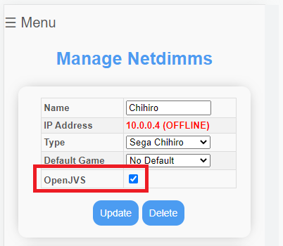

This is what I have in the log file - and after the game is loaded, you can see that openjvs is still active with "generic" as the profile. I assume I am just missing a config item somewhere.
root@Netbooter:~# cd /var/log
root@Netbooter:/var/log# more wipiloader.log
root@Netbooter:/var/log# tail -f wipiloader.log
2022-03-23 01:30:47,269 Wipiloader script started
2022-03-23 01:30:47,270 OpenJVS mode is
2022-03-23 01:30:47,270 openon
2022-03-23 01:30:47,271
2022-03-23 01:30:47,271 OpenFFB mode is
2022-03-23 01:30:47,272 ffboff
2022-03-23 01:30:47,273 Card emulator mode is
2022-03-23 01:30:47,273 auto
2022-03-23 01:30:47,274
2022-03-23 01:30:47,274 Server mode is
2022-03-23 01:30:47,275
2022-03-23 01:30:47,275 serveroff
2022-03-23 01:30:47,276
2022-03-23 01:30:47,276 Active dimm is
2022-03-23 01:30:47,277
2022-03-23 01:30:47,277 10.0.0.6
2022-03-23 01:30:47,278
2022-03-23 01:30:47,335
2022-03-23 01:30:47,336 Requested rom file is
2022-03-23 01:30:47,336 /boot/roms/n2-initial_d_3_export-[GDS-0033].bin.gz
2022-03-23 01:30:47,337
2022-03-23 01:30:47,346 Server mode is off - starting netdimm_send script
^C
root@Netbooter:/var/log# ps -ef | grep openjvs
root 542 1 2 01:27 ? 00:00:07 openjvs generic
root 14585 1790 0 01:33 pts/0 00:00:00 grep openjvs
Looks like the OpenJVS target isn't being set, check this box is ticked:

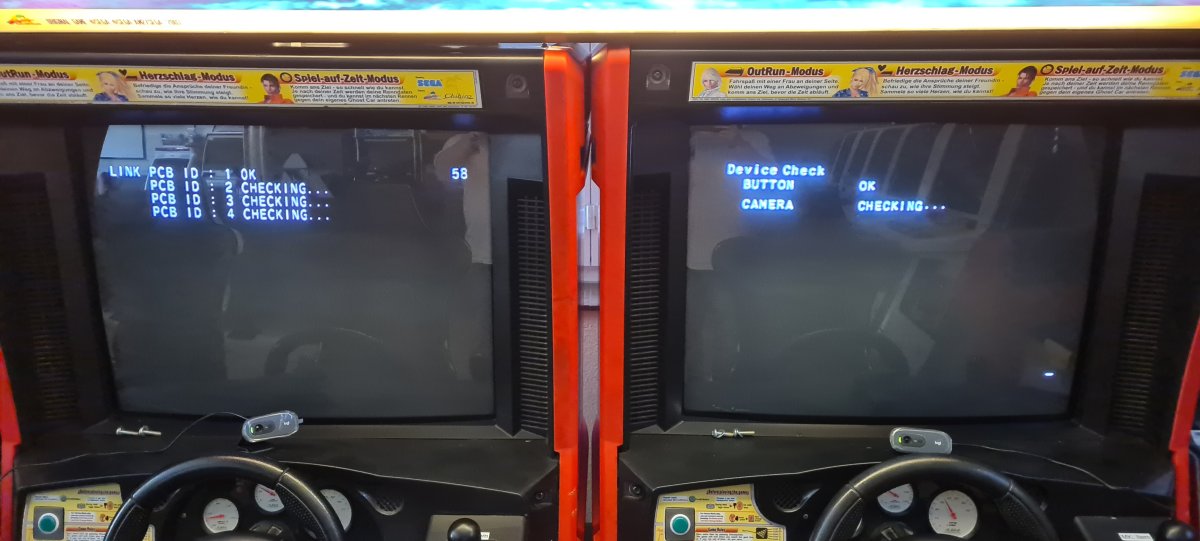

Today added a second WiPi Setup with a second camera to my twin to test more on MK. On left camera is working in test menu but not within the game. On right the camera is working perfectly in test menu and the game.
Found following differences:
- During boot the right (working) is doing a device check, including camera. Left (not working) is not doing that.
- Right setup (working) uses older firmwares:
Left - not okRight - ok
Triforce 1.53.011.07
NetDimm4.013.17
What firmwares are you guys with working cameras using?
NetDimm4.013.17
Did swap Triforces between both players, everything else remain the same. Afterwards the camera did work at left but not at right. Also card reader emulator worked at left.
So problem is related to the Triforce. Not sure if related to newer firmware version.
