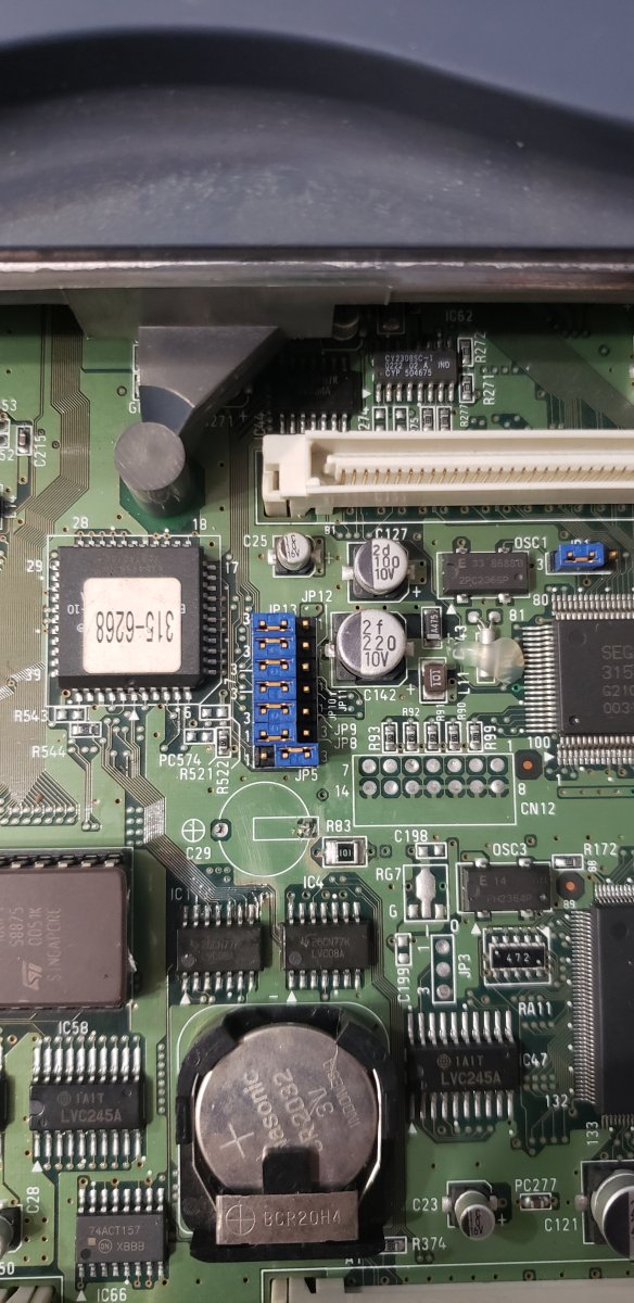

Found my issue. This might have been mention before but I'll put it here anyway. The Naomi 2 need to be told to use the RS232 protocol. This can be done by changing the 7 jumpers under the cart on the main board to the following. Both my cable are working as it should. Also my 1st mistake was using a jamma to jvs (neither the capcom or Sega will work) you need at least a type 1
JP5 = 2-3 (close to filterboard)
JP8 = 1-3 (away from filterboard)
JP9 = 2-3 (away from filterboard)
JP10 = 2-3 (away from filterboard)
JP11 = 2-3 (away from filterboard)
JP12 = 2-3 (away from filterboard)
JP13 = 2-3 (away from filterboard)

Found my issue. This might have been mention before but I'll put it here anyway. The Naomi 2 need to be told to use the RS232 protocol. This can be done by changing the 7 jumper under the cart to the following. Both my cable are working as it should. Also my 1st mistake was using a jamma to jvs (neither the capcom or Sega will work) you need at least a type 1
Nice!
How/where did you find that from?

Nice!
Old sega-naomi.eu post. Did some late night searching as I was confident that my wiring and couple set of serial cable was good.
