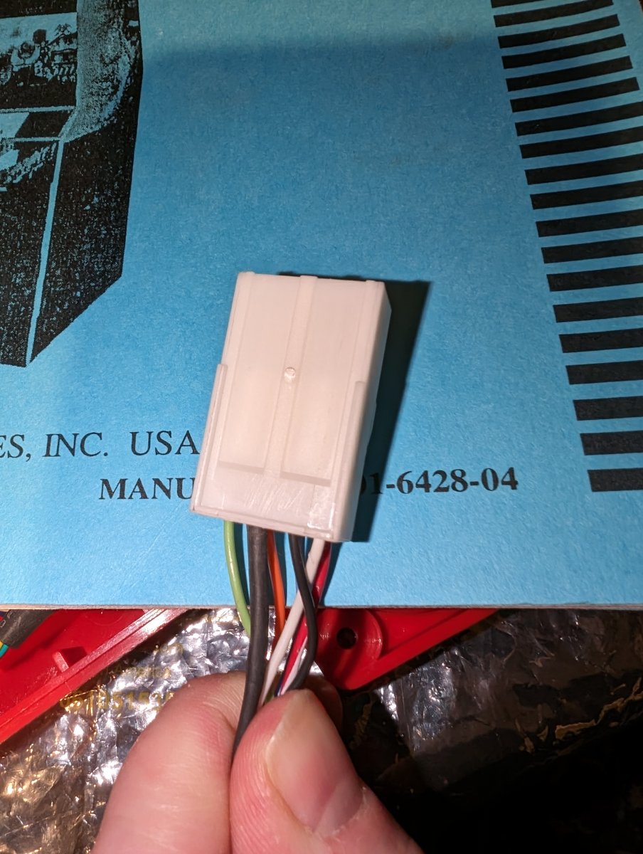

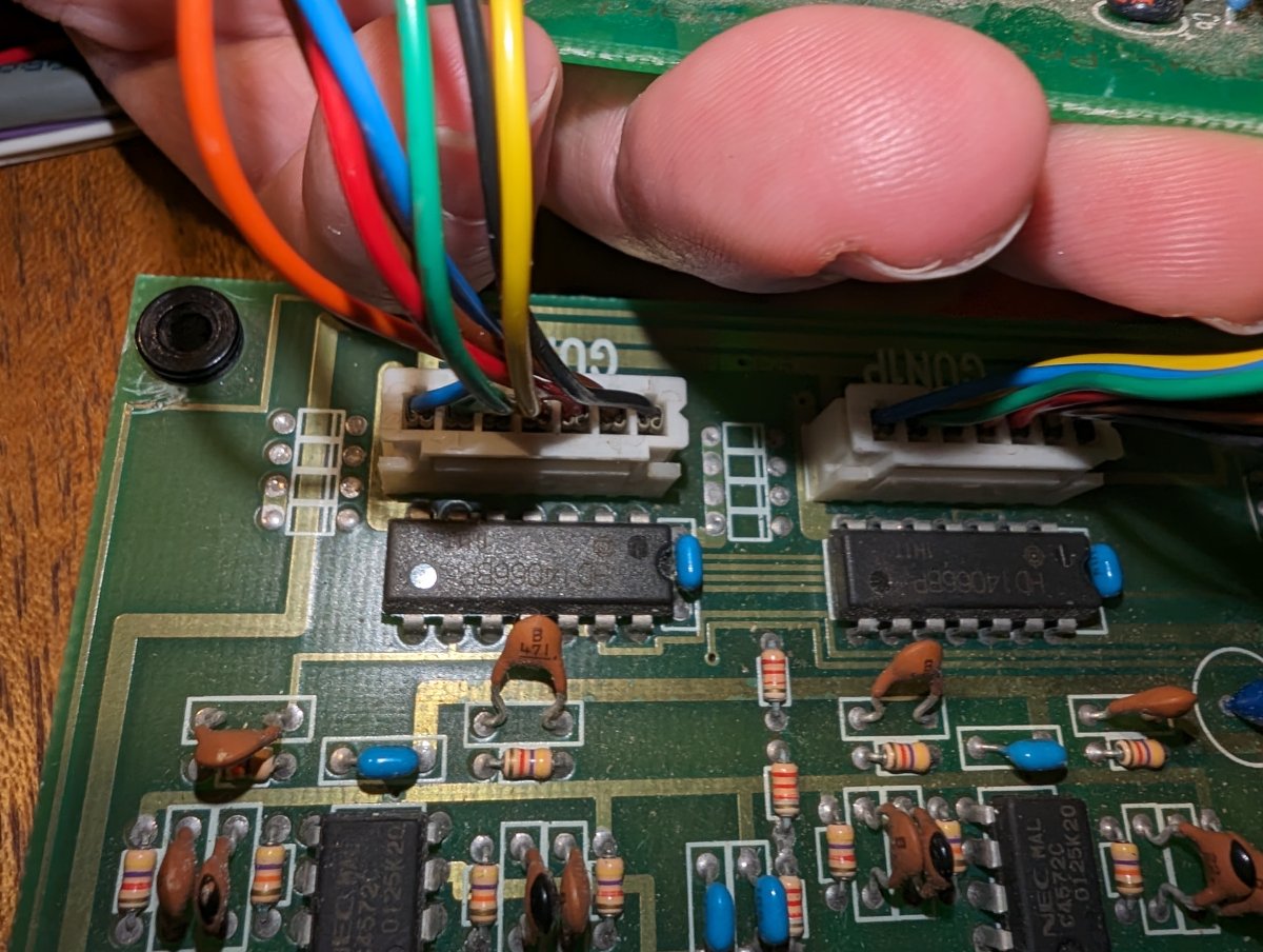

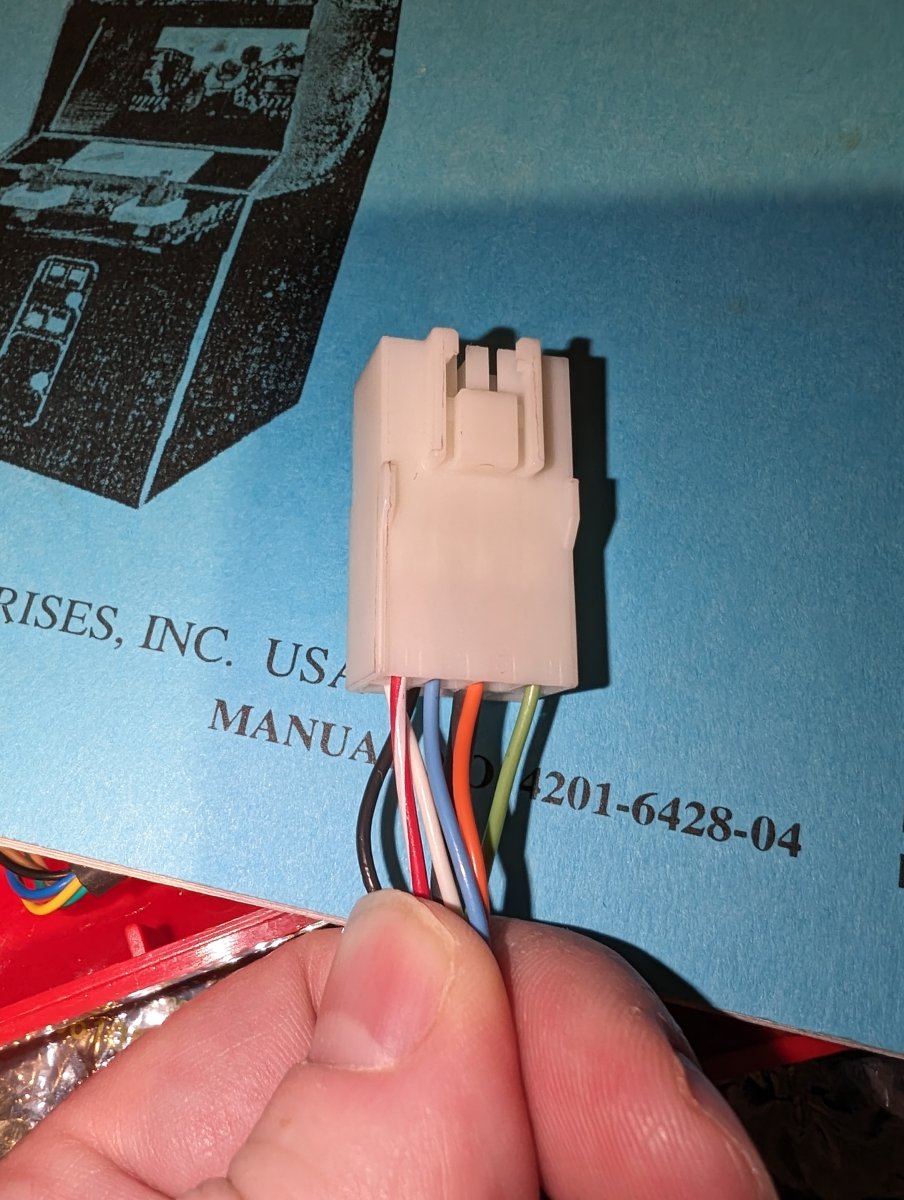

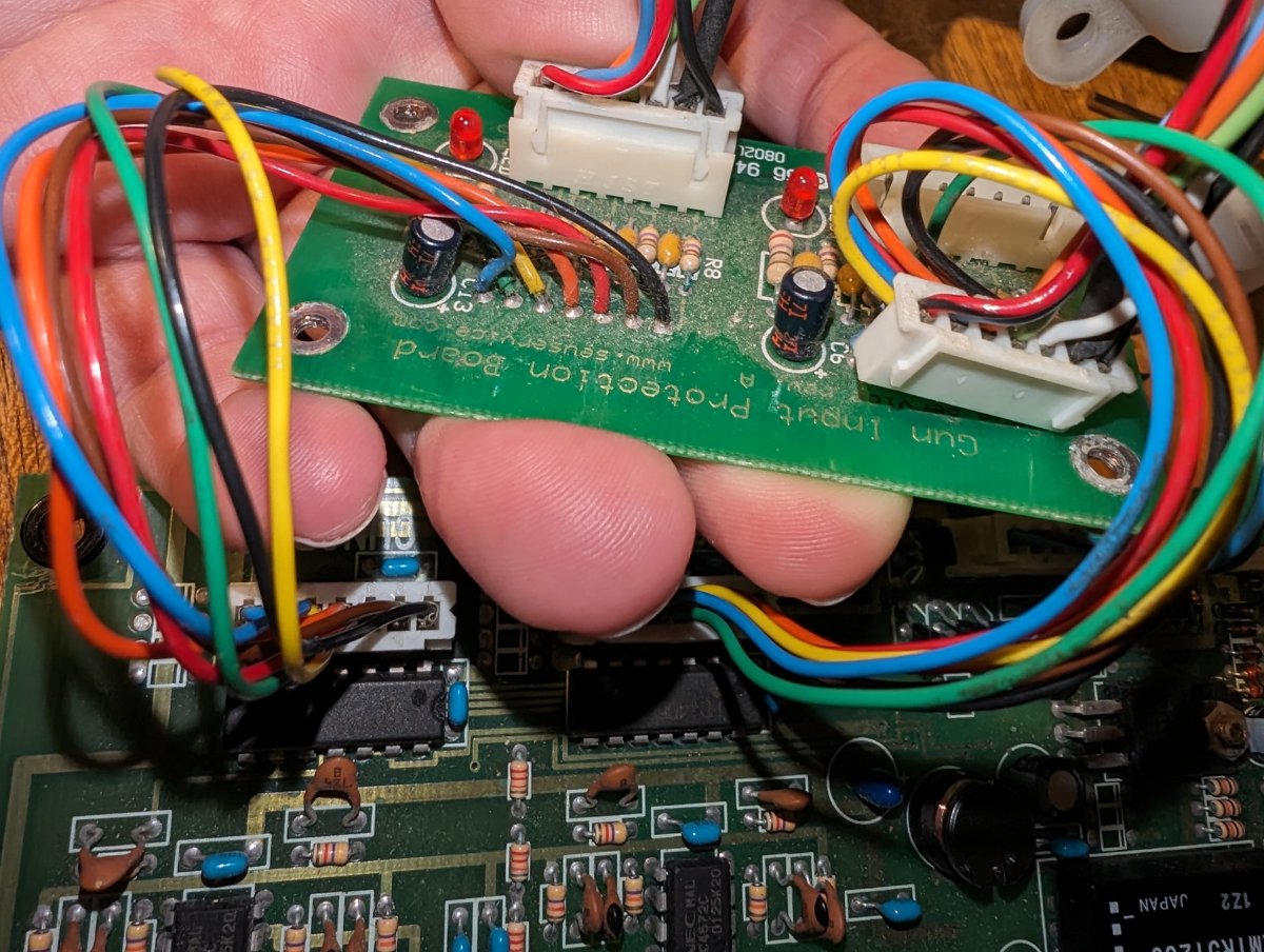

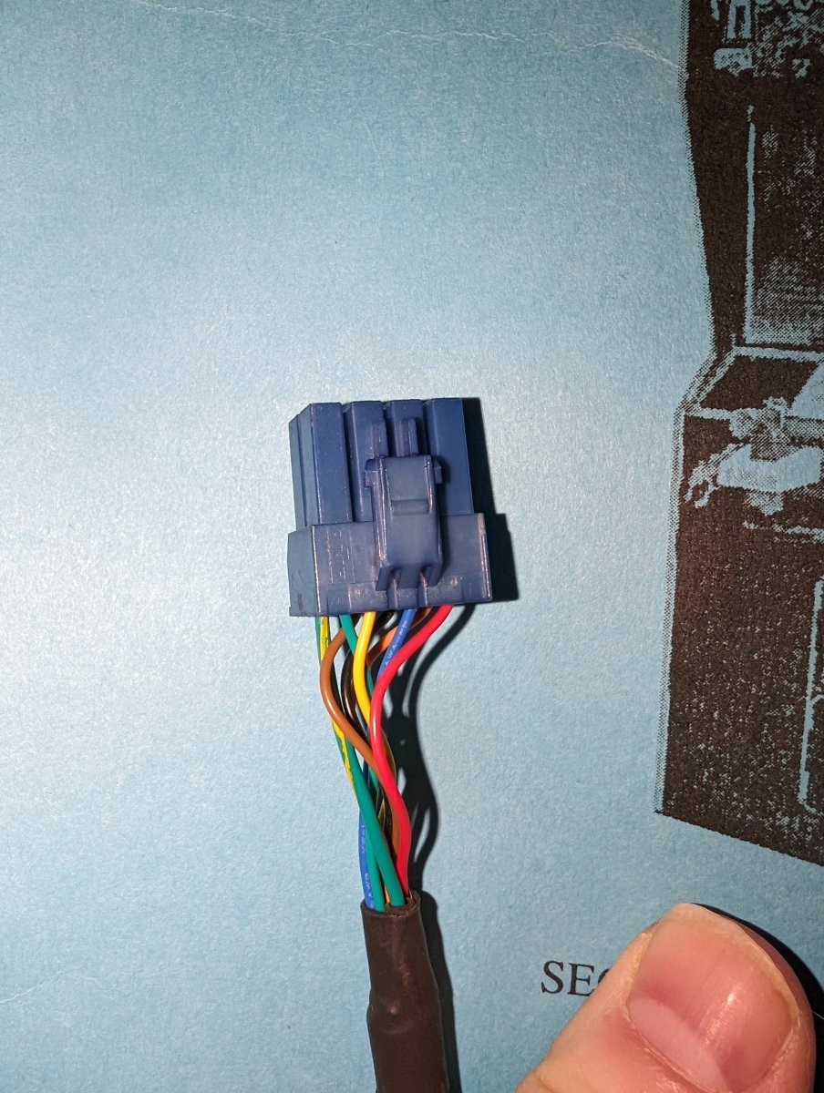

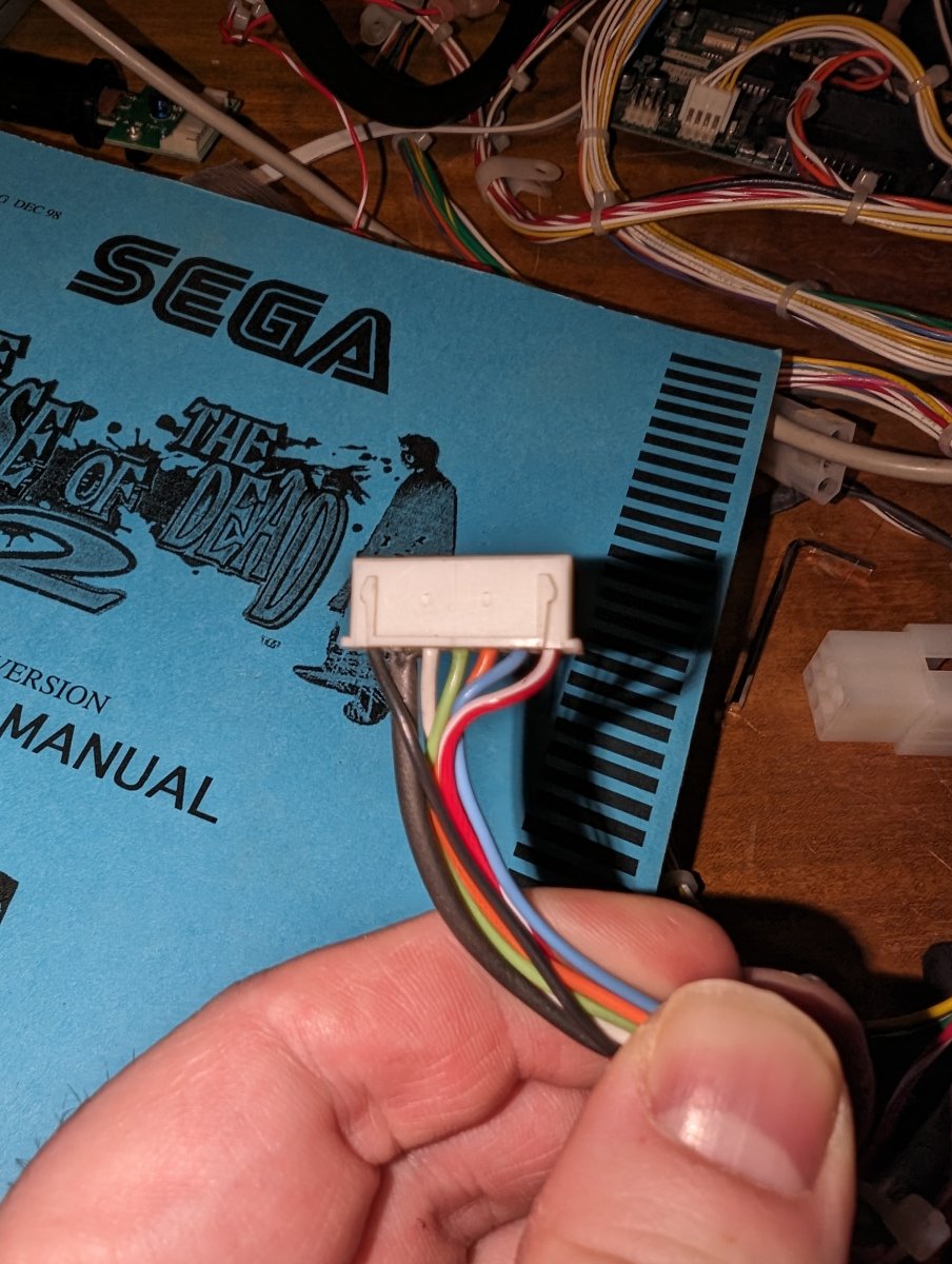

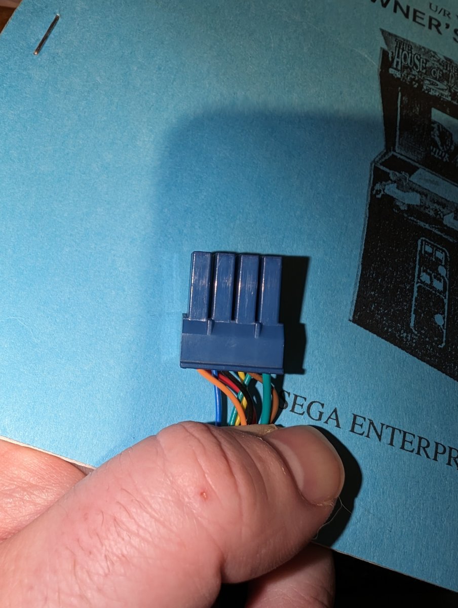

Attached should be all the photos of the custom wiring to the IT board. I haven't checked the continuity from the gun to the IR board but it's factory wiring from the AMP connector to the gun inputs.

How do you have the gun sense board connected to the JVS IO?
I bought a hotd3 wiring setup and it's connected to a Type 1 JVS io and I've tried 3 different ones. The trigger input and out of range do work when jumpered with the connectors so those should work.
I can get pics of those as well if you'd like.
That's probably the problem. I had a similar attempt using hotd 3 wiring and never got anything out of the guns using the hotd 3 gun board to gun cables into a hotd2 gun harness.
I never got anywhere using those parts and ended up buying a hotd2 cab(my boards used in previous attempt worked fine when tested in cab)
You might want to compare wiring diagrams and make alterations as needed.
I will double check but I was able to make the trigger enable when I jumped the trigger to common wires for both players using the 9pin JST XH connector. According to both manuals, the pinouts are the same, minus the reload switch. However since we are running into the same issues, I'll tear apart the wiring and see what I can see...
FIGURED IT OUT!
The HOTD3 setup has a connection for a .5A fuse on the 12VDC rain to the guns. I didn't have that connected so my guns weren't firing!
That is most likely your problem, if you still have it, you can connect the red/white and red/black wiring together and it should be fine!
