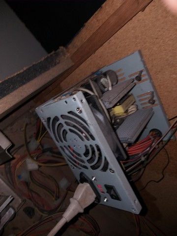

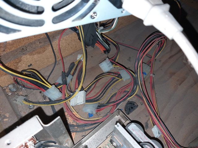

Some months ago, I've managed to get a MVS cabinet in a American surplus store somewhere in the town. While the machine does turn on, they informed me that they had to replace the previous PSU since it's broken. I know I had to replace it but until recently, I don't exactly know where to ask this kind of stuff.
After me and Darksoft had a conversation, he suggested to me to replace my cabinet's PSU with a regular computer PSU. Now, I'm very new to the whole technical stuff and was surprised that you don't exactly have to use an official arcade PSU (at least until they're available again).
With that said, what exactly is the kind of computer PSU should I get (considering there's different kinds) and how do you set it up with your MVS board?

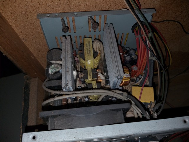

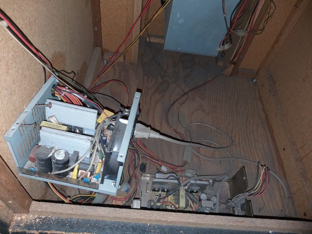

I've got some screenshot of the current PSU. Pardon the dust, it manages to comeback even after I cleaned it. The board is clean though.
Also, I've been meaning to ask, where exactly do you check the voltage of the board? It's the wire set on the left right? I want to know the voltage of the system using a Multimeter.

Your cab already has a computer PSU. That actually might be the problem. Computer PSUs don't have adjustable +5V rails.
You should measure what kind of voltage you're getting at the motherboard.
