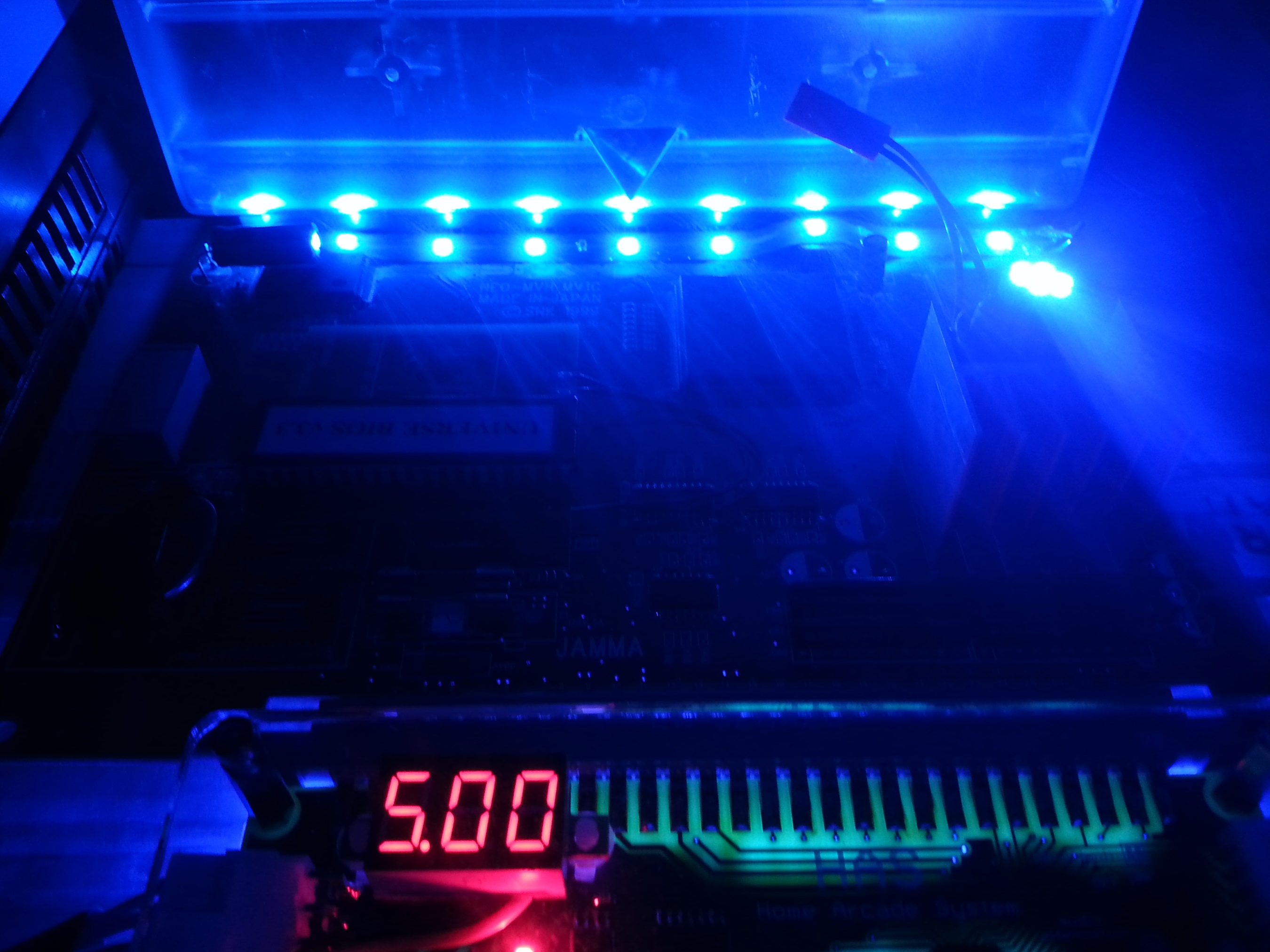

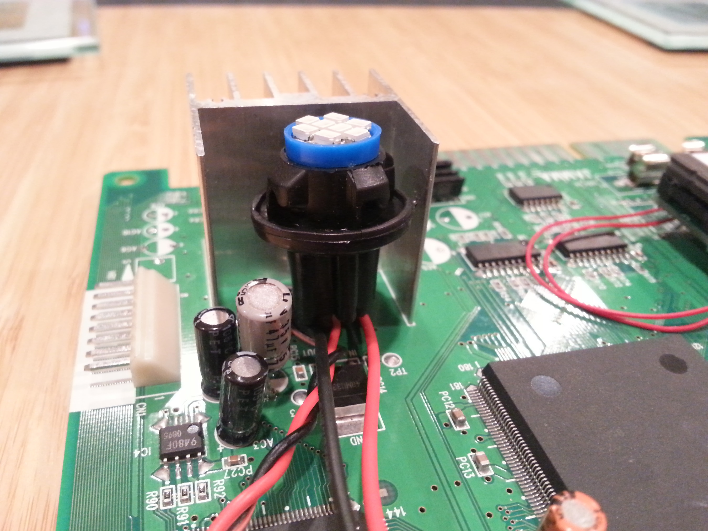

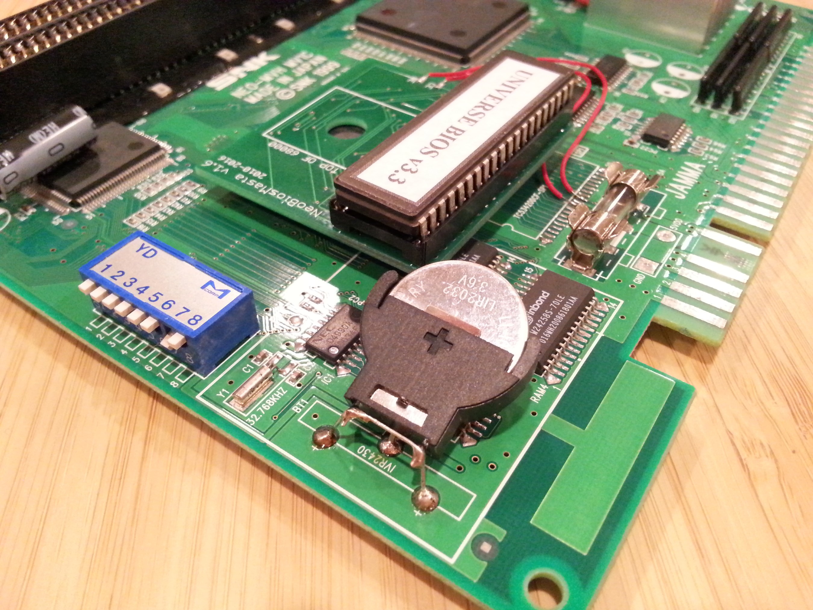

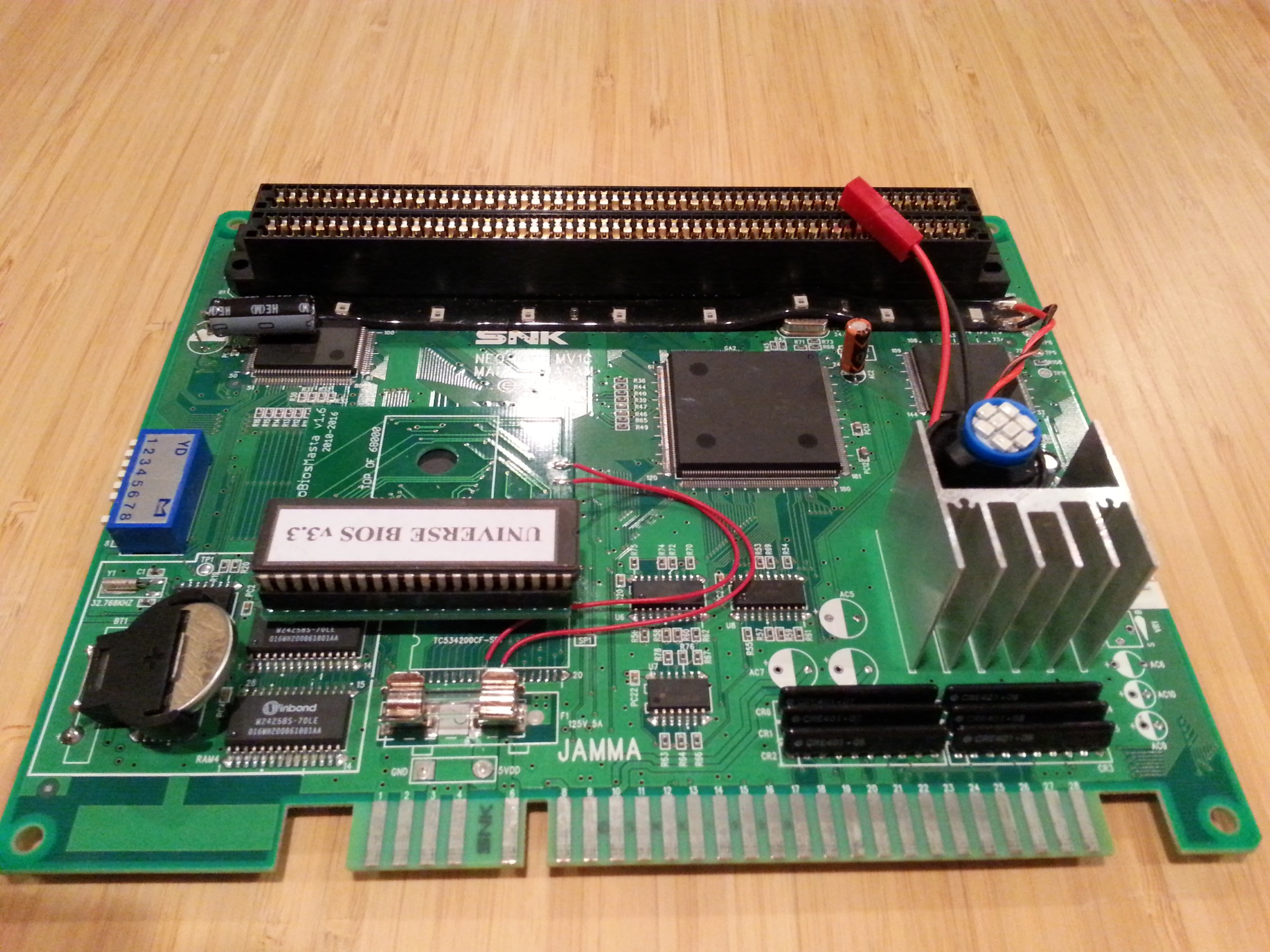

Here's an MV-1C I modded for @noonan2678 last year. I cleaned and recapped it, installed a NeoBiosMasta and Unibios, gave it line-level stereo audio jacks (disabling the mono circuit) and a rechargeable battery, and LED strips. It came out even better than my own, since I had a better plan of attack the second time around.
You can see that I also added another LED tower under the top grill, and I used a nicer red pilot light "jewel" style LED, inspired by my Traynor YBA-1A Bass Amp. I used couplers to make the entire top panel removable, because he was considering eventually moving it to a complete Lion3s Plexi.

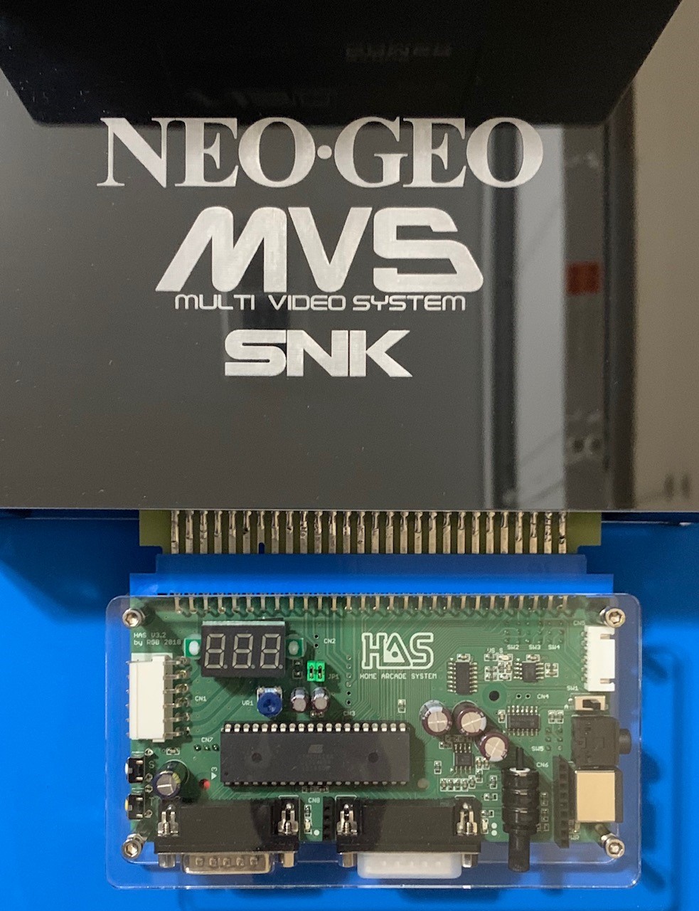

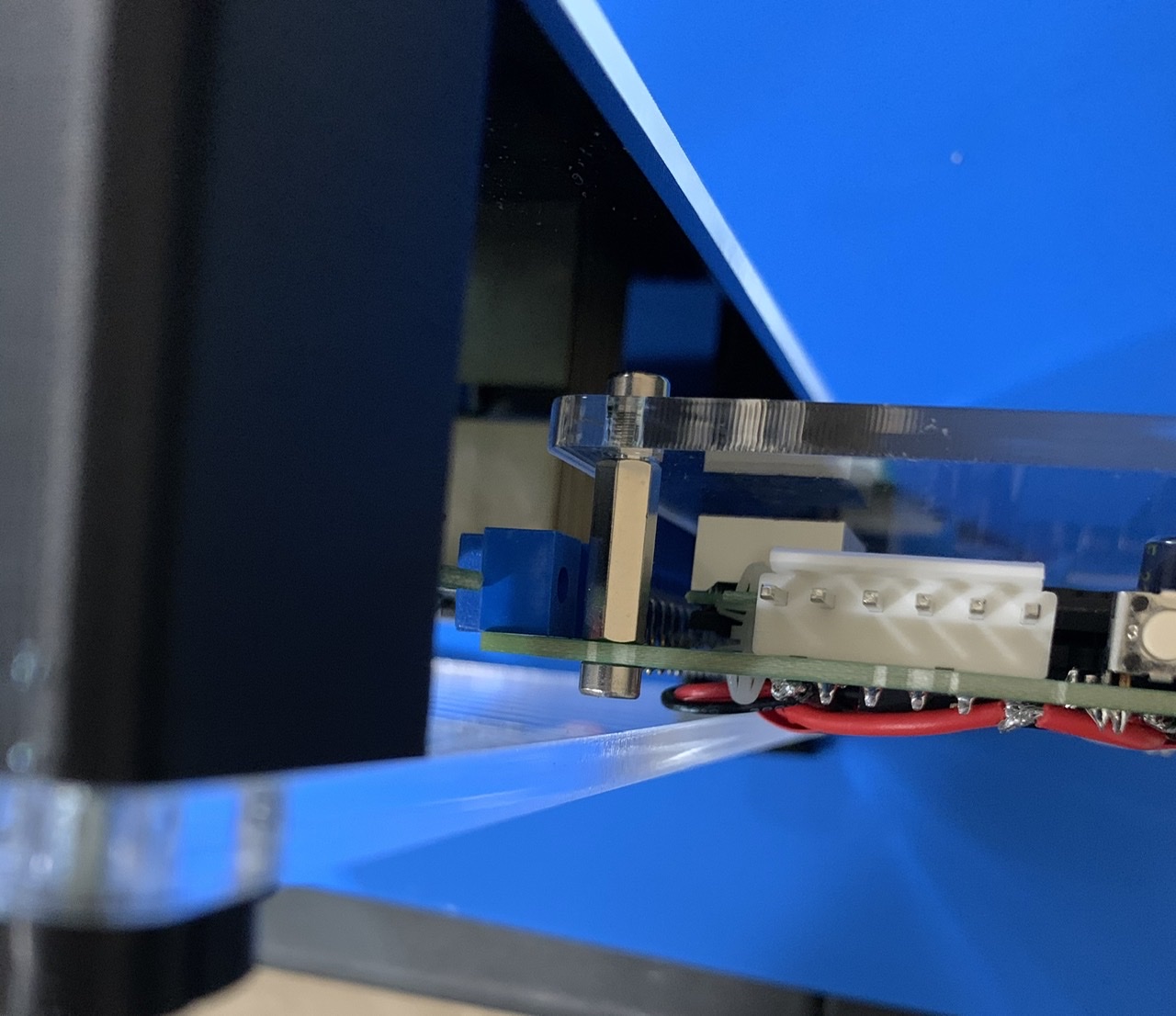

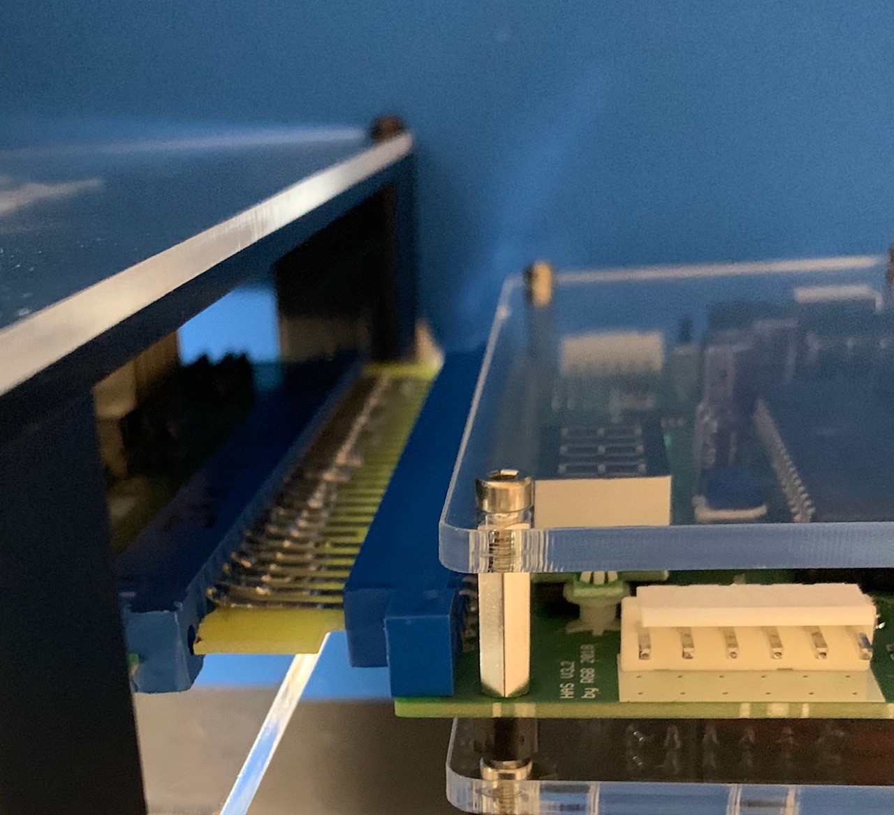

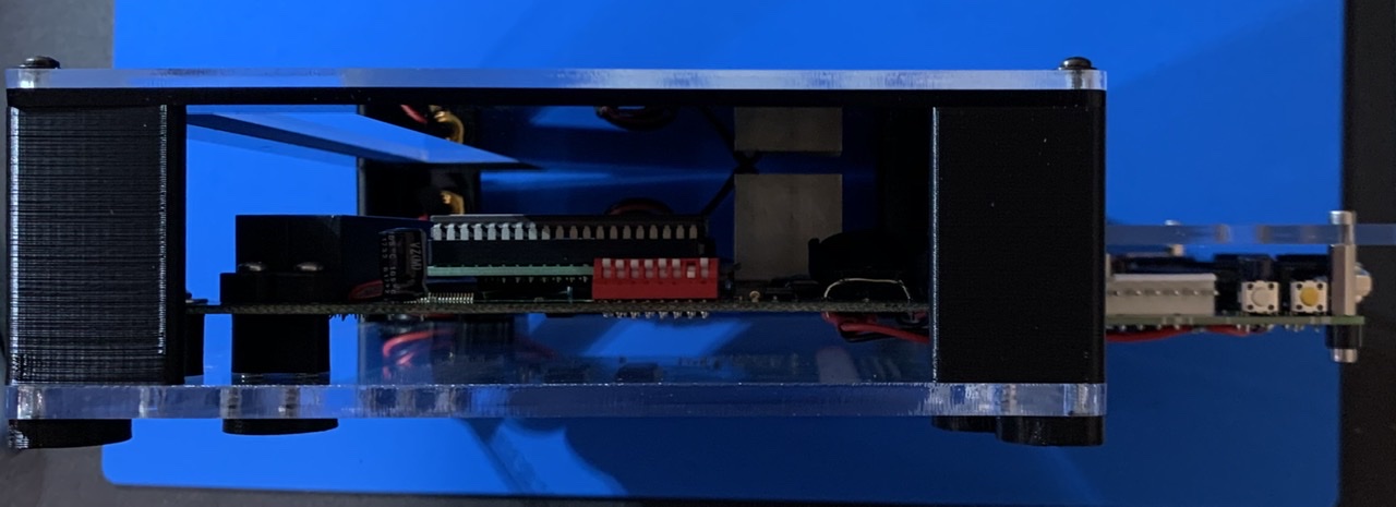

I got the Lion3s Plexi case and installed it today on my MV-1C,is there a way to fit the HAS without taking the bottom Plexi off the HAS like I had to do?
My HAS doesn't come in contact with the plexi, so maybe Lions3 redesigned them? I would contact him because I think a lot of people would be disappointed by this.
Mine BARELY squeezed in with the bottom plexi, but it didn't quite fit with the black standoffs. I had contacted him about it (years ago) and he was willing to print slightly smaller ones that would clear. I lost track of it and haven't followed through with it yet.
