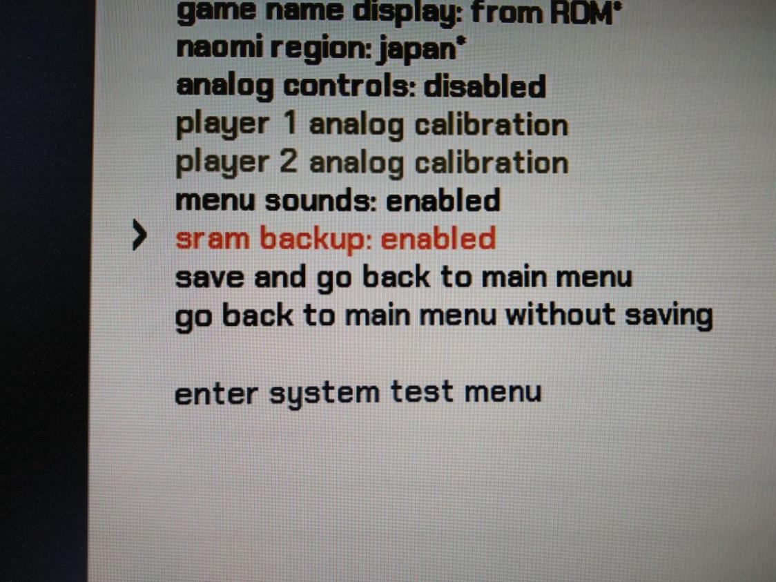

It's taken a while to get to but I'm starting to extend the support for the settings definition files into WiPi that allow you to set game assignments directly from DragonMinded's awesome on screen menu. I've also been playing with the SRAM backup and restore and have integrated it into the menu as an additional option. The way it is designed to work is that when the menu is loaded from WiPi and the option is enabled it will back up the existing contents of SRAM and as the menu doesn't use SRAM that will should be from the last game played. This gets sent back to the pi and stored in a file - as the pi knows which game was last sent either over wifi or from the menu it gets named as such and then when the game is sent next time the correct SRAM file is restored via the menu to the Naomi.
This works well with the on screen menu but it would be a bit clunky to integrate with games sent over wifi, the issue is the SRAM backup and restore uses a helper function that is netbooted so you would have to manually backup and restore or you would have multiple reboots while the helper rom is netbooted, SRAM backed up, reboot, game sent.

Is it possible to add a folder like structure to the OSM to organize games into it? - Structure could be read from a config textfile?
Wow! Extremely cool project!
I’ll test this on the office Naomi on monday!
Next step would be png images in the menu i guess? I’m thinking the logos of the games.
