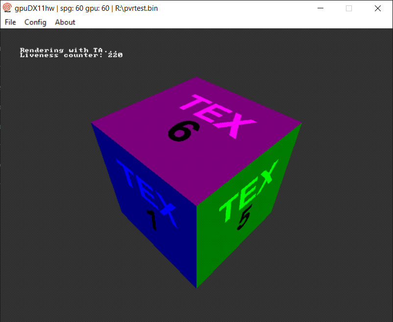

Not much of anything to update but I've been working in the background to get accelerated video working properly with the goal of getting the menu to a full 60fps on all screens. That's not a super big deal, but animations will play slightly smoother and scrolling won't jitter if a frame drops anymore because there won't be any frame drops. I've got it mostly figured out except for when I went to enable 32-bit RGBA modes I'm getting lines through my textures. Funny enough, demul properly emulates the fault and displays it the same is the Naomi does. So I wonder if @MetalliC can think of anything off the top of his head that might cause this? Is there some hidden stride value in some register? I originally thought maybe its just setting the palette entries wrong, but it wouldn't be displaying the correct color in some areas with the correct texture alignment for the full face. I banged my head against it for awhile tonight and it doesn't make sense. If I am in 16-bit video modes, textures work fine regardless of if their palette entries are 16bit 1555 or 32bit 8888 color. But if I am in a 32-bit video mode, while software drawing works fine anything drawn by the PowerVR2 accelerated video gets lines in it, regardless of if the palette entries are 16bit or 32bit.
Here's the weird thing. Its definitely aligning on the texture, not the framebuffer, but I can't see anything I'm missing.
And here's what it should look like (from 16bit modes that do work).
The same texture is used for both 16bit and 32bit, so I am confused. I also tried just setting every single entry in the texture to some value and it still has the lines in 32bit mode.
EDIT: I have just checked the converted textures and they do not appear to have those lines in them either. Perhaps it is the twiddling function that is wrong?
https://github.com/DragonMinded/netboot/blob/trunk/homebrew/libnaomi/ta.c#L712 <-- this here?
Hmmm, I think I am not calculating some memory positions right. If I move the texture memory arbitrarily forward in RAM by 2MB then the lines disappear. So you are right, the texture is getting corrupted somehow. However, the question is.....what shitty code did I write that is doing this?
EDIT: MAME does not support render config mode 5 (0888 mode) so I guess I will start with fixing that and then figure out what is messing with that memory.
yes, that routine probably wrong, for sure it wrong for paletted textures, where twiddling should be done in 4bit or 8bit units, and not 16bit words like in your code
it doesnt matter. you may use 16bit frame buffer mode and use 24/32bit source textures
speaking in general, PVR2 internally always works in 32bit color mode, it converts to 32bit whatever source textures, and in the end store rendered result as per destination format, cutting bits count if needed
I couldn't figure out what was smashing over that memory. The problem does not appear in MAME so I could not trap memory and see what code was the problem. Given that it doesn't happen in MAME I am suspicious that it has to do with the TA/PVR writing over sections of memory. However, when I move the command buffer to 0xA5400000 instead of rounding the next megabyte up from the framebuffer the problem goes away. *shrug* oh well. At least it works.
have you read powervr2 docs ?
there is no any dedicated texture RAM and display list / frame buffer RAM, there is one unified RAM with 2 access modes (64bit for textures and 32bit for everything else), it will access same physical RAM, but just interleaved if compared one to another mode.
so, yes, you may trash some textures by FB or object lists/buffers, or vice versa, if not taking in account how it works.
in any case, your's "texture lines" problem caused by wrong texture conversion algo, as I see in the repo you still not fixed that.
