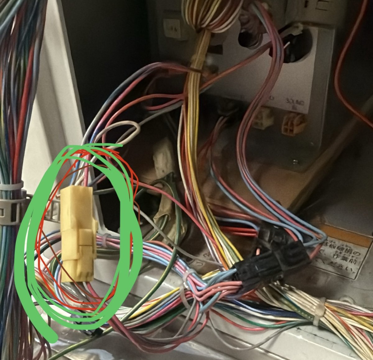

I blew my amp because the cab's speakers were still wired to the main 18 pins AMP UP connector (through the 4 pin connector with the white loop) when I connected it to the NVS-4000 (green rect on my picture). Both the inline fuses on the stereo amp card were blown as well as the amp. Replacing these parts fixed the issue so at least it could be repaired.
The cabs speakers must be connected to the NVS4000 Audio Out (4 pins AMP connector), in the end what happened for me was more about forgetting to remove the speakers connector from the "main" AMP rather than being mislead by the informations on the PSU.

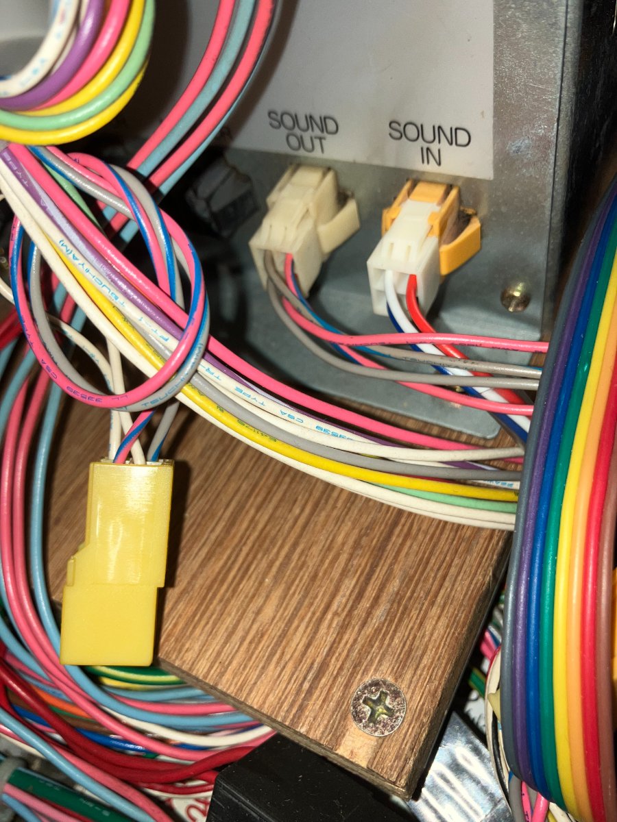

I’m having a few issues, and was pointed here.
I’m very confused.
R1 was fried on my amplifier, and since has been fixed, fuses are good.
Are you saying …
NEVER PLUG SPEAKERS IN the looped female that comes from the DC OUT Port?
Like this?
And always have them in speaker out port, for jamma and rca stereo to speaker in use?
If so, for jamma mono, is anything else needed? Such as… does anything need to be in speakers in?
Check the attached picture :
The looped female port is left empty.
The cab's speakers are plugged to "SOUND OUT".
I do have a cable with RCA connectors (for PCBs that have Stereo sound) that is connected to "SOUND IN".
For regular Jamma mono you don't need anything as the AMP will route the Jamma sound to the speakers.
In the case I play a PCB without Stereo sound with my setup I just leave the RCA cable laying inside the PCB compartment (making sure it does not touch any metal for good measures).

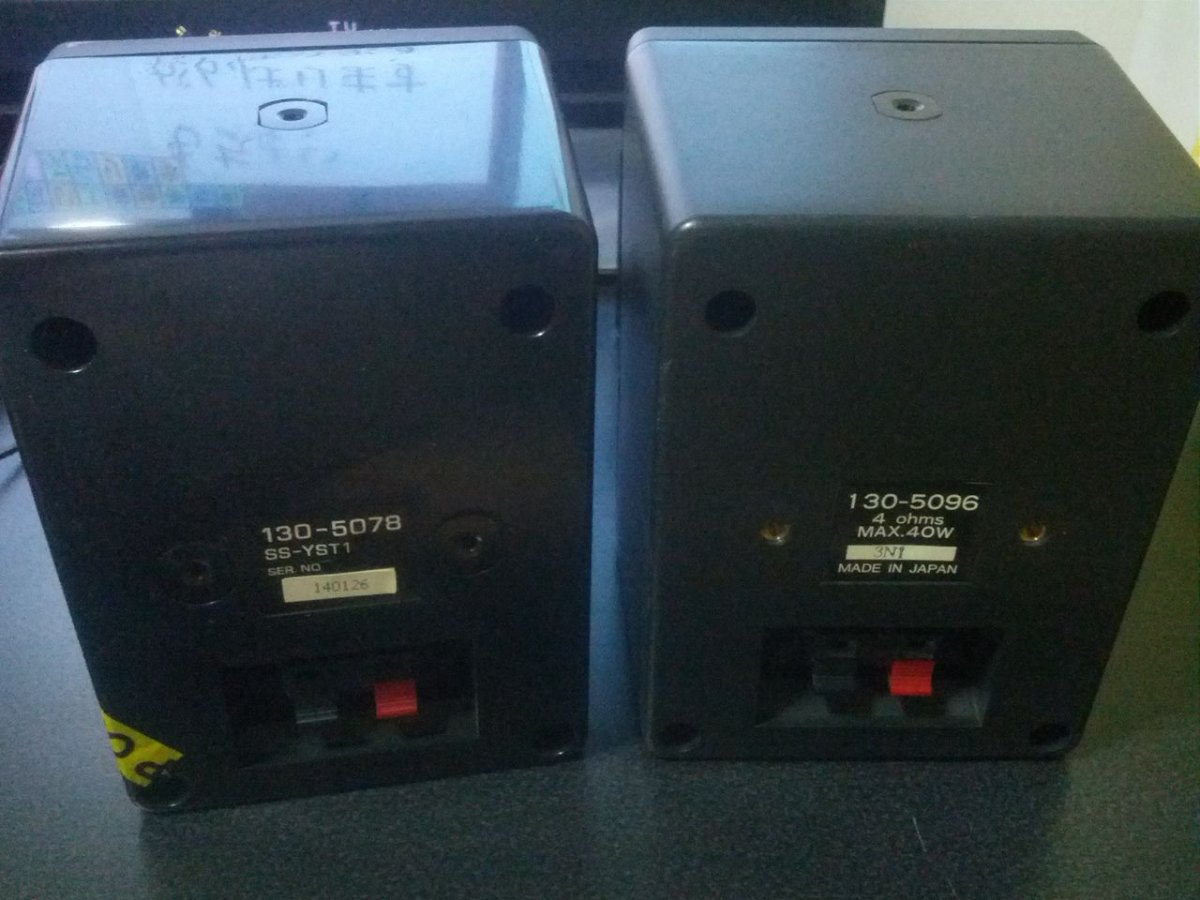

Ive owned an Astro 2 since 1999 as well. A few years ago I uploaded an English user manual to the popular arcade websites (got the manual from Sega UK).
Looking in there, I was surprised to see in fact that the parts list had options for either 130-5096 , or 130-5078
The 130-5096 speakers are the ones rumoured to be 'BOSE'
The 130-5078 are 'YST' Yamaha manufactured. Exterior cosmetic only difference is the casing is gloss black instead of flat black
I have my current 130-5096 connected to an amplifier and they have a nice deep bass sound to them.
Ive just made a purchase from Italy for a pair of 130-5078 as Im genuinely curious of what the difference in sound will be like, even though this is all very old technology to today standard :D
