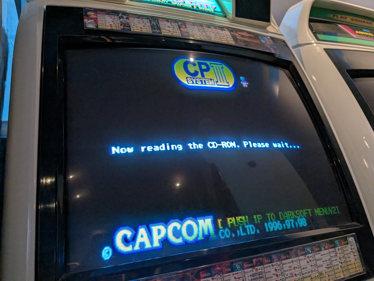

I haven't changed anything since putting the cab in storage. Until that point, it was running Ultra SIMMs just fine with Standard SH2, CD BIOS, and SCSI2SD connected. This previously had the older Darksoft Multi Kit installed (that was how it was when I purchased it).
I'm thinking nem is right and the SD card could have just died over the last year or two. It's an older 2 GB microsd in a full size adapter, if that matters. I plugged it into my PC but Windows couldn't read it, didn't have time to diagnose further but I'm gonna try writing a new full size (no adapter) card as the next step.
Can confirm that if the board hangs with either a frozen region select cursor or black screen after selecting the region, it's probably a Capcom CPU vs Standard CPU mismatch between the security cart and the programming on UltraSIMMs 1 and 2.
Makes sense. I posted the screen mine gets stuck at though (attached again for convenience), which is the reading CD ROM screen. There was one time yesterday that I was able to press 1P Start and get to the Darksoft menu. I think that's how I got it to start to load 3S, but it went black after the game title/ID screen and never loaded anything. I couldn't make it do that again, though, I just get this screen no matter what, or the "connect the CD drive" screen if I unplug the SCSI2SD.

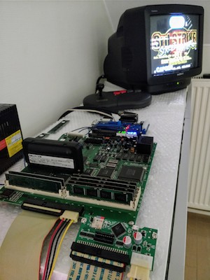

I flashed the Ultra SIMMs for sLpFhaWK and this is what 3rd strike does. (Custom SH2)
I've verified the flash on all sims.
New Generation and Red Earth seem to work fine but all other games have issues.
His Simms and cart seem to work with my mobo (-3 rev) his is a -2 mobo with the Capcom mod board. His setup was working fine with 3rd strike with the superbios before the upgrade.
And the same motherboard works well with regular simms?
my -2 mobo worked with the regular simms before with 3rd strike. i recorded a video last week playing it on the new unico nova blast arcade that was just released to show it off to my friend.
don't judge my 3rd strike skills =) it's hard to record with a camera right in your face between your arms lol
View: https://youtu.be/I6LiOeNpxqE
That's pretty cool but why is the monitor display curved?
I would try to program the simms in different order and see if the problem propagates. If it stays, then it's the simm socket.
Anyways, before reprogramming the Simms, I would give a nice clean to those simm sockets.
Wild guess from me here, but considering NG and Red Earth work fine (using SIMM slots 1-4) and that the rest of the games tried aren’t working properly, my $ is on either UltraSIMM 5 or 6 being faulty.
Thanks! I think I've got it fixed. Based on these two comments I decided to focus my troubleshooting under the assumption that there was a bad connection between the SIMM and the socket on either SIMM 5 or 6.
removing the ribbon cable for the selector I noticed that SIMM6 was lose in the socket compared to the other sims and wanted to naturally sit more upright but the ribbon cable was forcing it more towards an angle.
I removed SIMM6 and took a small flat screwdriver and gently pushed all of the back/upper pins towards the socket... the whole row. Reinstalling the SIMM it was then nice and snug in the socket and sitting at the correct angle and now 3rd Strike seems to be working well.
View: https://youtu.be/x5oY-a9CMT0
EDIT: I've done a more through test and all games seem to be running rock solid now. Thanks all!
