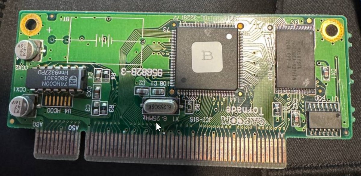

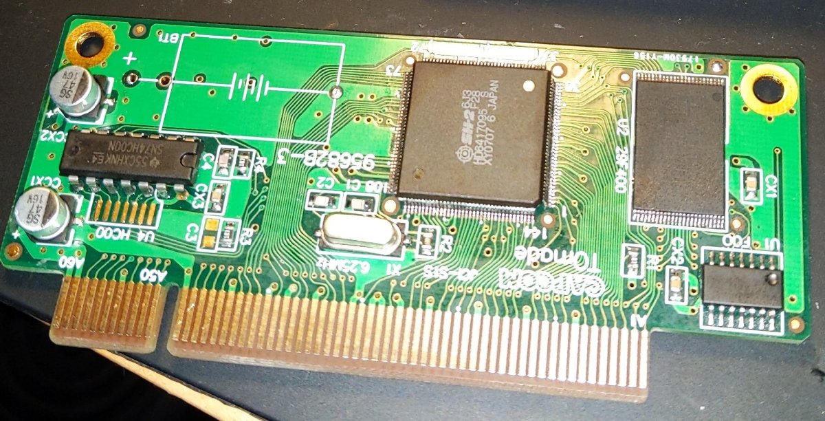

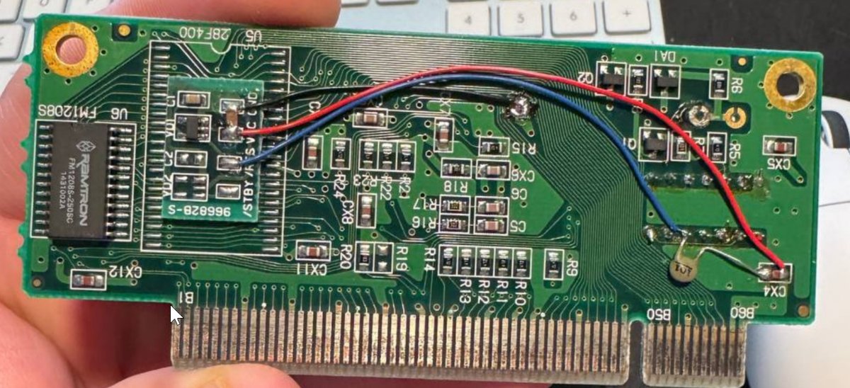

So I am still throwing this idea around in my head, but I was told i'd need to flash my cart with the ulti bios? but i read it needs an original board but i don't htink mines original, i've attached pics. @Darksoft would i need a new untouched cart or would this work?

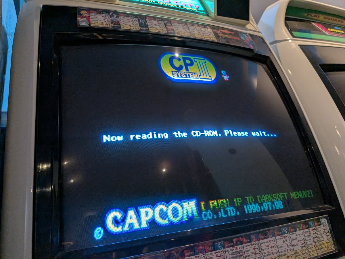

Hi all, wondering if anyone can help me diagnose what's wrong with my Ultra SIMM setup. I had to store my games for about a year or two, but before that it was working perfectly. Now it just stops at the "Now reading the CD-ROM. Please wait..." screen. The buttons are also unresponsive at this screen.
I have a SCSI2SD that I thought might have a bad ribbon cable, but I just replaced that with a new one and it didn't change anything. Not really sure where to start with this one.
Edit: It's been a while since I've done this, maybe the SCSI2SD is redundant in the setup? I unplugged it and it started to load 3S, but then was black after the game ID screen. I think I'm going to try re-flashing my SIMMs, maybe they lost their data after being unpowered for too long, or something.
Edit 2: I'm digging through old emails and DMs, I realized why I had the SCSI2SD in the mix. I had intended to swap to the NoCD BIOS, but mixed up my chips and installed the CD BIOS instead. So I need the SCSI2SD plugged in to at least boot, though I'm not sure why it behaved the way it did when I unplugged it. I'm also realizing now that maybe I just needed to re-seat the SIMMs, but I'm halfway done reflashing them so I may as well finish that.

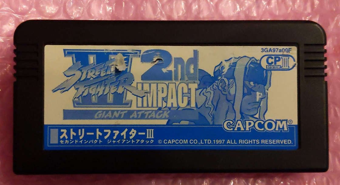

Which cartridge do you have?
TBH I'm not 100% sure, I took poor notes back then and can't remember how all of this worked. I have these photos, I want to say this means it's a Standard SH2 (repro) because it says SH-2 on it? And the OEM Capcom ones are (confusingly) called Custom and don't say SH-2, do I have that right or am I backwards?
Edit: okay yes, I do remember that correctly. Phew!

If you have the ultra simms, you might as well just send your cart to get it reflashed to a ultra NoCD by shootthecore
