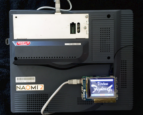

Does anyone have a version of this that also works with the adafruit touch screens??
Similar to what this guy is ding:
I got one of those Touch displays for another project and I've been pretty disappointed with the touch aspect of the display... it's super inconsistent where a light breeze will act like you're slamming your fist against it and other times you can be hammering on the display and it wont register the touch. the image quality is pretty shitty too, though that doesn't matter all that much. for the price it's not worth it, buy a $15 used iPod Touch and run the web interface and not only will it look and react better but it's cheaper and wireless.
the character display and keypad is still the superior option IMO because it just works.
Agree, I use @chunksin version of the web interface and its by far the one I like the most. This is a request for someone that I did the reset mod for.
Also, has anyone worked on a version of the web interface to push the same or different games to multiple Naomis?
On that note, the way I do the Pi power/reset mod now is to install a USB port right on the filter board. Makes things so much simpler. The fuse mod was done by Ken.
I am currently using the Adafruit color touchscreen setup but want to try the version that lets you use your smartphone.
