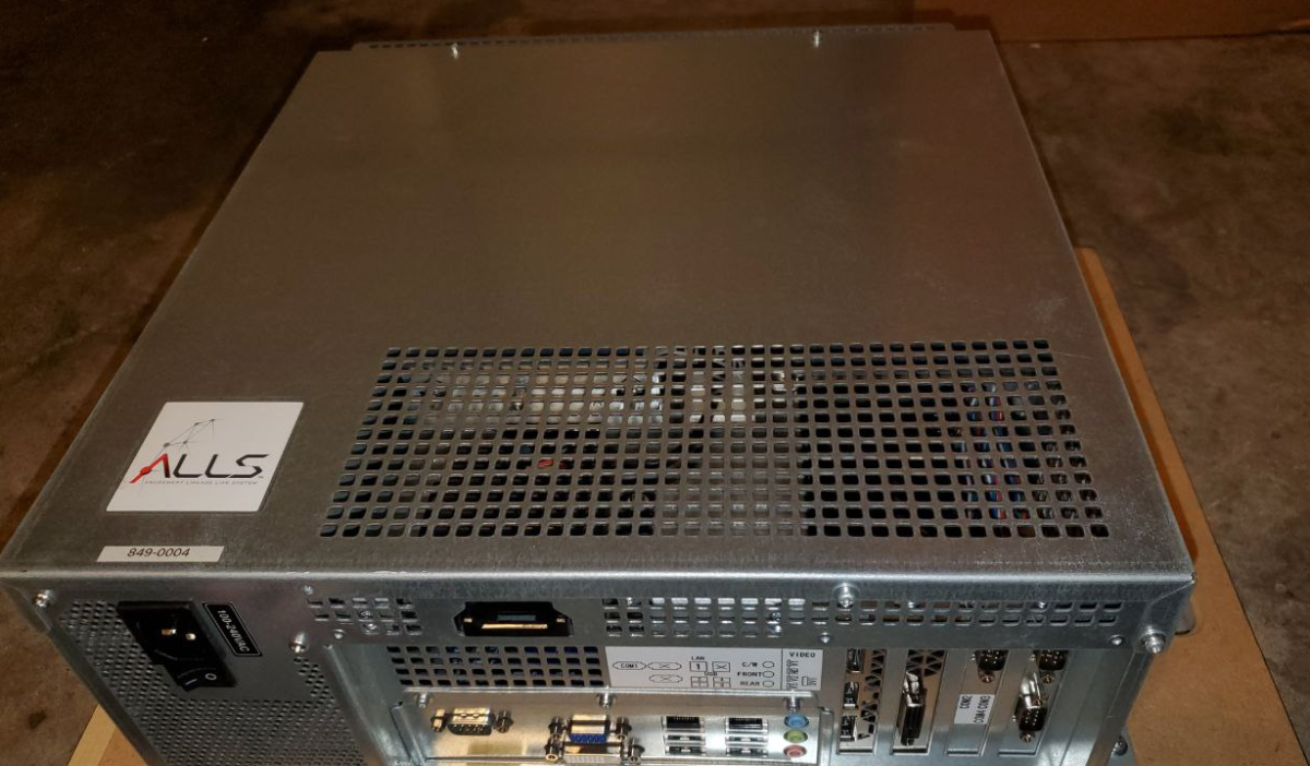

Anyone looking at buying a TTX3 should consider the ALLS UX instead... it's going for $100 more on Yahoo JP Auction (under $300 preship) for way better specs. Just use it as a PC w/ Steam like Aurich and I have suggested here. You'll also get whatever online play the Steam games come with. They are superior versions to the arcade rips. To me, the TTX3 hardware is just a really really old PC that's a mess to upgrade to make it bearable. The form factor is the biggest selling point. You might as well get a PC that's more modern and flexible that fits in the same space.
And if you really want to play the TTX3 games you can use whatever PC loader anyways.
https://auctions.yahoo.co.jp/closed...tf-8&aq=-1&oq=&sc_i=&exflg=&p=alls+ux&x=0&y=0
Several closed listings under $300.
i5-6500
16GB Ram
1070GTX
Typically 2SSD's included you can reformat if you don't want to keep the ALLS UX software
I expect these won't stay affordable for long considering that's less than the value of the included GPU itself. The ALLS UX hardware will still get dated at some point but at least you'll have a better experience in the meantime.

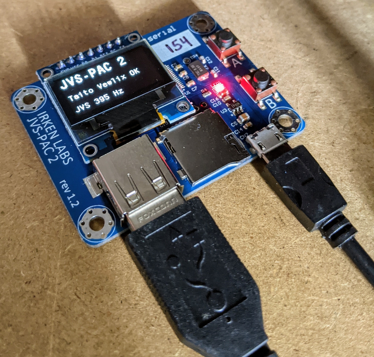

I don't recommend Brooks...
Being USB they can (and will) swap positions randomly at Windows boot.
Aka player 1 side becomes 2 etc.
Sure you can just remap the keys in MAME...
Every god damn time it happens? NO!:cursing:
Get a JVS wired cab and a JVSPAC2, done/perfect/not subject to the swap issue.

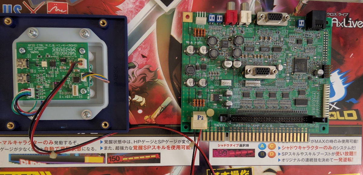

Sometimes when you purchase a used Vewlix you "get lucky" and already have a JVS IO installed (with or without JVS PSU).
Out of the three cabs I purchased, one had a JVS (the other was a Fast IO and the 3rd was totally empty).
Fast IO with Nesica card reader I removed and sold...
If you happen to get a empty cab its totally your choice how to wire the control panel.
But as I stated above, I highly recommend you steer clear of the Brooks boards (think singular USB/device for both players to block swapping).
That really only leaves two choices remaining, JVS IO or Fast IO.
Fast is only needed for X2/3/4 systems, if you go PC (also recommended) you'll have no use for it.
PC's/MAME will play perfectly with JVS IO, you only need this little device (JVSPAC2).
