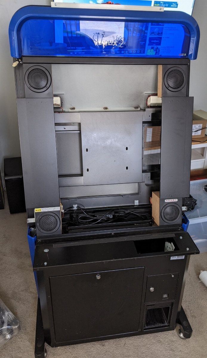

Are the monitors for the Vewlix cab easy to rotate or something you have to do by hand when you open the cab? (like a monitor on a stand that you easily rotate or you have to open the cab and rotate it from the inside)
  1. You have to remove the upper side plastics (three screws each, 6 total).
  2. You have to remove the two speaker bezels (4 screws each, 8 total).
  3. You have to remove the upper and lower brackets (3 screws each, 6 total).
  4. You have to open/remove the back monitor panel (2 screws).
  5. You have to unbolt the LCD (6 bolts).
Rotate the LCD and repeat steps above in reverse.
I consider myself fast/well versed in the process, and it takes me about 20~40mins to rotate one.
For the first time, expect more like 1 hour (lesions learned, like don't drop the upper side plastic screw down into the lower plastic compartment else you have to remove the entire leg from the cab to get it back)

@DJKNITEX I found a image for you, this is from when I moved my cabs.
I pulled the screen, side panels (for safety that one) coin box and control panels to make them as light as possible.

And yes, rotating a Vewlix is a major PITA. It is a 30-minute job indeed, but not something you'll want to do on a whim.
Looking into buying a second one just for that reason.
