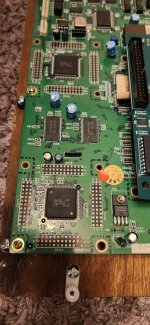

Currently am using a Sandisk 16GB microSD card that I formatted to FAT32 and the game pack is the Darksoft 2023 version. Using an original JP bios. Soldered on the reset wire and audio wire. Board currently does not have a 2032 battery installed but thought that would just mean it couldn't save settings/high scores. Is there anything else I should check before seeing about reflowing the SHC2 IC's? I feel like I'm alright at soldering but haven't done much surface mount work and don't have a hot air station.

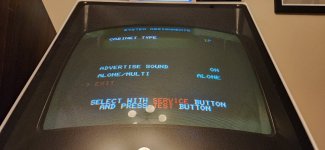

Did you see the instructions? You need to checage cabinet type between some games. Also there is a special test menu if you keep pressed the the test button while booting. This special menu will test in detail the SH2 MASTER and SLAVE.

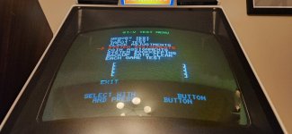

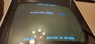

I did see the test menu and the dual cpu test shows good

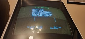

I did also check and I think the issue is that the game isn't showing up in the test menu, this is when I loaded up Winter Heat.
That's in theory good, but very often eventhough it shows good, both SH2 need a resolder.

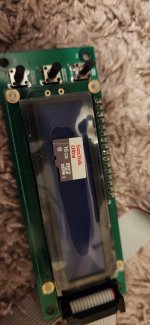

OK, can you send a picture of your microsd?
that would be compatible with what I mentioned before from the instructions. Change the cabinet type between 1P and 2P.
That microsd is OK. Problem must be the mobo. Can you try a different one or rework the 2x SH2 on yours? Send a picture of your multi installed as well please.
Can definitely see if there's another ST-V mobo around here to try. Might have to look up reworking the SH2, I'm not used to traces that small, lol.

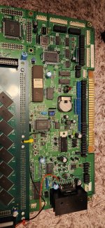

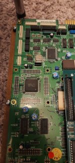

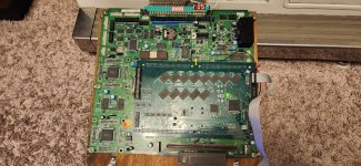

Here are some pics of my setup.
That looks OK. Try another mobo and make sure that you have 5V not on the Jamma edge but where multi is.

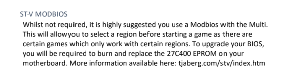

So update to my situation, actually sent my board out to I Repair Sega to reflow the SH2 processors, which he did so they shouldn't be an issue ever with this board. However it looks like the issue was really my BIOS. The board had a Japanese BIOS installed, actually purchased it on my last trip to Japan, but when using the Modbios every game I try boots now.
Which is fine for me but I thought from reading the installation manual that Modbios was optional, since not every game will boot on every bios version.
Actually googled my JP rom's number and apparently someone had this issue with the older version of the multi
I was in touch with Ken and looks like that was the culprit.
