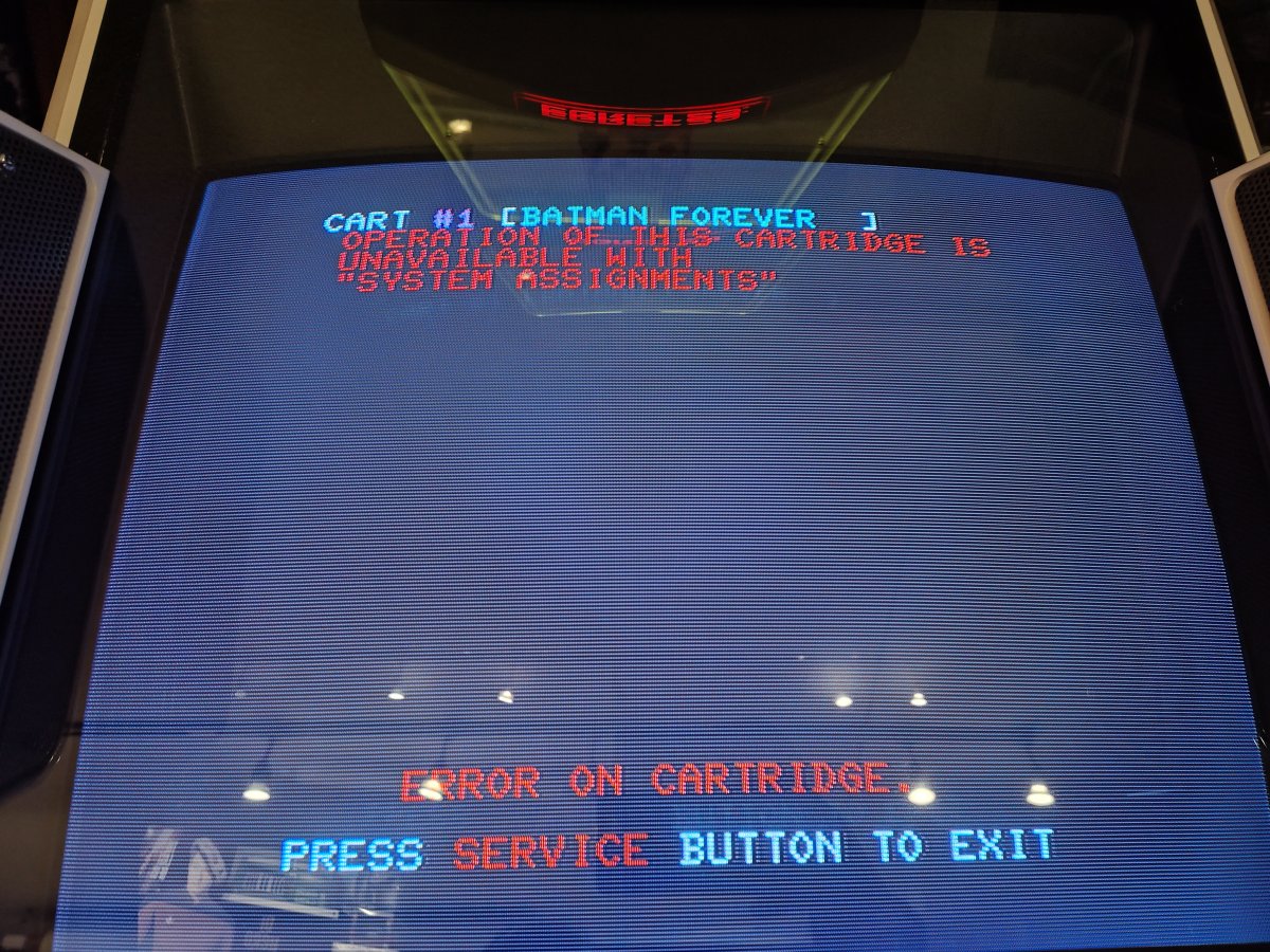

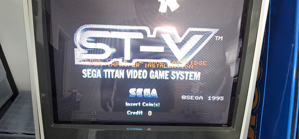

So I recently got my Batman sound PCB but I can't get Batman to play on this multi.
I get this screen:
My System Assignments are set to 2P and Horzontal, which I'd assume are correct for this game.
This is the only game that's giving me issue other games work. I've tried a handful of other games and they all work.
I've tried a new SD card and I've even tried a different ST-V mobo and the same issue persists
What am I missing?

it migh be 1 player. try that
I tried 1P, 3P, and 4P also. same result. and I tried every combination of player while in vertical mode just for good measure. still no change.

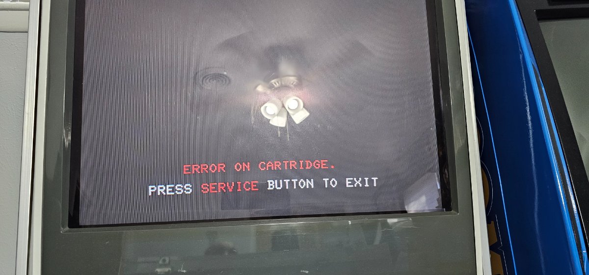

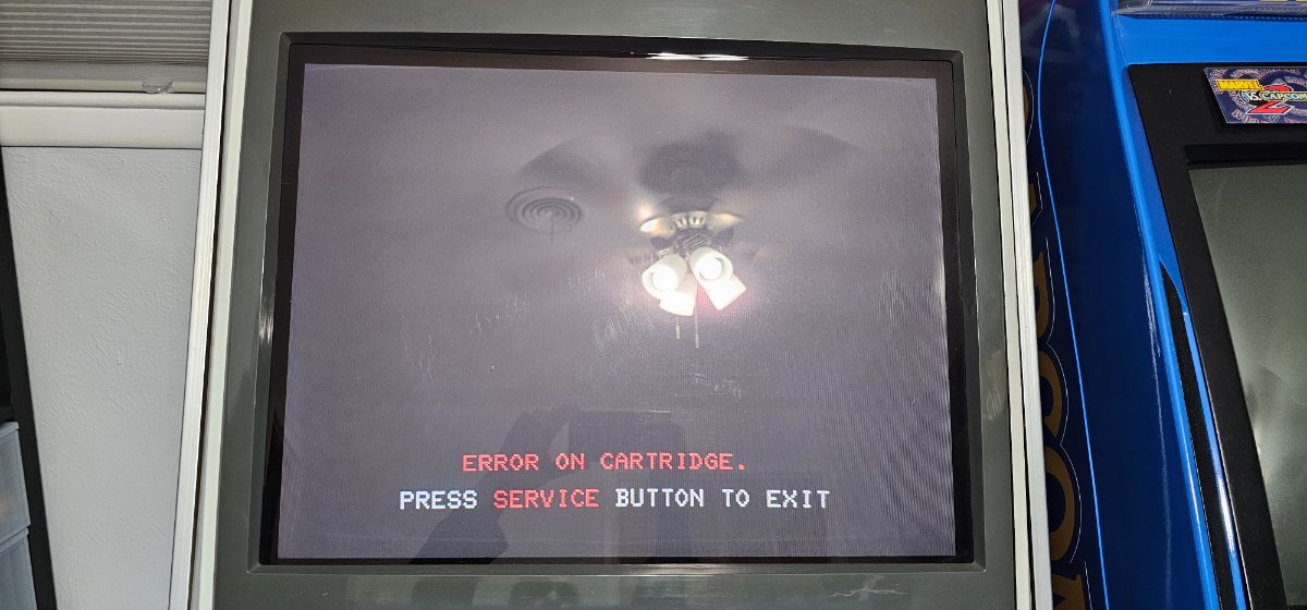

I just got my stv board and dark knight edition. I have everything hooked up but I keep getting a bad cart error. i have taken the board off and tried an original cart and everything works. when i replace the darksoft ot says error and asks me to press service button and it just goes to the sega stv 3d splash screen. has anyone seen this?

What are your dip switches set to. Put them all back to default and see if that helps?
Also press the system/test button and check the settings in there.
Just shotgunning ideas, perhaps someone else’s has most solid steps to a solution.

I downloaded the stv manual and the jumpers are set to the default. I got in the test menu but didn't see any settings I thought would effect this. any specific setting i should check?
Not really. Just the cabinet assignment stuff if it’s accessible.
You have loaded a game right? What happens when you load a game?

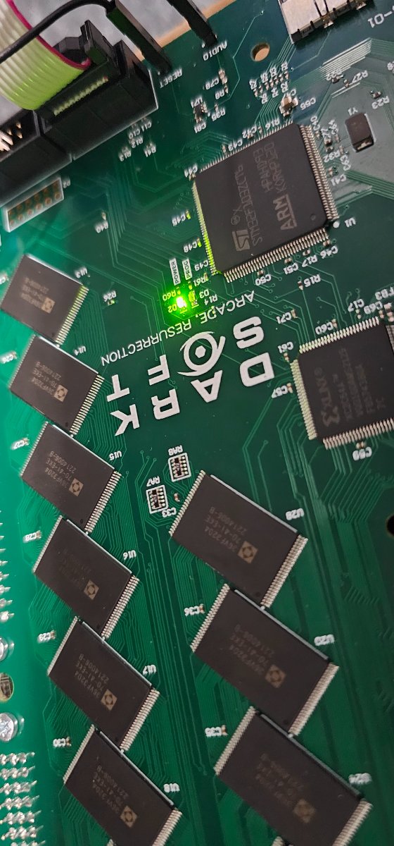

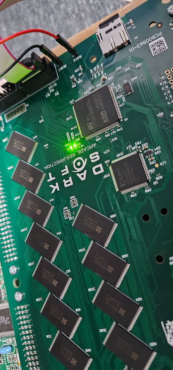

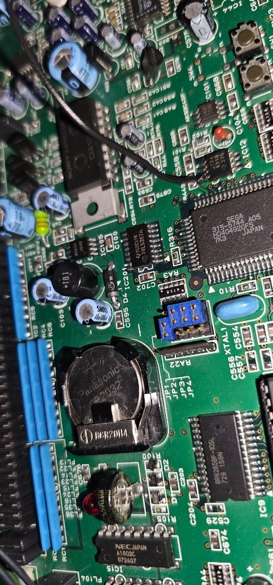

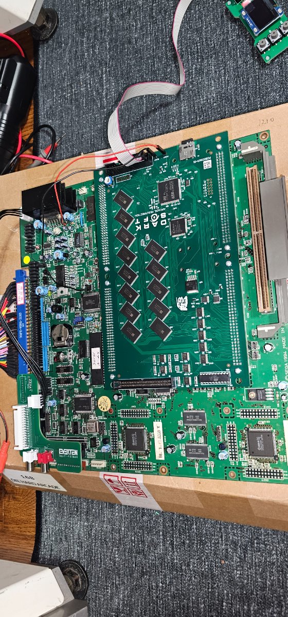

here are some pics of my board
