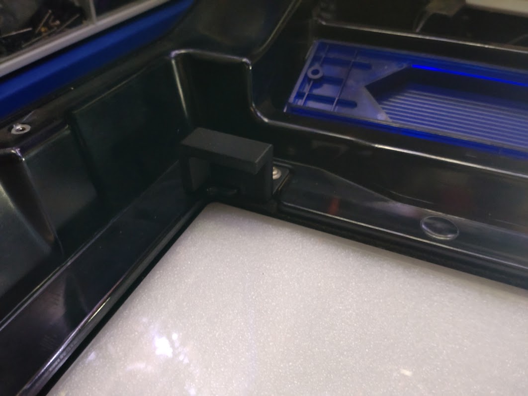

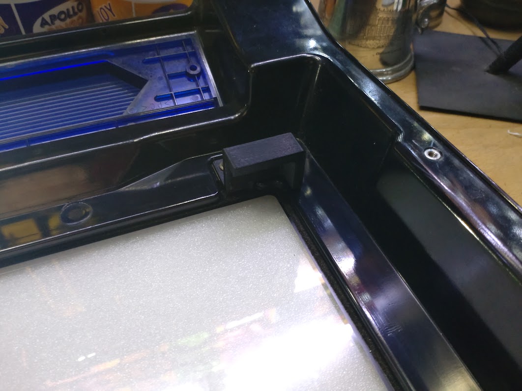

As I don't have a 3d printer I enlisted the help of @FrancoB & as always he has done a excellent job I just need to get a Ultragear now ;)

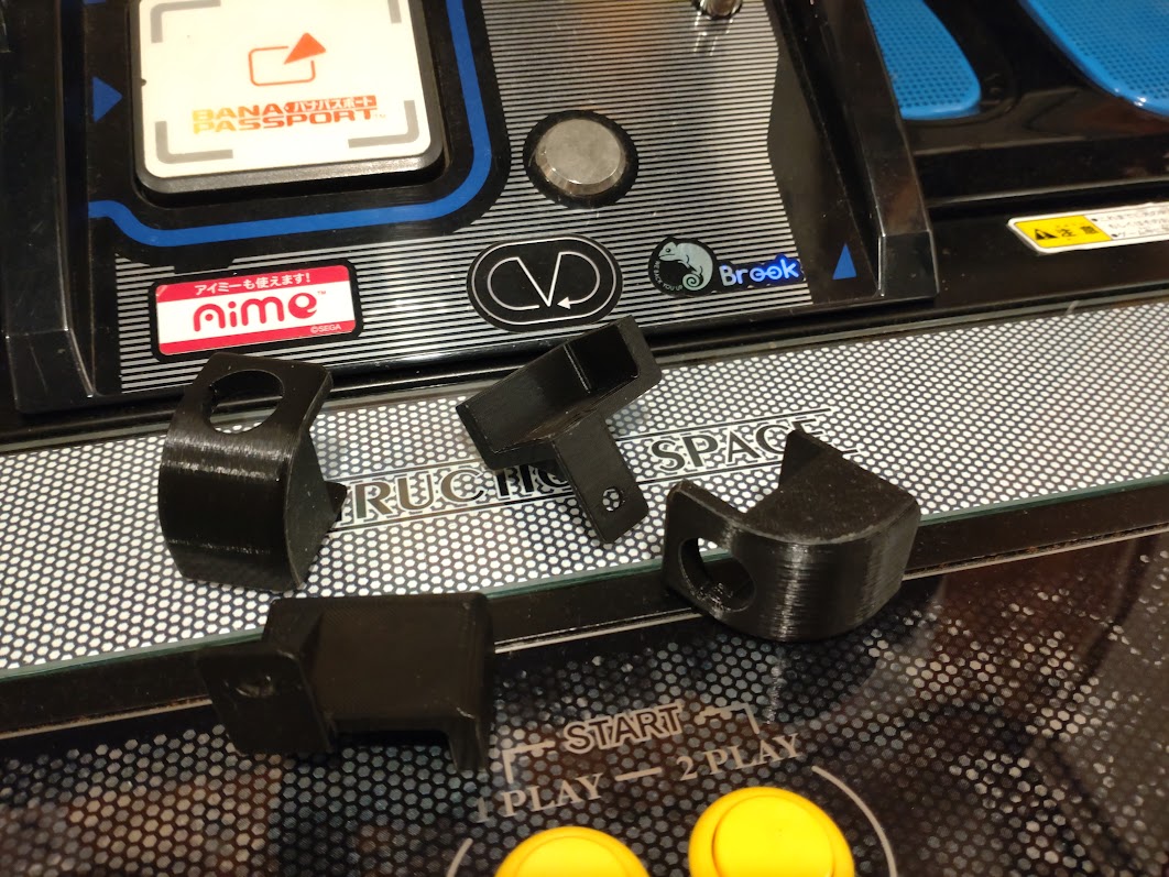

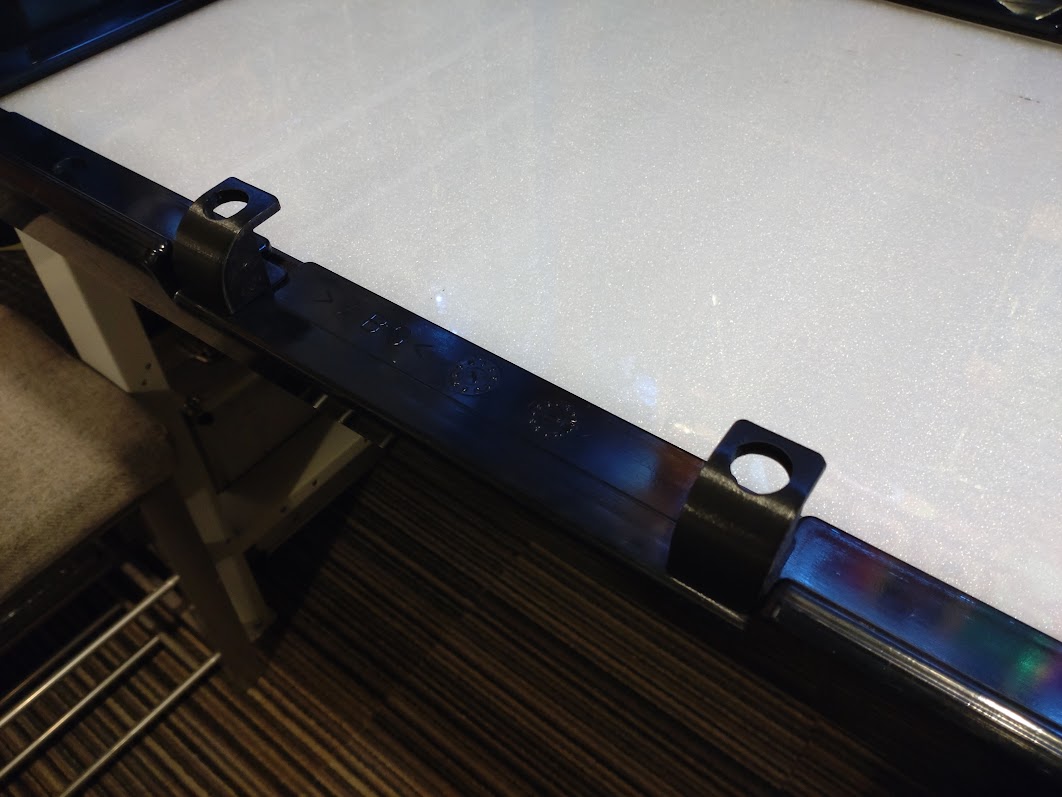

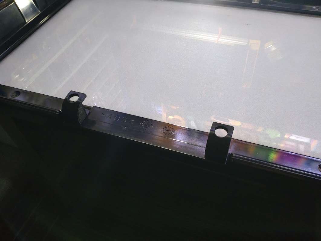

All arrived today excellent design & prints just need the monitor now ;) thanks again @jermz1 & @FrancoB
