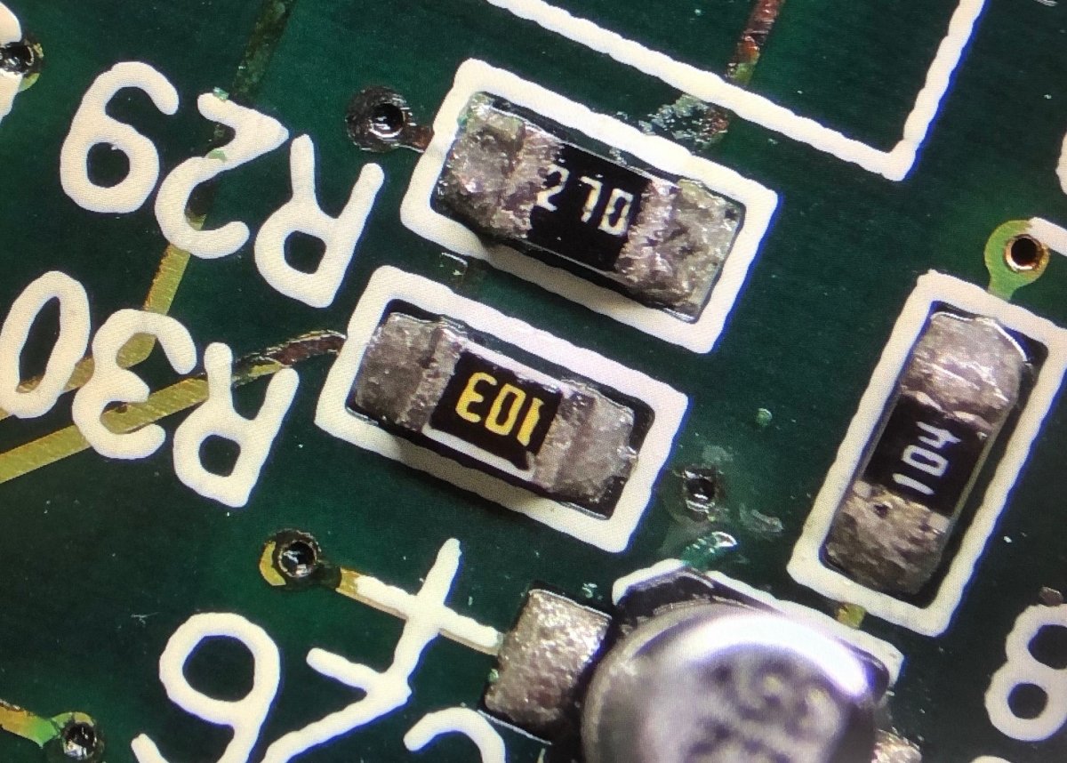

OK, now that I am making headway with the caps, these SMD's at R29 and R30. Are they critical to the pcb working and what is their function? There are a couple traces between them that are not making a connection. Was considering replacing them and patching the connection(s if necessary). How do you spec them for ordering from somewhere like Digi-key?
yeah definitely meter out and confirm any and all suspect traces.
as for SMD resistors, I HIGHLY recommend buying yourself a "sample book" or two: https://www.amazon.com/Yobett-Value...jbGlja1JlZGlyZWN0JmRvTm90TG9nQ2xpY2s9dHJ1ZQ==
it's only a few bucks more than buying a handful of resistors once you've paid for shipping and it's nice to have available when you need one.
just make sure you're buying the right (dimensional) size since SMD caps come in many sizes. https://www.newmatik.com/knowledge-base/KB-EN-00928/resistor-case-sizes
Thanks for the link(s)- placed an order for the 'sample book". Gotta love Amazon, should be here tomorrow. Yes, I have a couple traces in this area that are bad. Any specific type wire to patch these, or just the tiniest I can find? As far as the vias go, do I just do the same "cleaning" I have done with the caps, etc? So far, those are all making connections, but if I run into one that's not, is it the same "patching" as the trace work- run a tiny wire from the via to wherever it goes?
