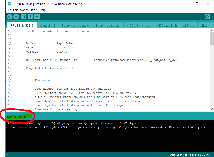

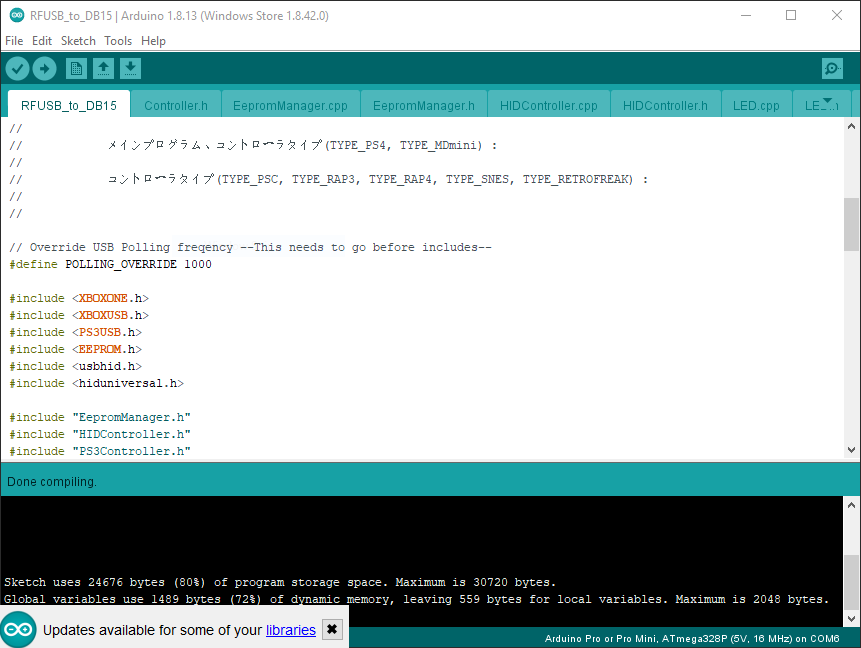

Hello, I'm trying to build the USB2DB15 using Arduino Pro Mini, but I'm stuck after programming the Arduino, before wiring everything I would like to test if the Arduino and the USB shield can recognize the USB controller, but the serial monitor in Arduino IDE is not showing anything.
These are the steps I have done so far:
1-Connect the Arduino with the FTDI programmer
2- Compilation of the USB2DB15 program: Ok
3-Upload to Arduino: Ok
4-Solder USB host shield to Arduino
After this step I have connected some USB controls (MadCatz Street Fighter IV Pad for X360, Hori Fightstick mini for PS3 and 8bitdo usb receiver) to the USB Shield while the Arduino is still connected to the FTDI programmer (and this to the PC via mini USB), I have opened the serial monitor but it does not register anything when I press the buttons.
Is this the proper way to test or am I doing it wrong?

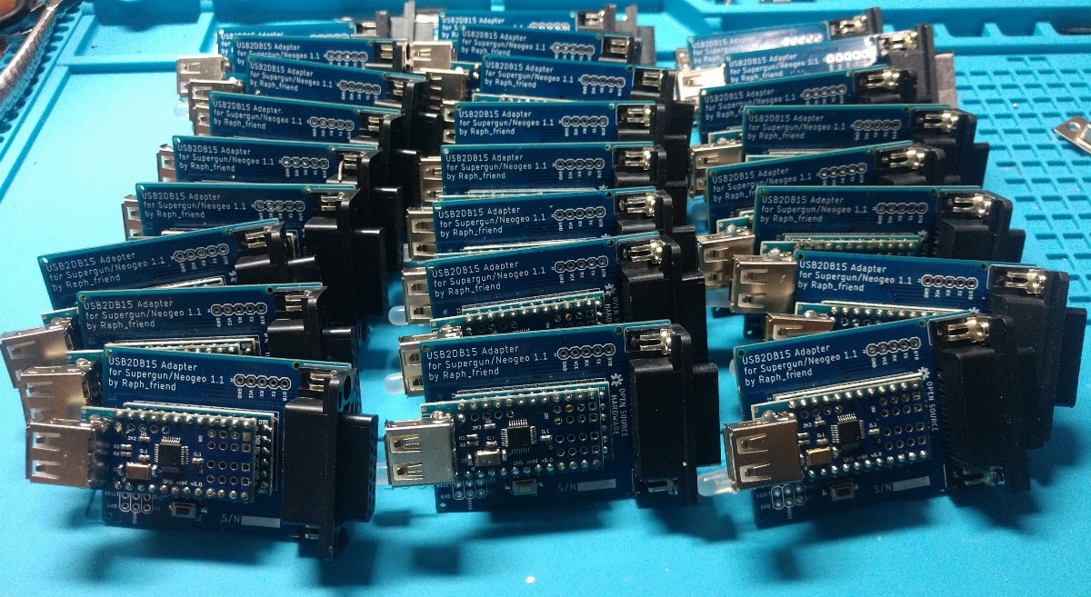

This is the USB2DB15 3rd batch, that is 4 times bigger than the last one and took me some time to finish, but thanks God everything is good now and ready for shipment. The packages part are the worst for me, but let's do it! Thanks everyone of the support!
The pre-order for 4th batch is already open, if you need, just DM me here, Discord, or twitter.
