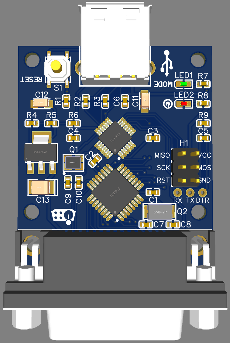

A reset button that resets all profiles and mappings has also been implemented alongside a status LED to provide visual feedback regarding being in button mapping mode, which profile is selected and to indicate when reset is pressed.
The PCB is being finalised too and will be ordered soon...

Now we got LED status implemented!
[0.13.0] - 2020-09-12
Added
- Added a new LED class to control an LED connected to digital pin 8.
- LED::On(); Turns the LED ON
- LED::Off(): Turns the LED OFF
- LED::Blink(n); Blinks the LED where n equals the number of desired blinks
- The LED is set to turn ON when Bind mode is entered and remains on until Bind mode is exited, thus turning the LED OFF.
- The LED will blink with a profile change and blinks an amount of times that corresponds to the profile number.
- Added a resetEEPROM() function that clears all EEPROM memory, thus clearing profiles and bindings. This is controlled via a tactile switch connected to analog pin 6.

A lot of people are working hard behind the scenes and spending their time & money to provide the best product we all can, for FREE! Relax, wait and enjoy the ride.
Core functionality is becoming solid. We already have profiles, custom button mapping, a status LED and reset button nailed down. The code is super clean and organised too, even things that were working but coded in an less than ideal manner have been completely overhauled and reworked. This all takes time, no shortcuts just solid code that won't break.
Compatibility is the next target and we've already made solid progress. All of my test controllers barring one (cheap Chinese Honcam stick) are now all working and we have the data necessary to make most of the others work.

Will it for in the tight spaces that superguns db15 ports sometimes have? Is there a 3d printed case? Is there a donation box?
Frank_fjs
Multi Boyz 4 Lyfe
Legendary
Multi Boyz
Mar 3, 2018
3,431
5,800
Australia - Adelaide
The PCB is 40mm wide, the same width as the DB15 connector, so it will fit in tight spaces.
Still need to design a 3D printed case, that will come last though.
