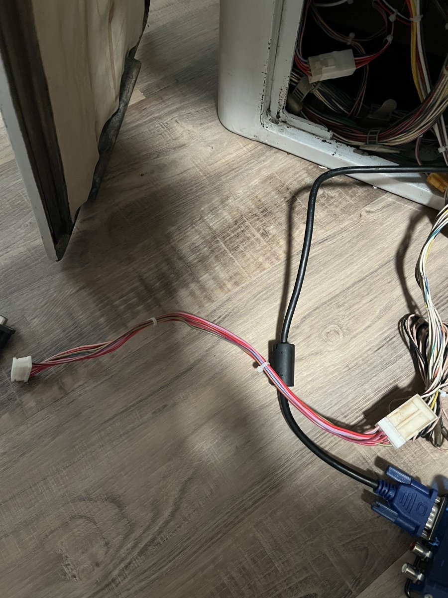

I heard about the rs485 as a suggestion to connect a pc to an Astro city. I have a Sega io and wanted to hook it up to a pc.
Edit :
That's false. The Sega IO has support for nine buttons and works fine with any Capcom fighting game.
note that the sega io won't provide the cps2 kck harness port and supports for 6buttons games like CvS2, SFZero3 etc, you will need the capcom converter for that.
is your astro jamma only or do you have usb encoders for inputs?
Thank a for the help.
I have a kick harness and am gonna get a jpac from a friend.
