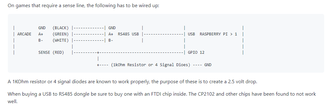

I need help with troubleshooting the openjvs to triforce type 1 connection
- I use openjvs (current version) in a wipi setup. - this runs nice in my noami setup (= it is working)
- I used a DSD Tech FT 232 USB adapter
- If i plug the "USB" cable into a Triforce Type1 and boot it the screen stays black (no boot animation, no sound). Right after disconnection i get a boot screen
- the triforce runs fine on a normal sega JVS I/O board
Is this a known problem. How can i troubleshootg / fix this behaviour?
Thanks alot
mR_CaESaR
Jul 10, 2018
1,170
1,591
Sydney, Australia
https://github.com/OpenJVS/OpenJVS/blob/master/docs/guide.md
