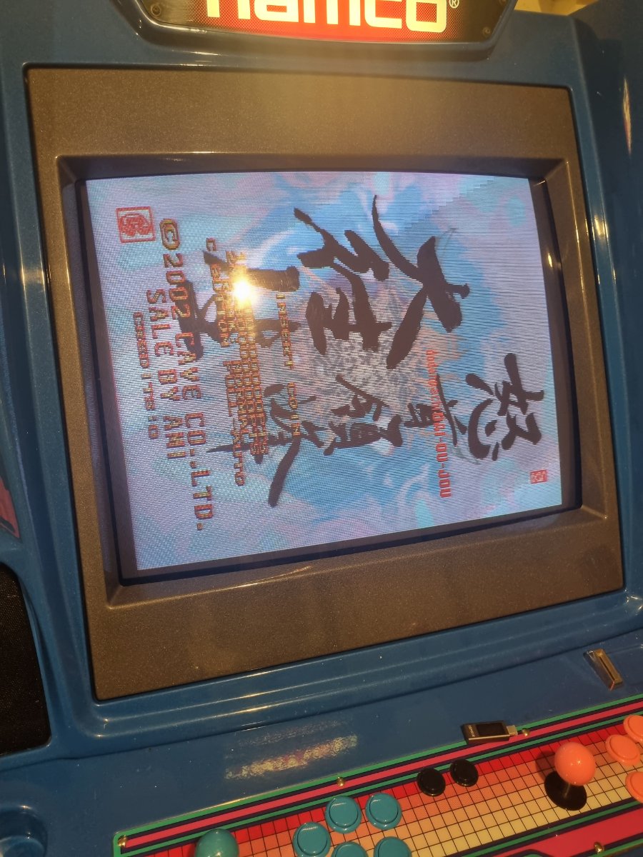

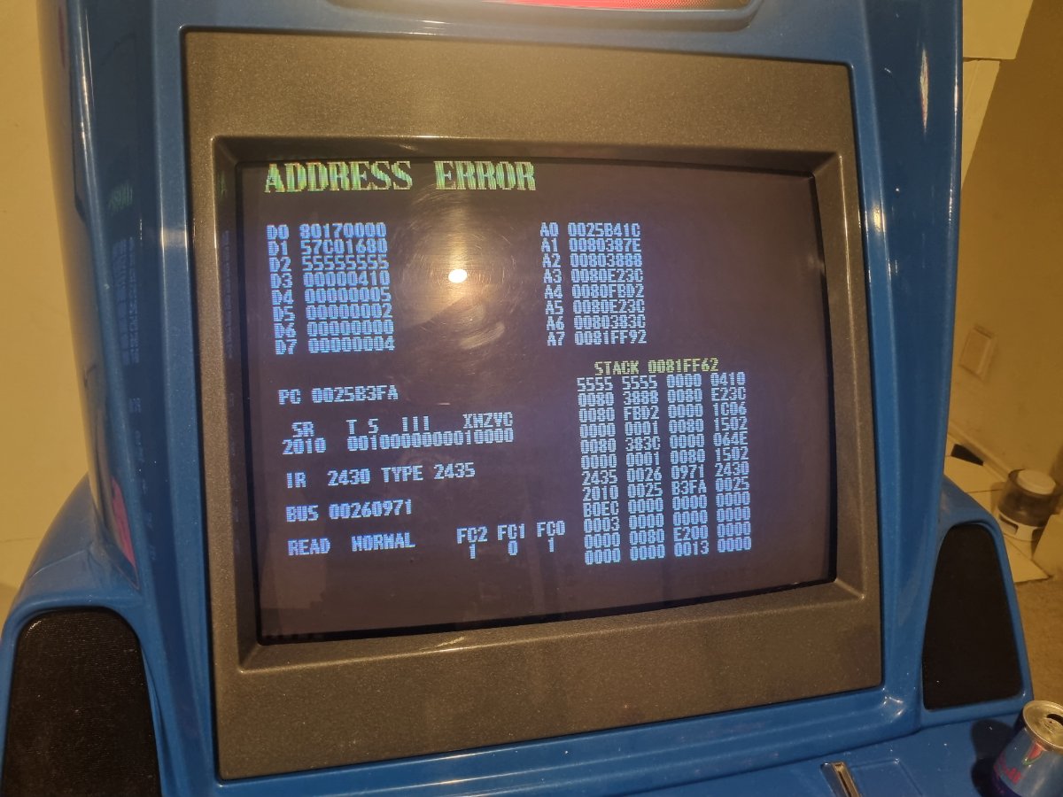

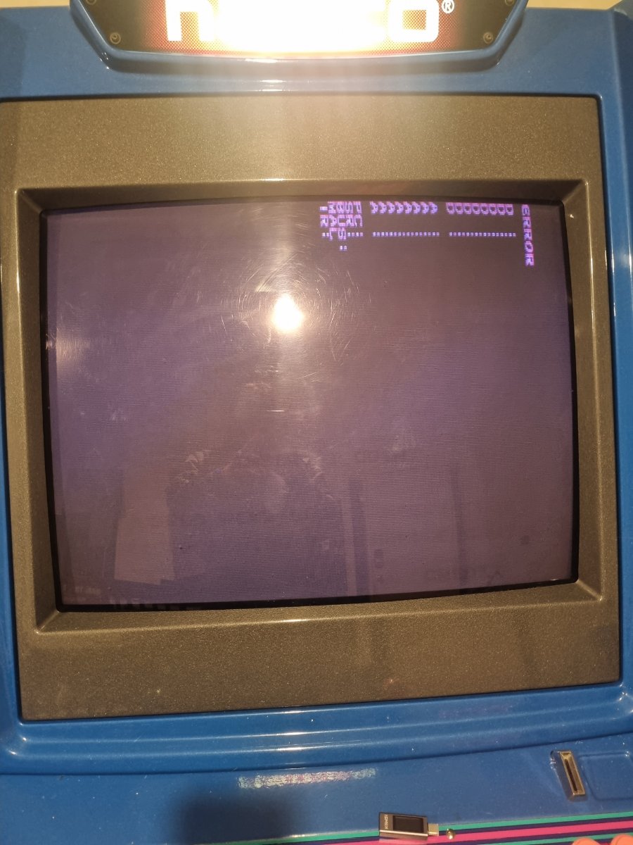

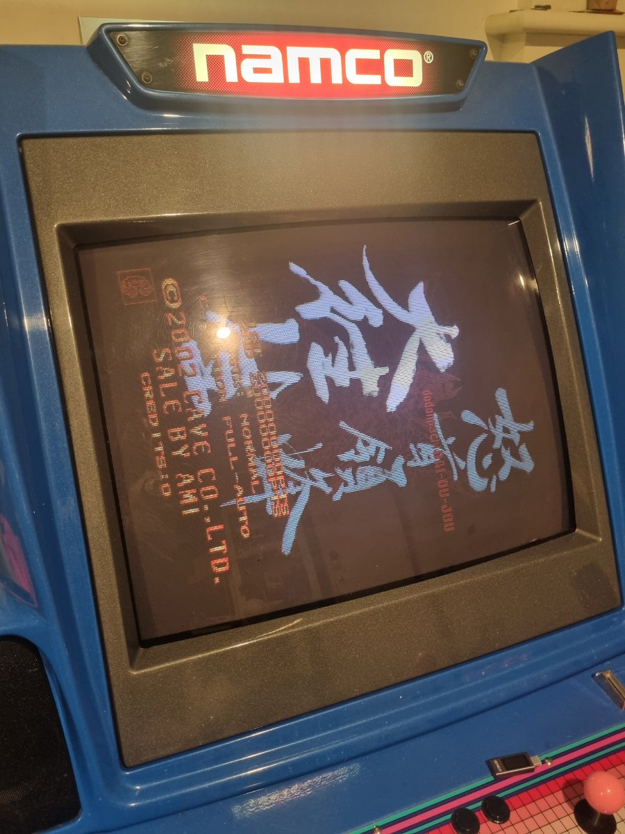

Interesting, Dip 8 was on, I get the first picture when I try to load white lable unless I load black lable first, if I load black go into the test menu then go out and load white it works fine.
So I turned Dip 8 off now I get the first picture if I load white lable and the second picture if I load black both appear immediately after the "this games is for Japan only blah blah blah" screen.
So Dip 8 on I guess it has to be. Tried default on both scenarios no different.

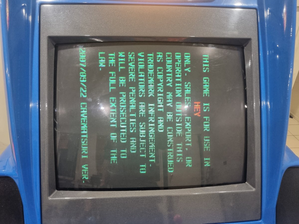

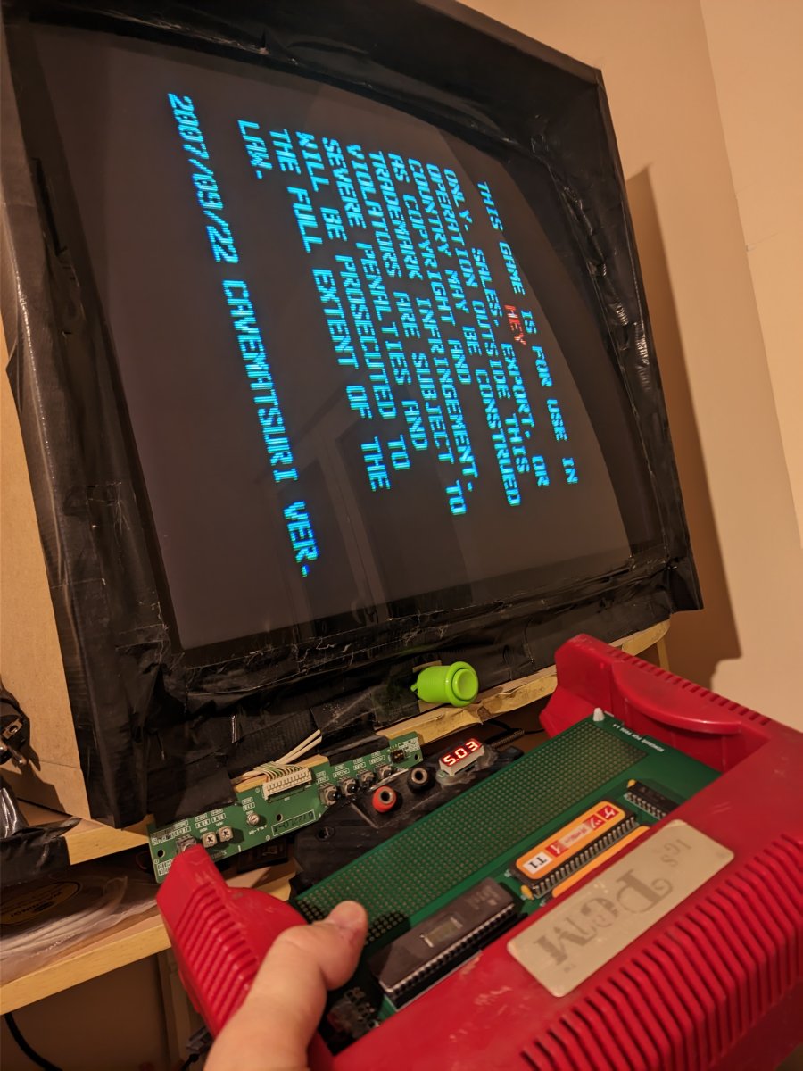

Just wrote the remix version to P1 and wanted to check that I got this right: This is the original and matsuri versions selectable via J2 but I need to use the u5 gal in the archive?

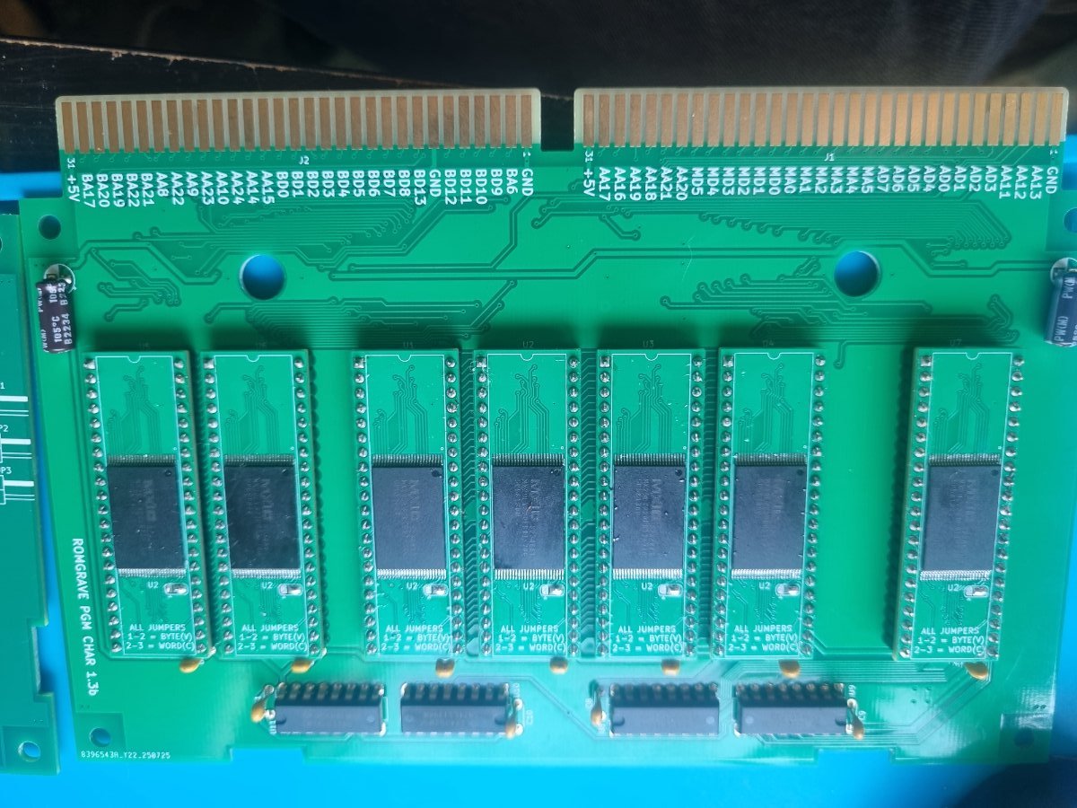

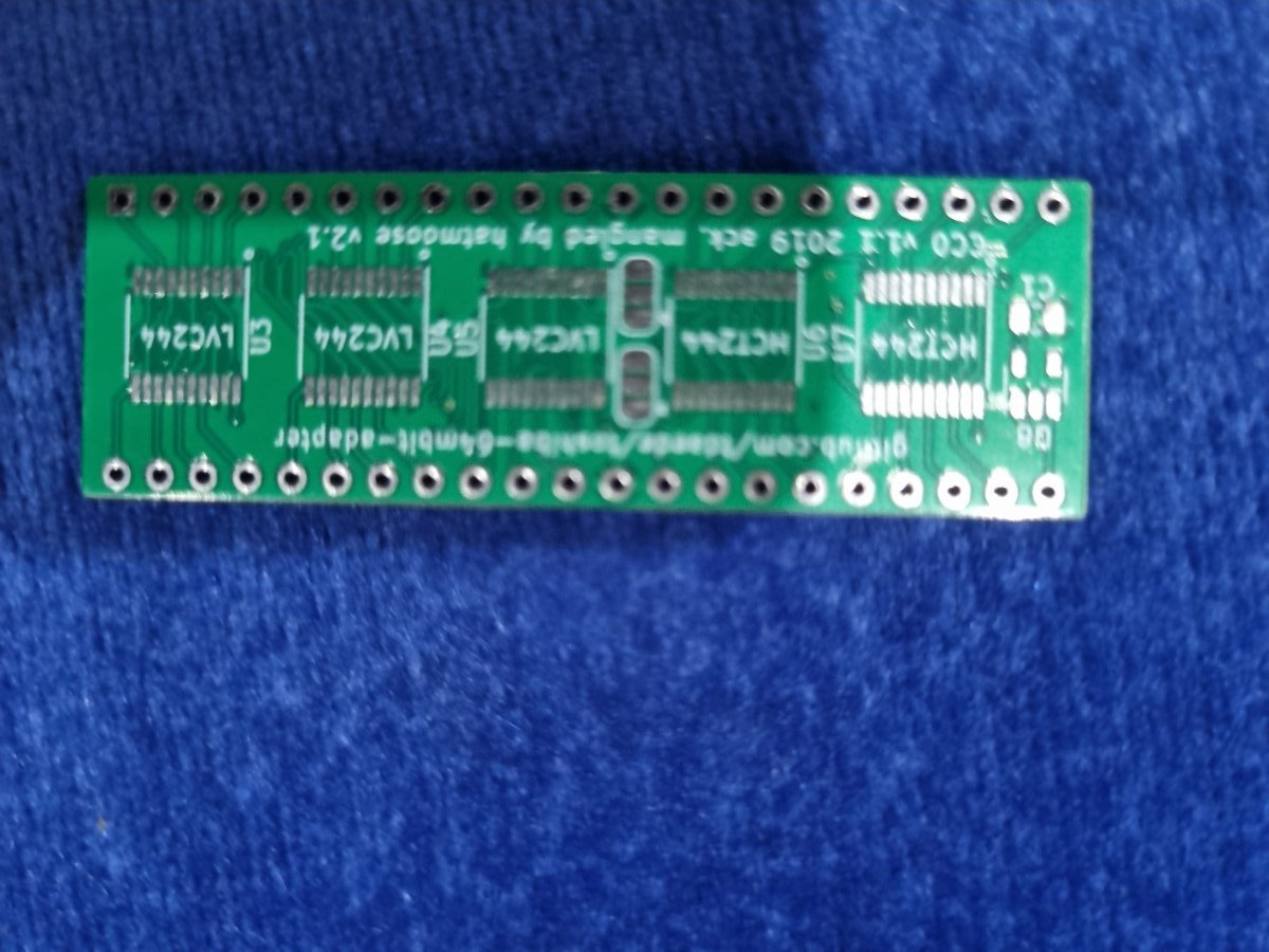

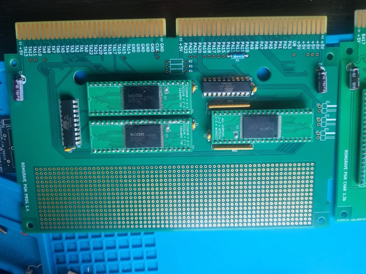

Another option for building these. Some guys have used these for MVS conversations, with a jumper setting change they work perfectly for fluffy carts too. It's not quick and as a single cart not really cheaper either. As a set of it would work out about the same for parts but still much slower to build.
Build up the adapters and then once the NOR flash is soldered verify them as a 27c322 to check they are good before soldering. Make sure you verify them without checking for a chip ID. Using pin header legs means these won't fit into a standard dip socket easily.
If they don't verify correctly its probably the soldering on the TSOP48.
This cart Is working as it should.
