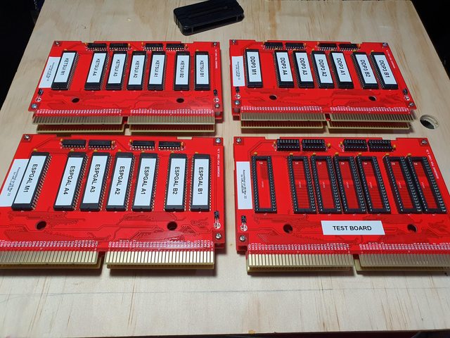

, I got my boards today and decided in the end to make one of my boards into a test board also. I didn't have the mojo in me to de-solder an eprom or two if one wasn't working. I'll pull the sockets off it one day later on when I get a mechanical de-soldering gun.

Sent something "test board" related to the boyz, hopefully it's decent and we've got another game unlocked....
