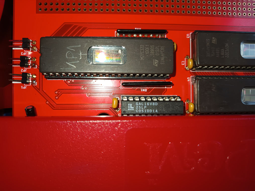

Has anyone used GAL16V8D with this project? The datasheet seems to have the pull ups shown in the diagram but I'm not an expert on the matter.
Yep. I've used GAL16VD on mine
https://www.arcade-projects.com/thr...ssembly-and-troubleshooting.10015/post-317834
Here's the gals I have installed

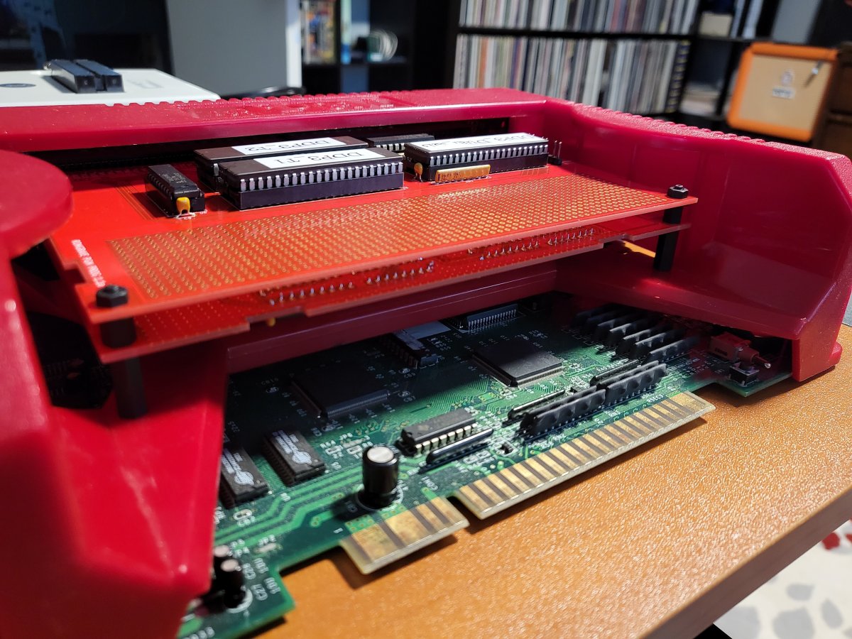

Also, shoutout to everyone recommending standoffs. I went 1 step further and added a pair of supports so if the motherboard is flat, the PCBs are level. It's not attached to the motherboard, just rests perfectly on the case of it. It's a 15mm standoff fwiw.
