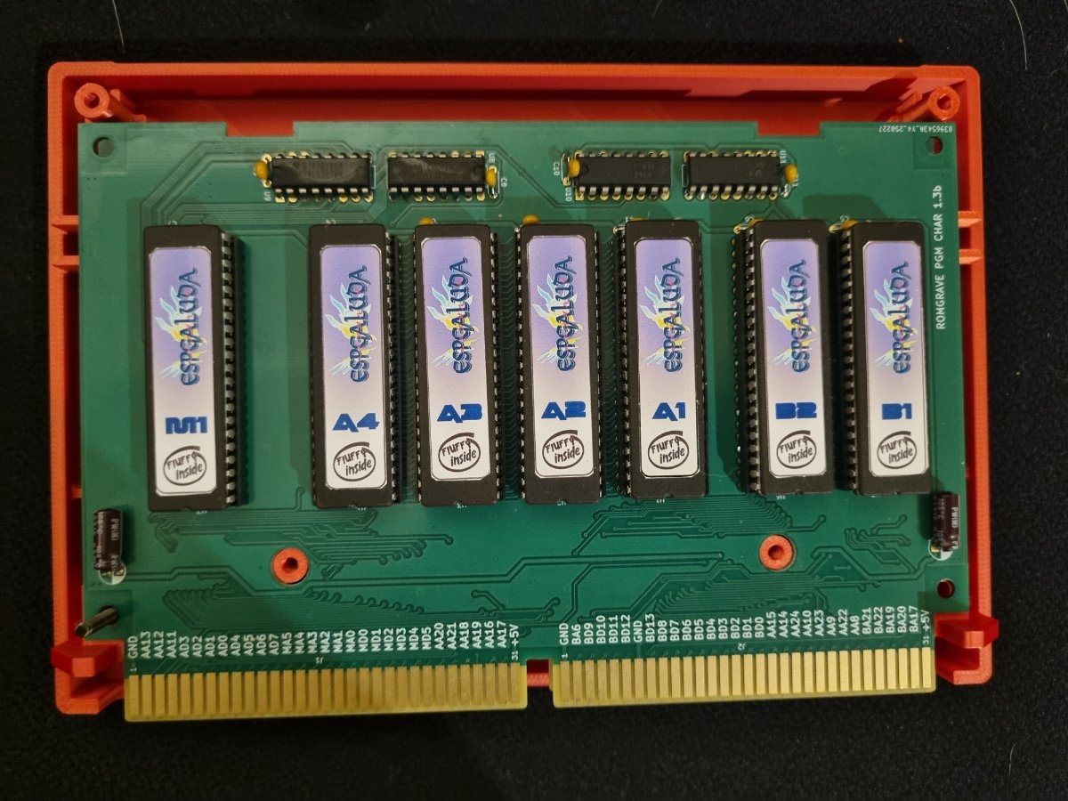

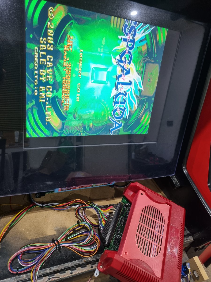

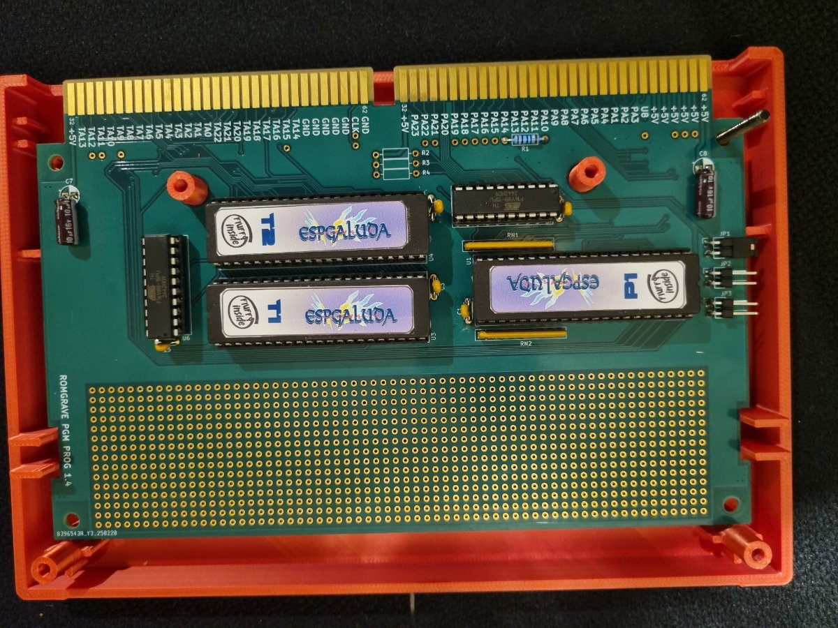

Just a quick note to thank @Fluffy for his beautiful pcb design. The first fully socketed cart went together easily. Even if it did remind me why I mainly use SMD components. I still thoroughly enjoyed the build. Game booted first go. Thanks again.
