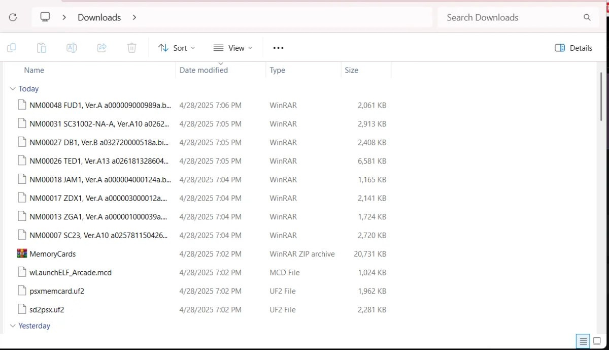

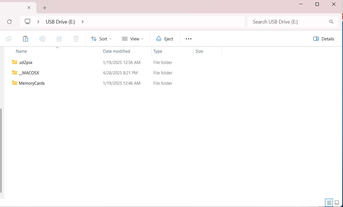

My SD2PSX just arrived, and I'm stuck on this part. I deployed the civ.bin successfully to the memory card, but I don't know where to place the dongles as well as the wLaunchElf_Arcade.mcd file.
EDIT: I downloaded the pre-built SD cards and put them on the micro SD card, but anytime I try to power it up, I just hear three beeps and a stuttering sound.

did you set teh card on arcade mode?
