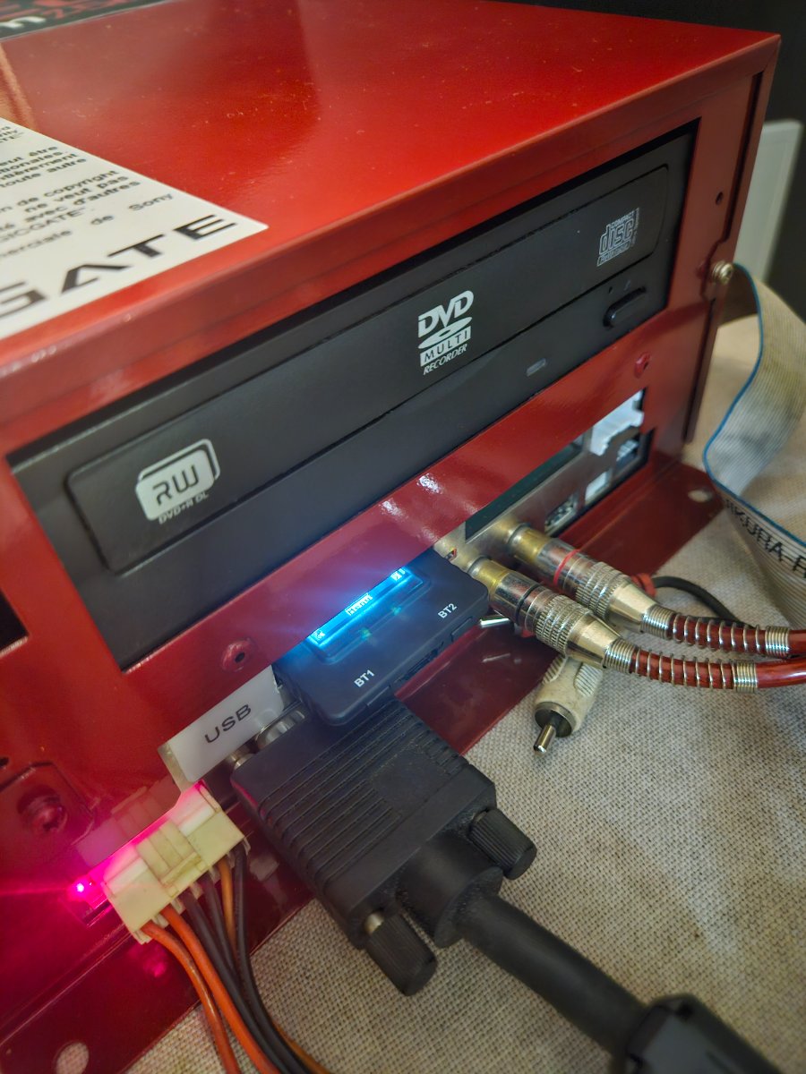

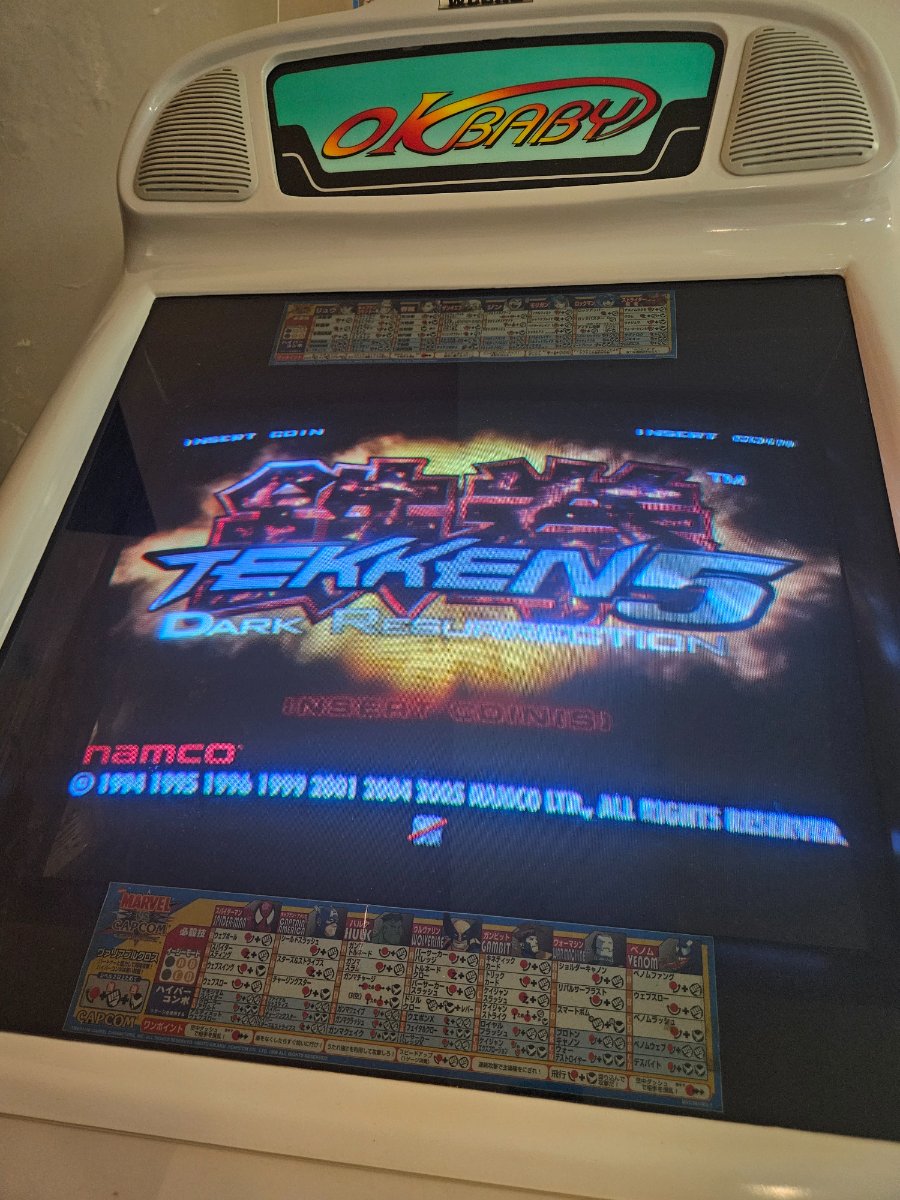

Thank you for doing the write-up, pretty cool!This is pre-built sd card structure for 1.0.0-RC1 for SD2PS/PSXMemcardGen2 and will display the dongle name and version on the screen for easy identification.
- Instructions
_______________________________________
1. Flash sd2psxtd-1.0.0-RC1.
2. Drag and drop [MemoryCards] folder from the drag and drop package to a MicroSD card.
3. Put MicroSD into a SD2PS/PSXMemcardGen2.
4. Deploy CIV in the menu under PS2.
5. Change the variant to arcade in the menu under PS2.
6. Use as you would like.
!!!! Remember to check the compatibility and I/O requirements of the game you are trying to boot. !!!!
!!!! All dongles are pre-signed/bound to SD2PSX / PSXMemcardGen2 !!!!
!!!! Remember SD2PSX is not a micro SD card reader for PC so when deploying the civ.bin do not drag and drop the civ.bin where you drag and drop the firmware!!!!
- How to use
1 . Power externally
2. Turn autoboot off in the PS2 settings menu
3. select the dongle you want to boot
3. Remove external power
4. Put it in your namco and Boot it like a real dongle
This should be possible because of "https://www.arcade-projects.com/thr...th-arcade-magicgate-support.32371/post-451920"
!!! I have a report of this not working through a third party multitap hooked to 256, so this warning will stay here until someone who has a PSXMemcardGen2 that is sanded down and doesn't use a multi-tap on a 256 confirms it working or broken!!!

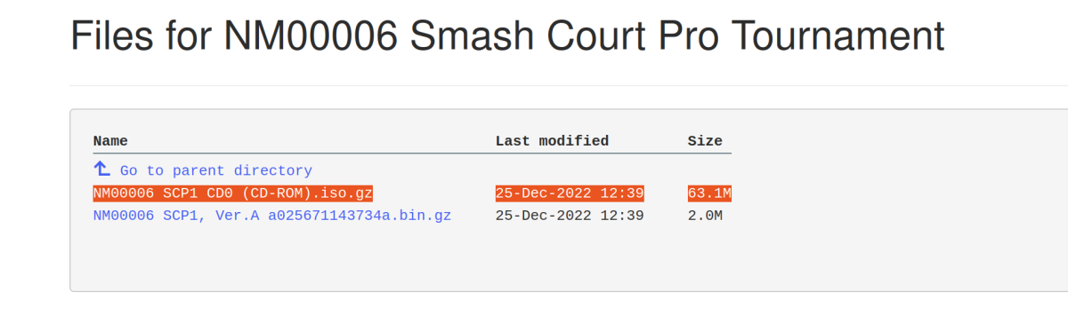

Is the BR3 an original copy? Non of the images online seem to work...
Hi!Is the BR3 an original copy? Non of the images online seem to work...
yes, I would love BR3 and one of the reasons I got the memory card for the dongle. If you could help get an image that works I would be most happy.Hi!Are you talking about the CD ?
Yes, it's an image found on the internet, but the .CUE file was missing, so it had to be recreated.
It's like the Smash Court Tennis Pro tournament file: it's not complete, it's not even 100 MB.
The guy who dumped it, I don't know what he did ?
Can anyone re-upload it in Raw or ISO format, not CHDMAN; that format is really a pain.
Thank![]()
You can find the dumps on Defor pinned postyes, I would love BR3 and one of the reasons I got the memory card for the dongle. If you could help get an image that works I would be most happy.
BR3 dosent work and if it does load it crashes.You can find the dumps on Defor pinned post

Many files in the Namco System 246/256 game web archives are incorrectly downloaded; they were dumped with their feetYou can find the dumps on Defor pinned post

Many files in the Namco System 246/256 game web archives are incorrectly downloaded; they were dumped with their feet![]()
Check this out.
I've never seen a PS2-based game zipped to 62 MB, even for a .gz iso file.
There's something missing from this Dumper game.
Check this out.
