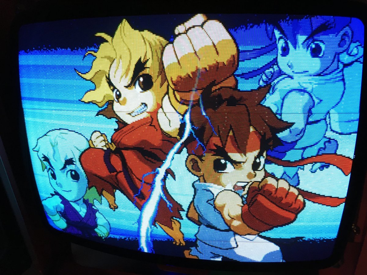

I finally got my Kortek KTN-2001 running. It works, but the video signal is noisy. CPS2 and MV1FS worked fine. However, my Meanwell PSU just chirped when I tried my Pi2JAMMA and Mister Expander. I'll probably try the resistor hack mentioned earlier to help with the load.

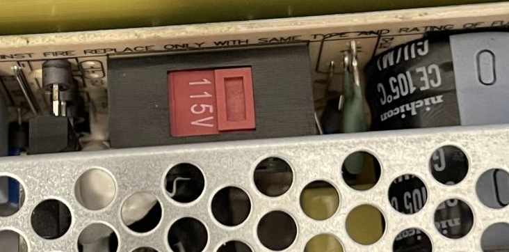

Tried powering mine up, I'm getting 120 to the switcher, but no dc voltage back out. Any suggestions? Everything I've checked seems fine, wondering if it's a dead switcher?
What switcher?
Do you mean you have no DC output on the power supply (PSU)?
If that is the issue, certain Mean-Well power supplies have a minimum load requirement to turn on.
What switcher?
The switching psu that came with the kit with buttons. I have ac voltage in, but no +5, +12, etc. I tried it with my working board plugged in, also nothing.
Did you switch the internal switch on MW from 220 default to 120volts?
Yeah, that was it. I thought I had done that prior during building, so I didn't even double check. Derp. Thanks for the tip! Board powered up, but now not getting anything on the monitor. Just need to figure that out and should be good.

Was gonna add to check the 115/230v switch :)
