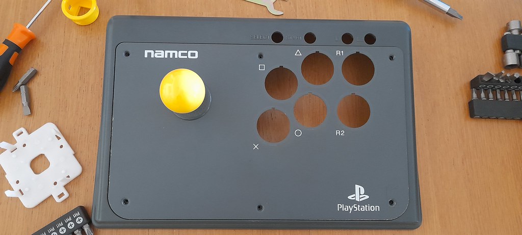

I would like to enjoy my Namco Stick on PS4 (Street Fighter 6, Fighting Ex Layer etc.) by removing everything, and adding a Brook Universal Fighting Board or similar.
I would like to ask: does exist a joystick that can be mounted in the Namco Stick without the need to drill or modify the plastic case?

You will need to desolder the buttons from the Namco pbc since they are directly soldered to the board (there is no harness, the terminals fit in solder holes). You can use whatever 30mm japanese buttons you like as long as they aren't longer than an OBSF. You may need to slightly bend the terminals when installing to get the bottom plate to sit flush on the lowest row. You can solder directly to the button terminals from the brooks pcb harness, but I would just buy a button harness with the insulated spade connectors. You have plenty of room to bend the button terminals if needed.
You can keep stock stick (and maybe do the subtle mods I mentioned), install the Brooks PBC and a USB cord going out. There is a wrap around strain relief present, you could maybe use a grommet or stick a cheap usb jack extender in there and hold in with double sided tape.
For the stock joystick, you will need to solder directly to the switches from the brook pbc harness. It's super easy and without any experience, I can't see you messing it up. Use SMD flux if you have trouble since it seems to work the best no matter the application. Tip your wires and it is painless.
Since you are not trying to install an LS-33 or JLF, this is a super easy mod. Enjoy.

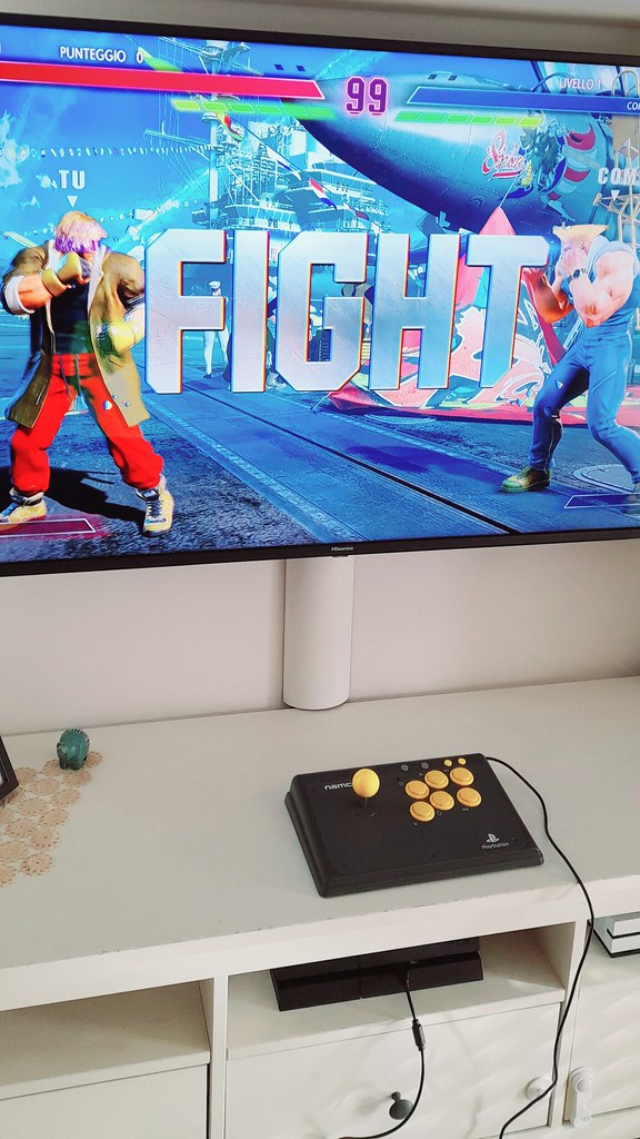

I did it! :thumbsup:
Wiring was very easy (practically solderless thanks to the microswitch change), but it was extremely difficult finding the place for the Brook PCB... really down to millimeters.
I had to use screw terminals and not the J4. The overall feel is outstanding.
Actually it's a kind of "working prototype", sooner or later I'll have to reopen it for some cable management and to wire L1 and L2 buttons. But I'm seriously afraid I won't be able to close the Namco again... =O

I changed the buttons to Seimitsu PS-15 and I really *love* the hybrid stick!
Thank you so much for your kind support!
I'll take pictures when I will have the time for a bit of cable management...
