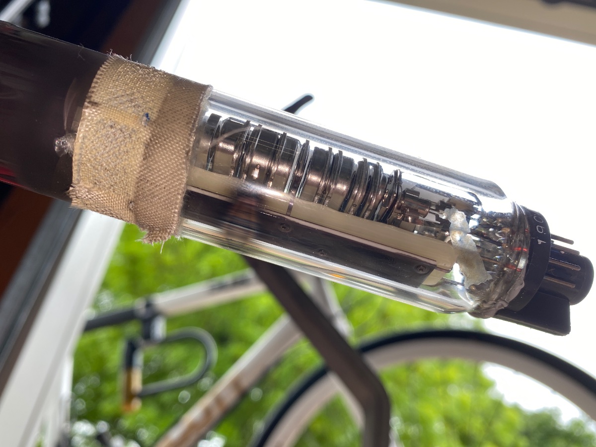

Shanghai Novel 73SX701Y22, the stock tube paired to a Sanwa 29e31s. Normally, this chassis does not fail in a spectacular fashion taking the tube with it.
No, it needs some outside help.
Insert dumbass with a beer. Beer is spilled on the control panel and the liquid flows on the remote under said panel. Monitor shut downs.
I'm like, well, shit happens.

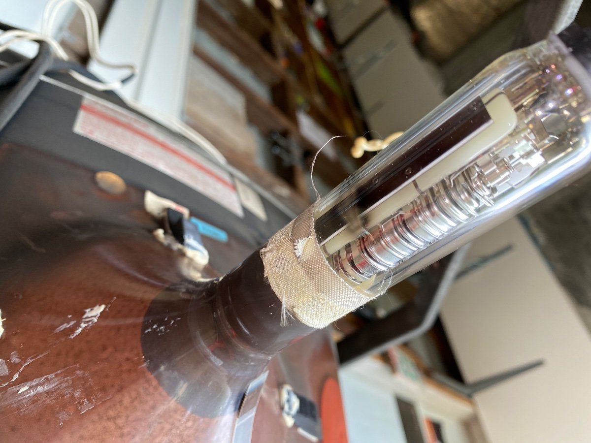

Grab a replacement chassis and remote and start removing the neck board. Wait, why is the yoke coming off?
I had no idea this was also one of these stupid tubes with the dumb voltage divider in the neck. What a way to find out!

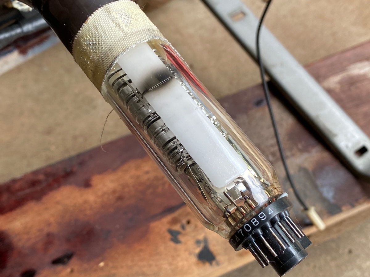

Does it actually have the star-shaped pinhole in the glass?
Reason I ask: One of the locals here bought a new net city from a seller in China. The PF worked for a short amount of time, then had the tube lose vacuum. One day he's just hanging out in his garage when he hears a loud THUD. The entire yoke and neck completely fell off. He brings the remains in and the monitor looks like it's been through the ocean, horrible condition overall, and no pinhole--just a clean break.
We are thinking that through being mishandled and international shipping, the weight of the yoke caused the neck to snap.

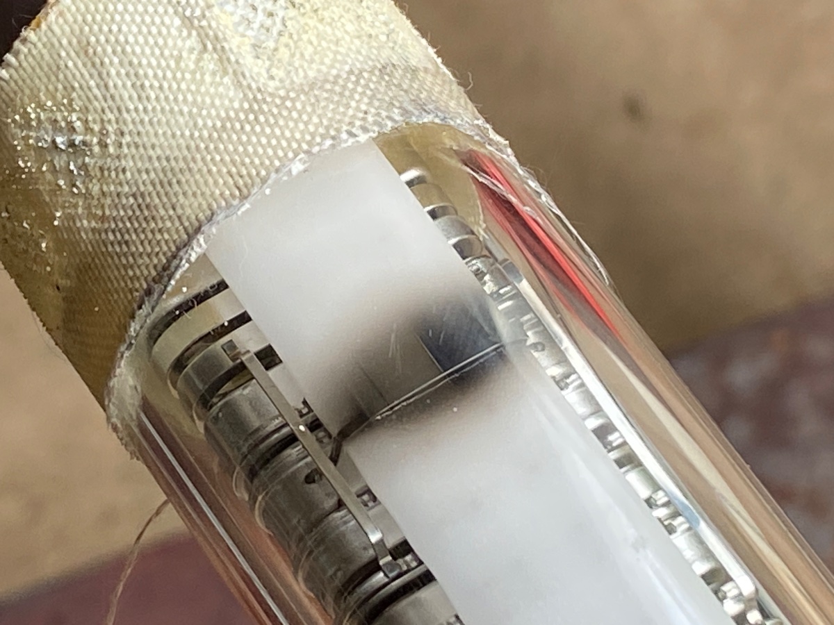

It does not. I've had it happen to three tubes now and all of them have had the necks severed off completely.
Try snapping the neck of some junk tube. Not by hitting it, but by pulling or pushing on it. You need to apply a lot of force to do it. I've imported over a hundred CRT cabs overseas and none of them have had broken tubes on arrival.
Sorry about your friend's PF. It happened to me too (page 2). I'm positive mishandling it wasn't the cause.
