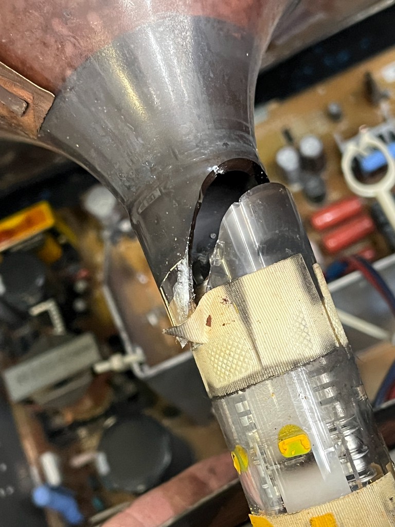

PSA: MS293X, faulty chassis can break the tube

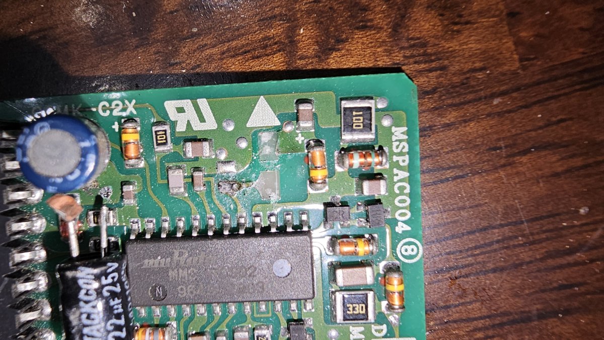

Examining this little board on the 2931 that blew my tube and I see this.....
motherfucker!
Here's my horror story , this one had fireworks coming out of the yoke :)
Also, i did raise the idea of the daughter board with Jomac recently, he said he'd heard this theory before but wasn't convinced. He mentioned with these the Flyback fails, causing the voltage to quickly increase which can neck the tube and also damage all manner of electronics from the lightning zapping everywhere
That looks violent! What Chassis was this? 2931 or 2930?

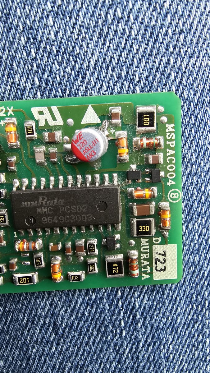

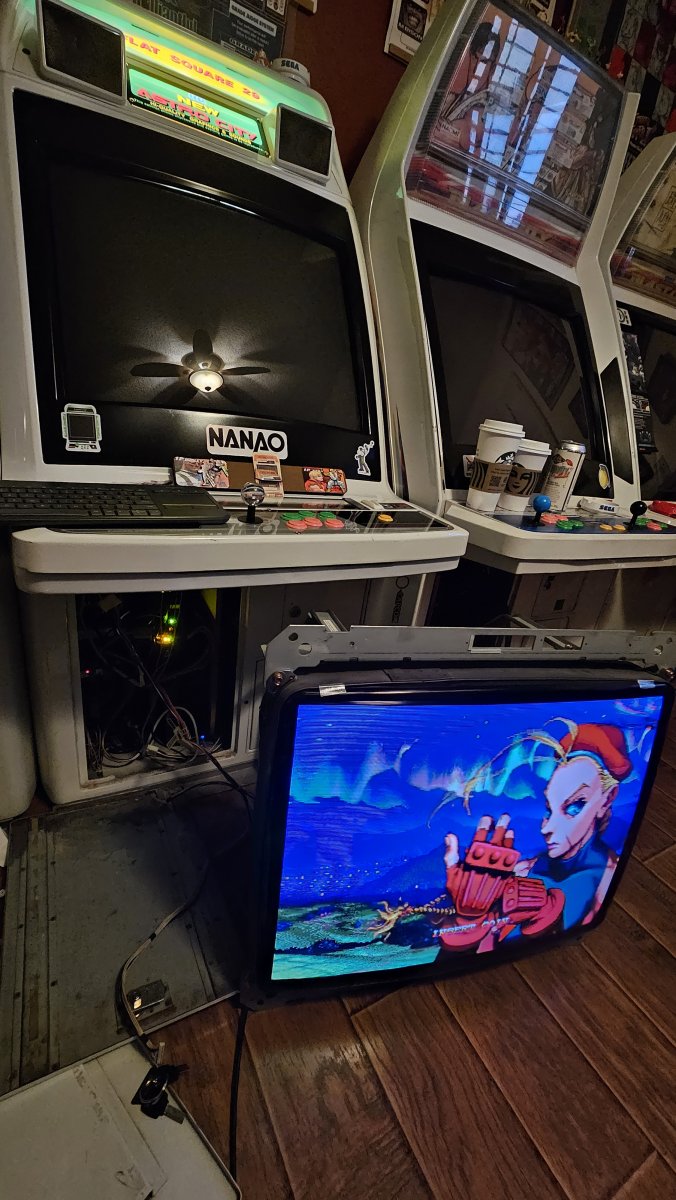

Update on my chassis, I replaced the capacitors that had ripped off the pads with the proper SMD caps. I also sourced a new tube, but have been hesitating for fear it will wreck the new tube. Yesterday on a whim I said f* it and tried it and I was able to get it to work. I didn't stress test it or anything, just confirmed it did not immediately kill the tube and left it on for about 2-3 minutes. I guess it works now, I'll dial in the color adjustments over the weekend and keep my fingers cross the chassis behaves.

Yea, I was pretty nervous. Still am honestly, after it cracked my tube i feel like I'm playing Russian roulette every time i turn on my blast cities
I went over mine and I found a lot, and I mean a lot of bad joints in the power section and on the flyback. Even if yours is still working fine, it might not be a bad idea to inspect it. It took some time but I went over the whole chassis and reworked everything with new solder.
