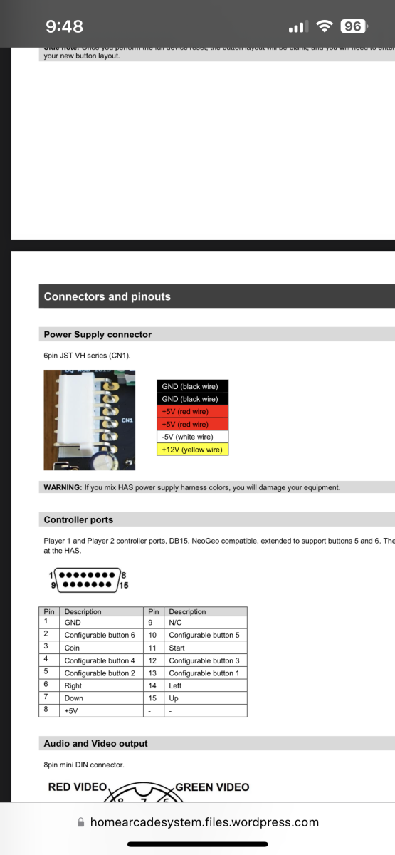

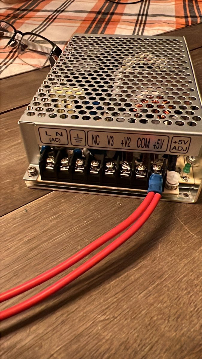

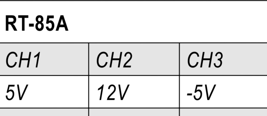

I don’t want to burn anything up lol so I’m asking for help.
I have a HAS Supergun obviously.
And a meanwell RT-85a
Red +5v
White goes to V3
Yellow V2
Ground goes to comm?
Just double checking and second guessing myself.
Thank you
