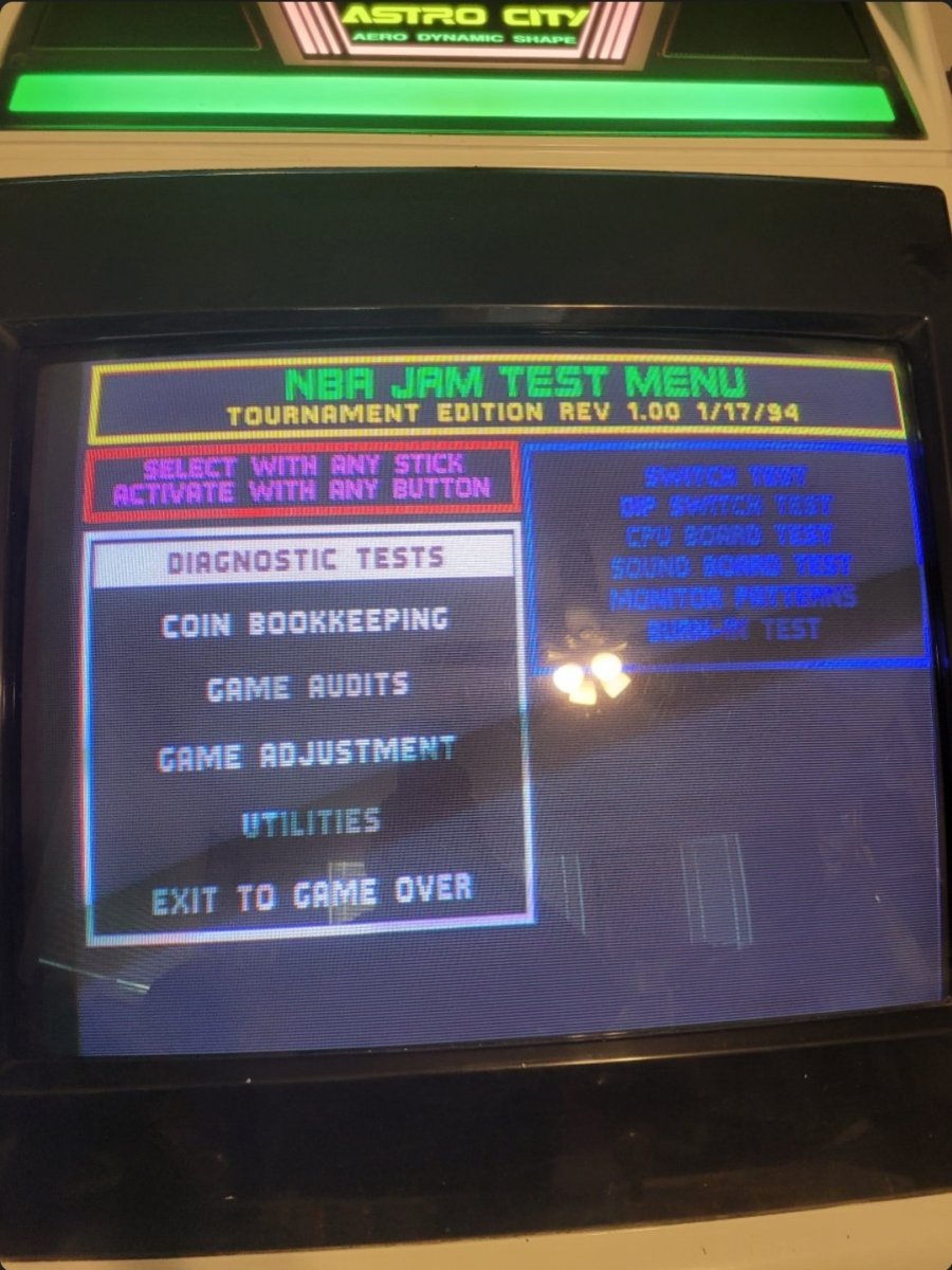

Original roms work fine, only the Rewind ones don't work.
Test mode says I'm running REV 1.00

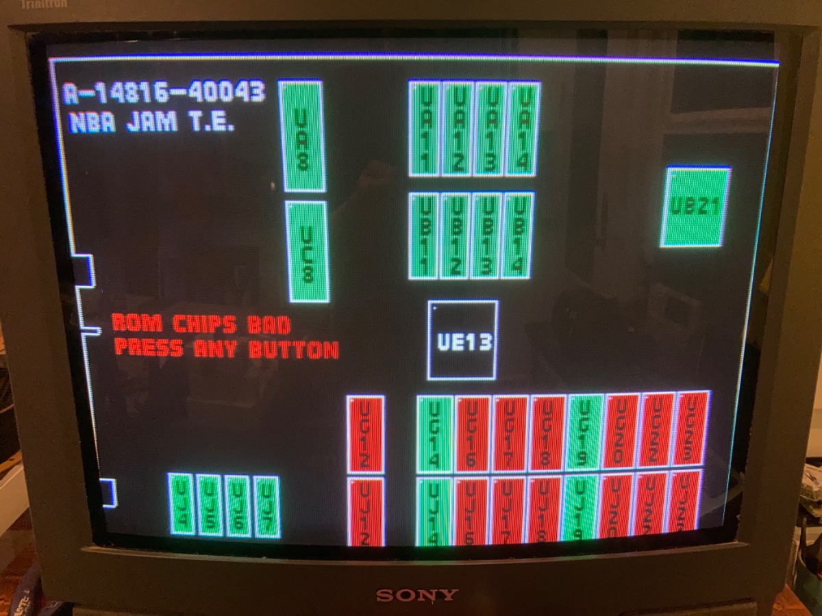

Original JAM (non-TE) PCB, burned all the ROMs except those that are currently green (which I might have misunderstood in the readme.txt file -- it said burn them all, then it says maybe skip those 4). I also only replaced the U12 andn U13 on the soundboard, as I didn't realize the U3 ROM was a different type of EPROM. I also don't have any more of the other EPROM types, as I only ordered 16, and cannot replace the originals that are in green on the diagnostic yet.
The game seems to run just fine, however, with maybe some sounds triggering incorrectly at times, but since I didn't really play this game much, I can't be sure.
Is my problem stemming from needing to replace UJ14/UG14 and UJ19/UG19 with the modified ROMs as well?
Thanks!

From NBA Jam to NBA Jam TE those 4 roms did not change. You can keep the original roms on that board, they will test green.
For NBA Jam TE Rewind, the red roms were changed to add Jordan and Shaq. So that's OK, unless someone fixes that, but it will confuse others.
I did think they fixed it for Rewind, not sure. I didn't make Rewind, just hacked it :)
The sound board rom(s) in the archive are not good, i meant to make a new set but didn't get free time yet. Maybe someone can post a fixed and i'll update that in the first post.
