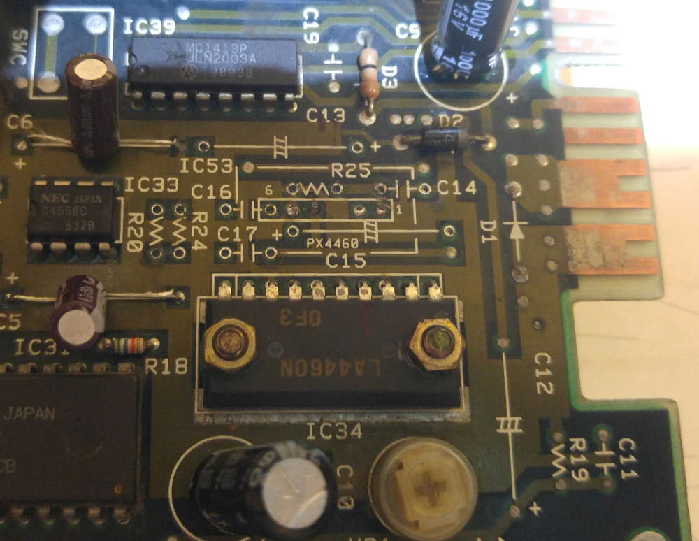

It seems like the board has alternate markings and PCB holes to do the same functions with individual components to replace the support package chip (PX4460). I wonder if that is the case. For example look at the schematic for the audio amp LA4460:
Then look at the PCB:
if you look, c16 c17 are marked for pf cap. then r20/r24 to ground. This follows pin 7 / 9 of the amp schematic.
That covers pins 7 and 9 of the amp, with one pin for ground that leaves 2 pins on the support package for pins 4 and 5. Once I figure out the correct locations for those replacement components I'll probably give this a shot. It seems a lot of repair logs are looking for this support package, so this could be useful for others too.

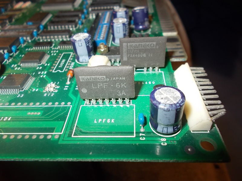

I reproduced both PX4460 (and his "companion" LFP6K), I will receive bare PCBs in next days.
The fist contains part of typical application circuit of the LA4460 amplifier (mostly resistors and capacitors), the latter embeds an OP-AMP for pre-amplificatiom of sound

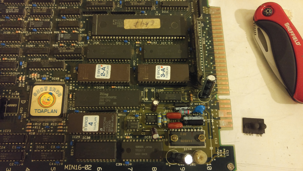

I'm happy to report my snow bros is alive, well, and no longer has any need for the PX4460.
I used a bit overkill for voltage rating on the caps to say the least, but the audio is crisp clean and LOUD.
In case anyone else wants to do this, the above diagram and parts list covers it, and here are pics to piece it together. Hopefully you order appropriately sized (smaller) parts.
Here are all the thru holes to clear (only need to clear left most leg of the old PX4460, or it has alternate pad by marking IC53)
And here's a complete audio section!
