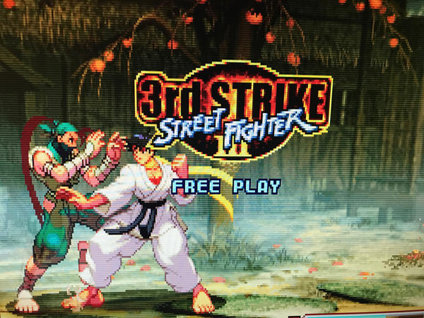

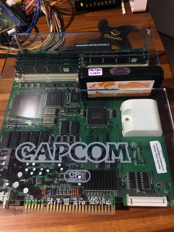

I finally got around to do this update. Got the SCSI2SD board, followed the instructions in this thread and it worked first try. Thanks for all the info posted here!
Also was able to finally install the Jasen Customs plexi, this thing looks great now! I'm glad to put away the cumbersome CD Drive.
Looking good through my OSSC:
