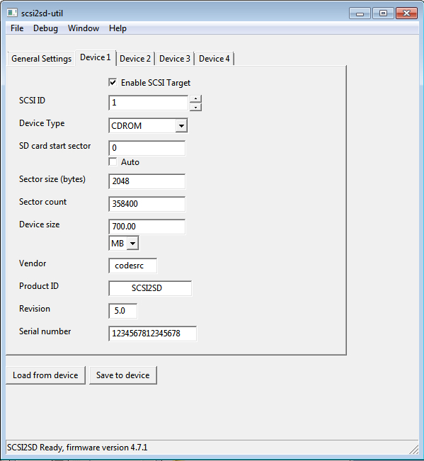

Hello everyone. I'm new here and quite green when it comes to working with SCSI2SD interface revision 5.0. I've been trying to resurrect my Apple Pippin in order to play Super Marathon. Sadly, the CD ROM drive has finally bit the dust and there is no bringing it back. I have everything connected properly to the console itself and have a love flat micro USB cable running from it to my PC. Using unecm.exe, I unpacked the Super Marathon disc image into a .bin file and used the HDD raw copy tool to write it onto a 4GB micro SD card.
After that, I used the SCSI2SD setup utility to load this setup onto my interface. So far I've had no luck with getting the Pippin to recognize the interface as a 4x CD ROM drive. If anyone could offer some pointers I would gladly take the advice.

Maybe have another shot at the disc geometry/layout in SCSI2SD setup until?
Something like 650mb in size, and Google 74 min sector and layout disc information and copy those numbers as well?

Right I thought this too, which is why I suggested checking the disc size (650mb) and setting the sectors to match what a 74min disc would have used (currently his is set for 700mb/80min).
Thanks for the suggestion of changing the amount of sectors on the disc for the drive through the SCSI2SD. It has not worked, but I think you may be on to something with that suggestion. Unfortunately, the only information on the optical drive that I have is that it is a Matsushita brand 4X CD ROM manufactured in 1995.

Wanted to bump this post and confirm that these instructions are 100% spot on. Got it working on my first try.
FYI my board came with firmware 4.7.1 and I didn't need to upgrade. Just confirmed the settings in the quoted posts and prepared the SD card. Very happy with my results and not having to deal with an old CD-ROM moving forward.
I think this post needs to be pinned or should at least be referenced at the beginning of this thread. It was pretty time consuming to sift through the instructions to find something that definitively works - just trying to make life easier for the next people to take on this process.

Everything is working fine when following these steps:
The latest firmware I'm using is 4.7.01
