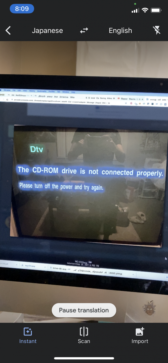

Hi,
I'm having some trouble getting my SCSI2SD working. I keep getting an error message that I don't understand since it's a Japanese region board lol. I tried to auto translate but it made absolutely no sense and basically was just a string of random characters. I attached a picture of it below, my suspicion is that it's an issue with the SCSI2SD itself rather than the SD card image since it gives me the same error whether the SCSI2SD is connected or not, and it gives a different message if I use the standard CD drive without a CD installed. Anyways, I guess I'm a little unsure what the issue is if anyone would be able to help? I'm on a V5.2 board if that matters, and it consistently lights up one LED for a split second before turning off again almost immediately afterwards. I believe I followed the instructions correctly, I updated the firmware, set the SCSI ID to 1, turned Parity on, and I set it to a 700MB CD and then wrote to device, but no matter what it keeps throwing the same error at me. I suppose it's possible it's the wrong image too, I was using a 2nd impact iso to test with before I send my cart off to be upgraded to the superbios but my suspicion was that it'd give me a different error if it were detecting the SCSI2SD device correctly no?
I did see the 5.2 isn't necessarily confirmed working, I saw someone else reference the 5.0 as working so I thought the 5.2 would work too but I suppose I could be wrong, if I did end up getting a non-compatible one I suppose I can buy a new one (though I'll probably just use a CD burner temporarily while I wait for it lol)

I am not sure if 5.2 works, have you tried a different microsd card? A smaller size one, 2gb or less?
From what I remember, the green board ones don't work on blast city psu. the red board ones do. Not sure if that's related to this issue though. Also from what I remember the LED flashes on briefly during startup and then goes out. It then only pulses again on read access? On the blast city when it's not working the LED turns on and stays on.
And yeah, try some different cards. I am pretty sure you should be able to get the same insert a game cd message with no sd card installed? I can double check this if you need, but I would imagine it should be able to recognize the scsi2sd as a drive even if the cd is wrong or empty.

Thanks, that's along the lines of what I figured it said but really wasn't sure, I was trying to use google translate through the camera but it just wasn't working for me. At least now I know it does indeed tell me that the CD drive isn't connected properly rather than it not liking the cd itself which I think supports it being an issue with the adapter rather than the SD card?

Yeah this was my suspicion, it seems like its powering on correctly then (on then off quickly) just never actually reading any data off the SD card. Not sure why that'd be the case though, seems like with how specific this technology is it'd be pretty likely to work as a drop-in replacement?
I'm not using a blast city or anything, though I really couldn't tell you what kind of power supply it uses since its an off the shelf supergun.
I bought the 5.2 thinking it was the right choice since I got cautioned away from the 6.0, then the one from itead I got pointed to would've shipped from Australia and cost significantly more as a result, so I went with the other choice from inertial computing thinking it must be a drop in replacement for a 5.0 since i don't think they sell it any more.
I've got a couple things I might try to see if I can get it working tomorrow before I send my cart off to get the superbios installed, I would think with how most SCSI devices work most of these adapters would work across all devices but maybe I'm mistaken. I'm thinking I might try some different block sizes and tweaking some of the default settings to see if anything helps there, seems like the big thing was making sure it was set to CD mode though which has me concerned I might not be able to get this working since I know for a fact its already set up for that.
Worst case I'm out a few extra bucks and have to order the one from itead I got suggested, just wanna check in with others and see if there are any other suggestions or anyone who has experience with the 5.2 before committing to getting a new adapter.

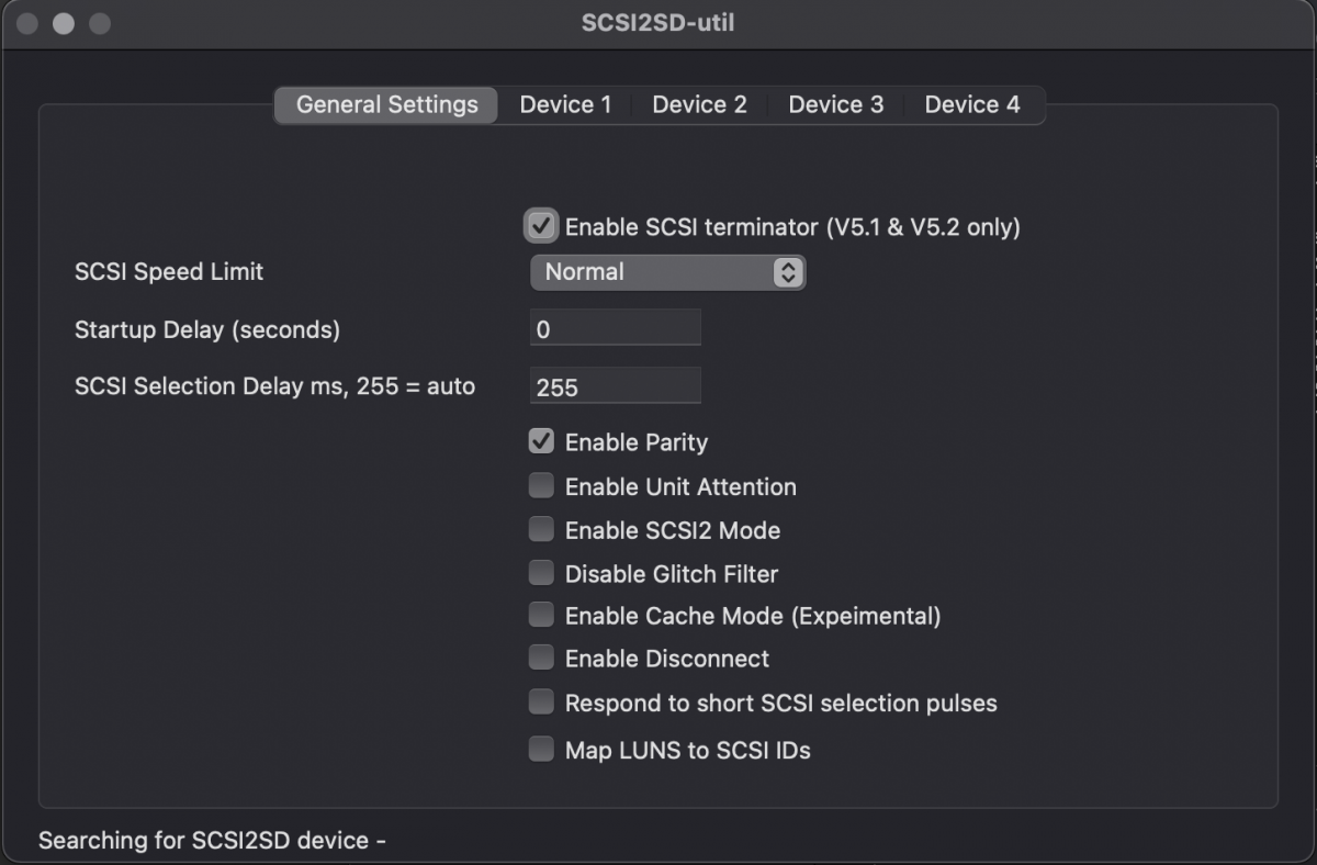

Sorry for spamming three posts in a row with my long-winded responses, but I wanted to let everyone know I got the V5.2 working, so I believe we can say it's supported. There were a couple things I had to do to get it working though:
I had to use the version of SCSI2SD util available here:https://github.com/rabbitholecomputing/SCSI2SD/releases/tag/5.2.10-util for the Mac version, I believe its the same as the versions here: https://www.scsi2sd.com/v5/releases/v5.2.0/ for linux and windows, although it's worth noting I didn't test the Windows version and the Linux version was throwing a missing library error for a library that's been deprecated on ubuntu for years at this point which I found odd since the V6.0 and V5.0 versions of the software seemed to work fine. So if you're using Windows or Linux exclusively I can't make the same guarantee you'll get it working, although I feel like the windows version would probably work fine, I just don't have a windows install to test it with currently.
Anyways make sure you're using the v5.2 util and use that to update the firmware from the cyacd file available here: https://www.scsi2sd.com/v5/releases/v5.2.0/firmware/ If you use the wrong version of the utility it'll probably throw a filename error (at least that's what it was doing for me). Anyways after that you can set it up with the same settings as have been posted here with one exception, make sure that the Enable SCSI Terminator box is checked. I attached screenshots of the settings I used for anyone else who might want to reference them or anything like that. Oh, and some users were mentioning the SCSI ID didn't matter if it was 0 or 1 in some cases, on the V5.2 I can confirm it didn't work with SCSI ID 0 but did with SCSI ID 1, so make sure that's set correctly as well.

Used your screenshots to check the settings, appreciate you uploading those. :)
