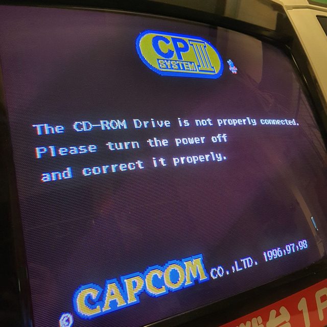

Anybody ever come across this error before?
This was all working properly prior to putting it in storage and then I took out the cps3 to test and this has occurred.

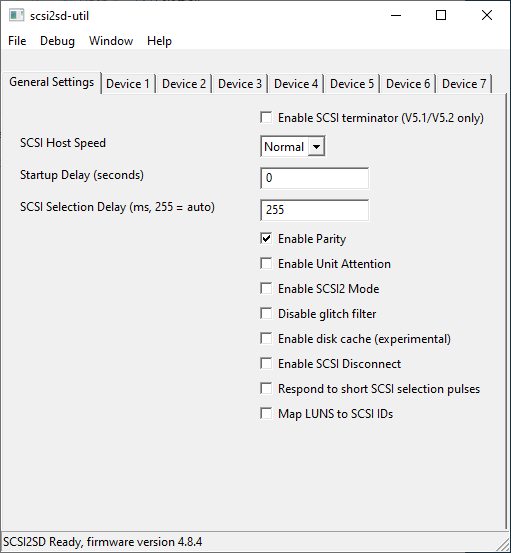

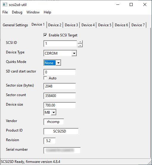

My SCSI2SD card is a 5.0a and these are the settings I've got for the device
I think I've updated it with every setting known to man - "enable scsi terminator", "enable parity - not checked", "SCSI ID 0 and 1" but all yield the same message.

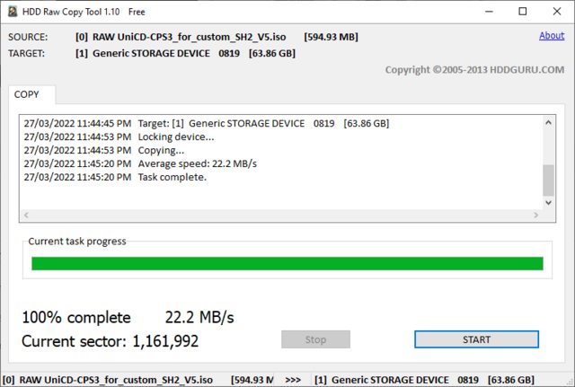

I use HDD Raw to create the image on the micro SD (source = custom sh2 iso, target = micro sd card)

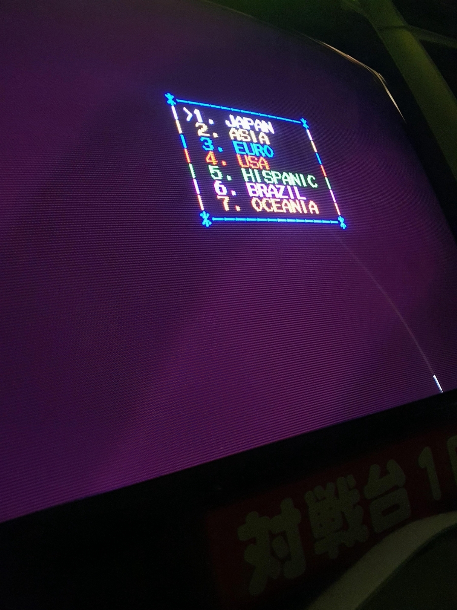

To my surprise, I get the selection screen each time now! Woooo!!
