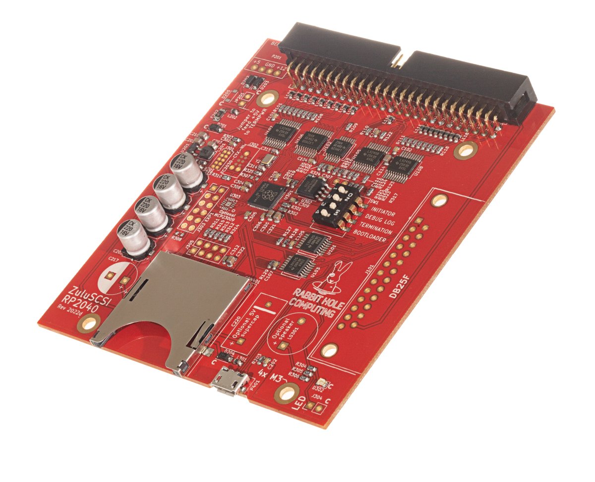

Hi, I own Rabbit Hole Computing, (formerly doing business as Inertial Computing), and we've been manufacturing and selling SCSI2SD V5's for over five years. SCSI2SD V5.0 will likely never be in stock again with ITEAD. The CY8C5267AXI-LP051Cypress/Infineon semiconductor PSoC 5LP microcontroller used in SCSI2SD V4/V5 is unavailable globally, and the manufacturer-suppied lead time is currently eighty weeks, or just over 1.5 years. We spent nearly one calendar year waiting for more of these chips to ship to us, directly from the manufacturer. We developed ZuluSCSI as a logical and spiritual successor to SCSI2SD V5. We knew this day was coming, we stockpiled SCSI2SD V5 parts to the extent that we were financially able to, and when it became clear this was going to be a long term problem, we invested signficant financial resources in development of ZuluSCSI, almost exactly one year ago.
ZuluSCSI can deliver read speeds ~4x that of SCSI2SD V4/V5 (same chip), and it's overall a lot easier to use.
You can buy a fully assembled and tested ZuluSCSI RP2040 for $59 today. We're based in the US.
If anyone here would be willing to part with a bare CPS3 board for a reasonable sum, please send us a PM.
