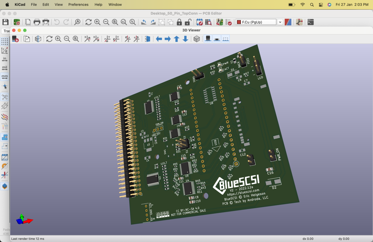

BlueSCSI-v2 has just been released - it's a bit bigger than the v1, uses a Raspberry Pi Pico (instead of bluepill), and all SMD components.
Announcement here
https://bluescsi.com/v2
GitHub here
https://github.com/BlueSCSI/BlueSCSI-v2
Firmware is a fork of ZuluSCSI (moving from STM to Pi) so in theory anything ZuluSCSI supports so should BlueSCSI2 but of course nothing has been tested yet.
