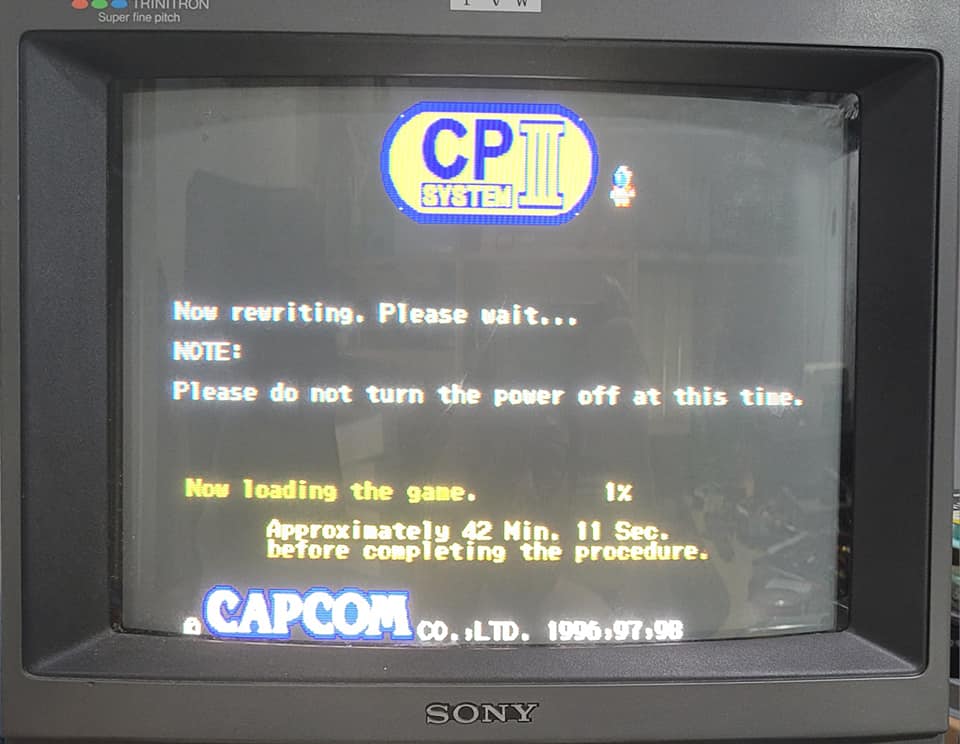

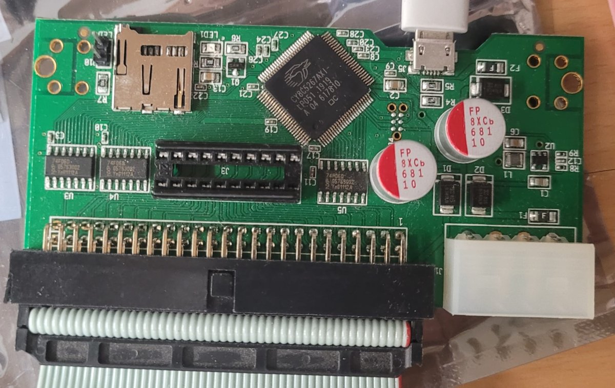

I used SCSI2SD ver 5.0a It always halted after I select region than when I turn off and on
It always re-write game I don't know what going on

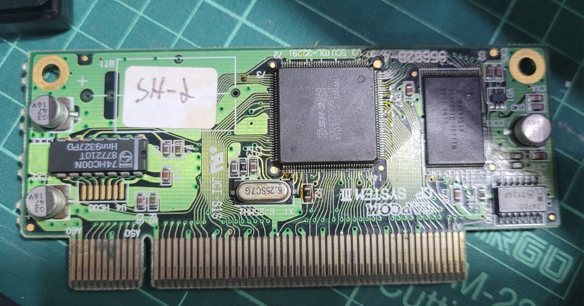

You need to confirm which SH-2 you have in your cartridge. Do you know if it has a standard SH-2, or a custom SH-2? This is what determines which disc image you should be using.

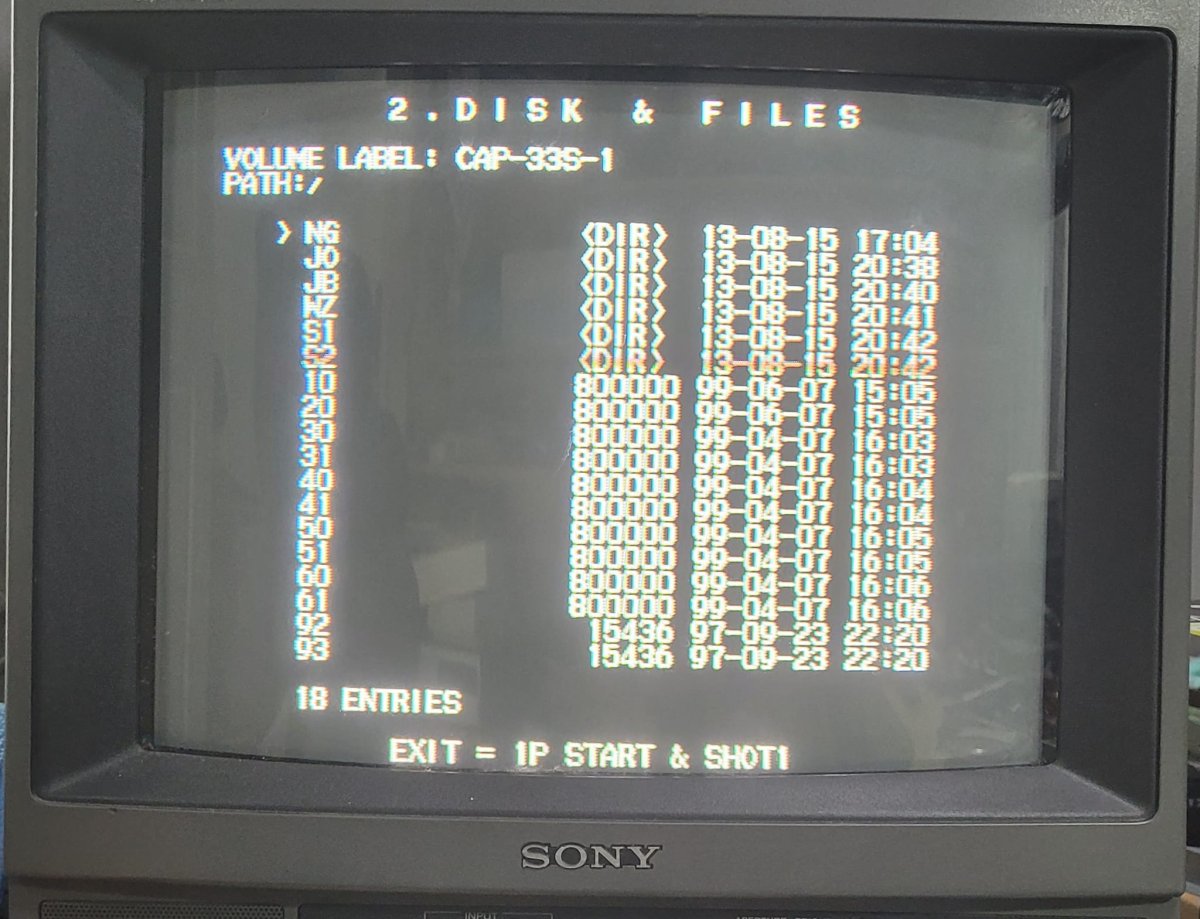

This is my SETUP before CPS3 System, It always halted so many Time
I got CPS3 MultiBIOS SH-2

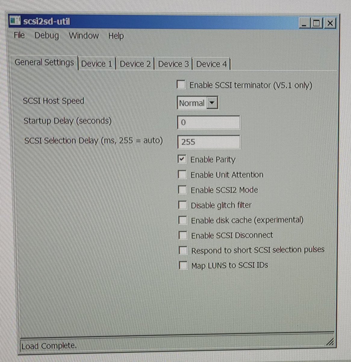

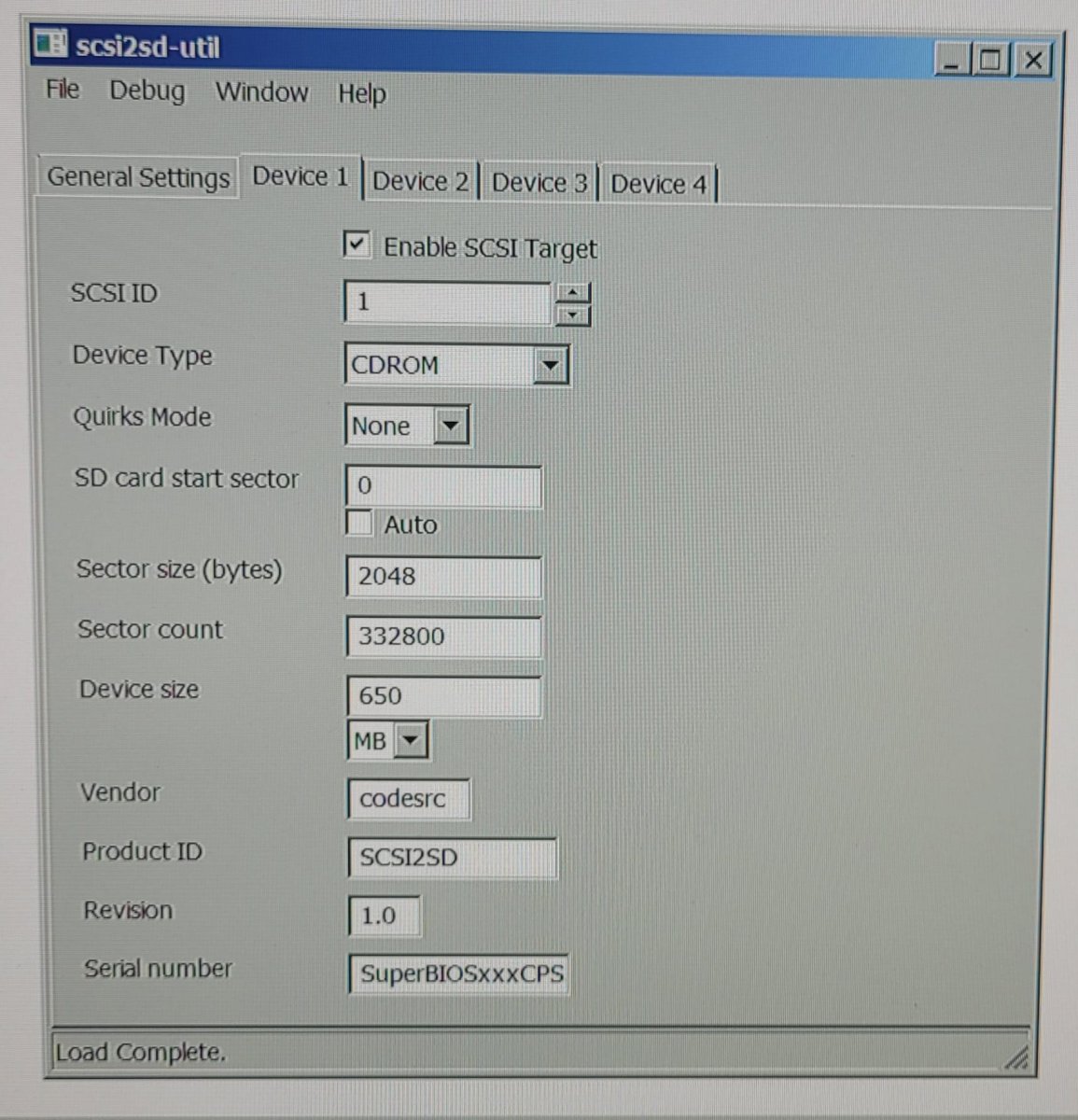

I use SCSI2SD ver 5.0a with Firmware v4.8.04 and micro SD-CARD 2 GB
I setup config as shown in picture for Device Size 700Mb and 650Mb got the same problem, I try so many time

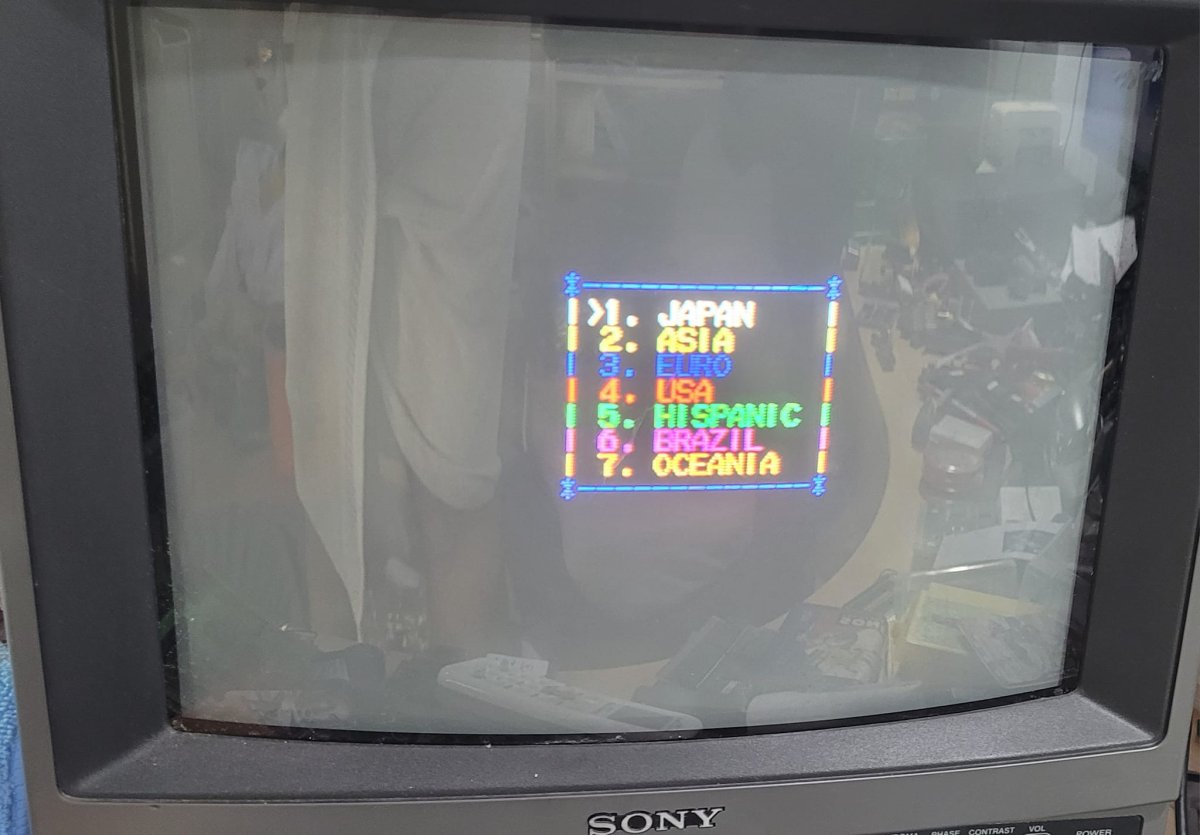

When CPS3 Finished , System shown Region selection menu , When I select them it Always halted I try more than 50 times, Please help me
