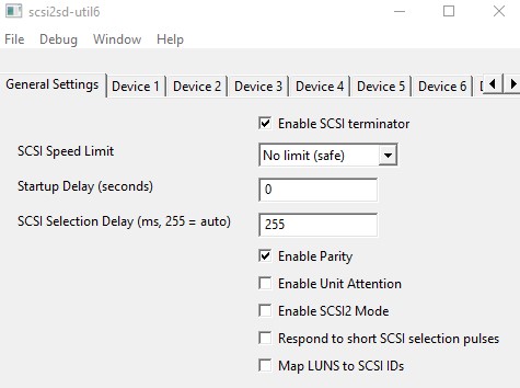

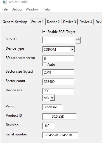

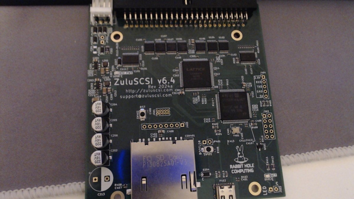

I've also gotten a ZuluSCSI but am having troubles getting the CPS3 board to recognize any ISO I have on there. I've attached all the info that might be useful. Any pointers on where to go would be much appreciated!

I'm a bot confused. Zuluacsi and scsi2ad are two completely different products. Why are you showing scsi2sd setup utility pics?
For some reason the scsi2sd utility can read from the device while the zuluSCSI couldn't. Either way, I used it to show the settings that were on the board.

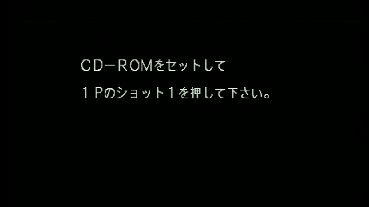

Renamed the ISO that was on the root of the SD. Booted up the board with the Zulu and got this:
(If I press Shot 1 like the Japanese message says, it attempts to read but stops instantly.)

I can't tell. Does your Zulu have term power enabled? Or are you powering it externally?
